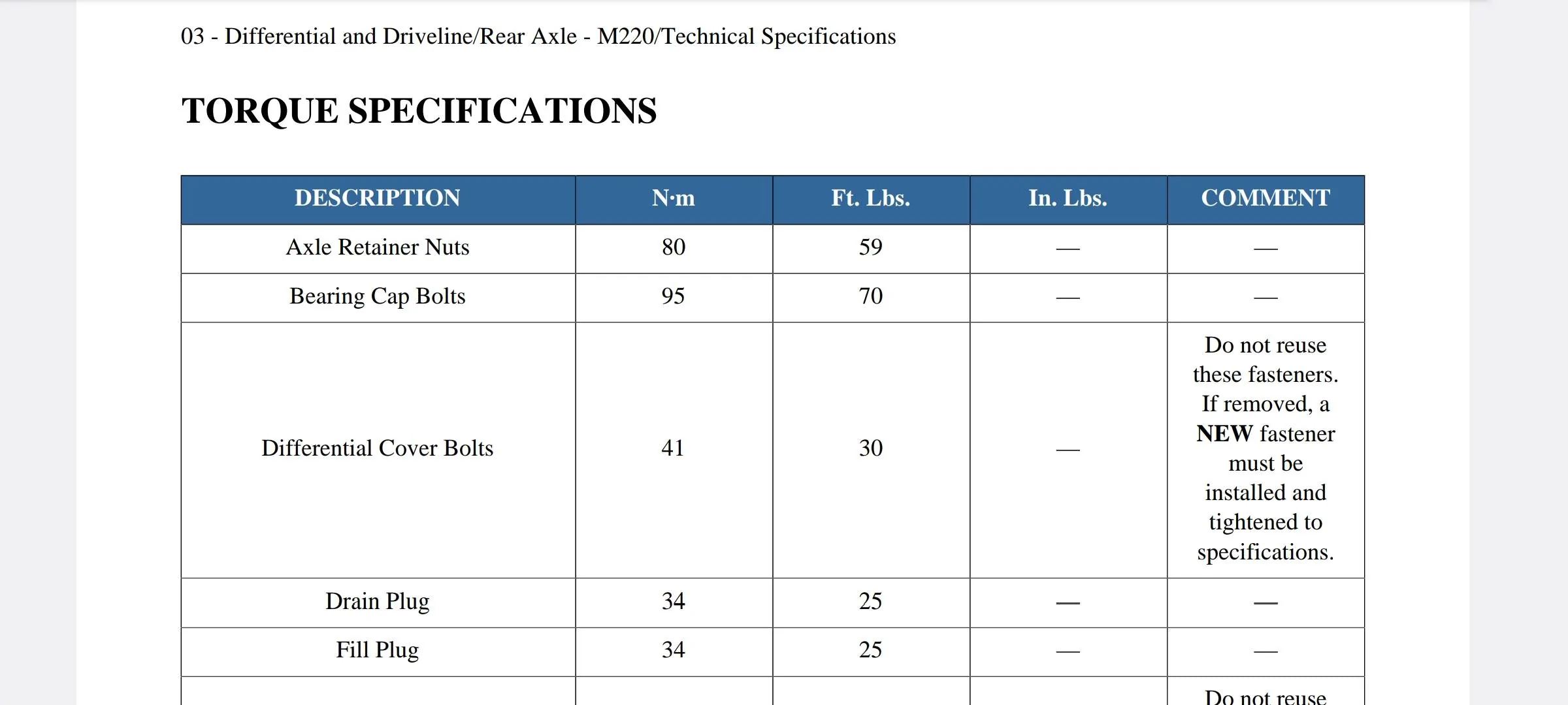

I thought I read here that the diff cover bolts were a one time use bolt. Seems strange if so to replace them when changing the fluid.
They are one time use bolts if you expect to torque to spec of 30 ft-lbs. Like @ShadowsPapa mentioned, they are torque to yield and stretch.
That being said, if you back the torque off to 25 ft-lbs, you can probably reuse them. Reusing them and going to 30 ft-lbs and you have about a 50/50 chance of snapping the head off.
Jeep Gladiator Need to change diff fluid Screenshot_20230613_114517_Driv

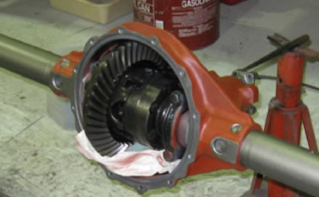

Question -
I've not had my own differential covers off as of yet. That will be in the future. So I've not personally seen the cover seal these use. Are they at all like used in the AMC 20 (which Dana bought the rights to) where it's square cut o-ring in a channel in the housing?
Here's a 20 I worked on years ago, you can see where the square-cut o-ring fits just inside the bolts. It allowed you to torque the bolts down and not distort a paper/fiber/cork gasket at all. These almost never leaked.
Jeep Gladiator Need to change diff fluid javelin-differential-16
Jeep Gladiator Need to change diff fluid 1686676870002
legacy_etu
Brian
May 19, 2021
1,460
1,831
New England, USA
The fact that the cover is not very thick means there's little bolt shank to stretch and warn you by "feel".
Question -
Yeah, I love that design. No worries about crushing the seal with that.

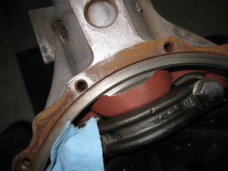

My rule is always loosen the fill plug first (diff, tranny, xfer case, etc.). If for some reason it doesn't come loose or you strip the plug, it makes it difficult to refill later on.
This guy found a way to refill when the plug wouldn't come out..
Jeep Gladiator Need to change diff fluid 1686692214114
