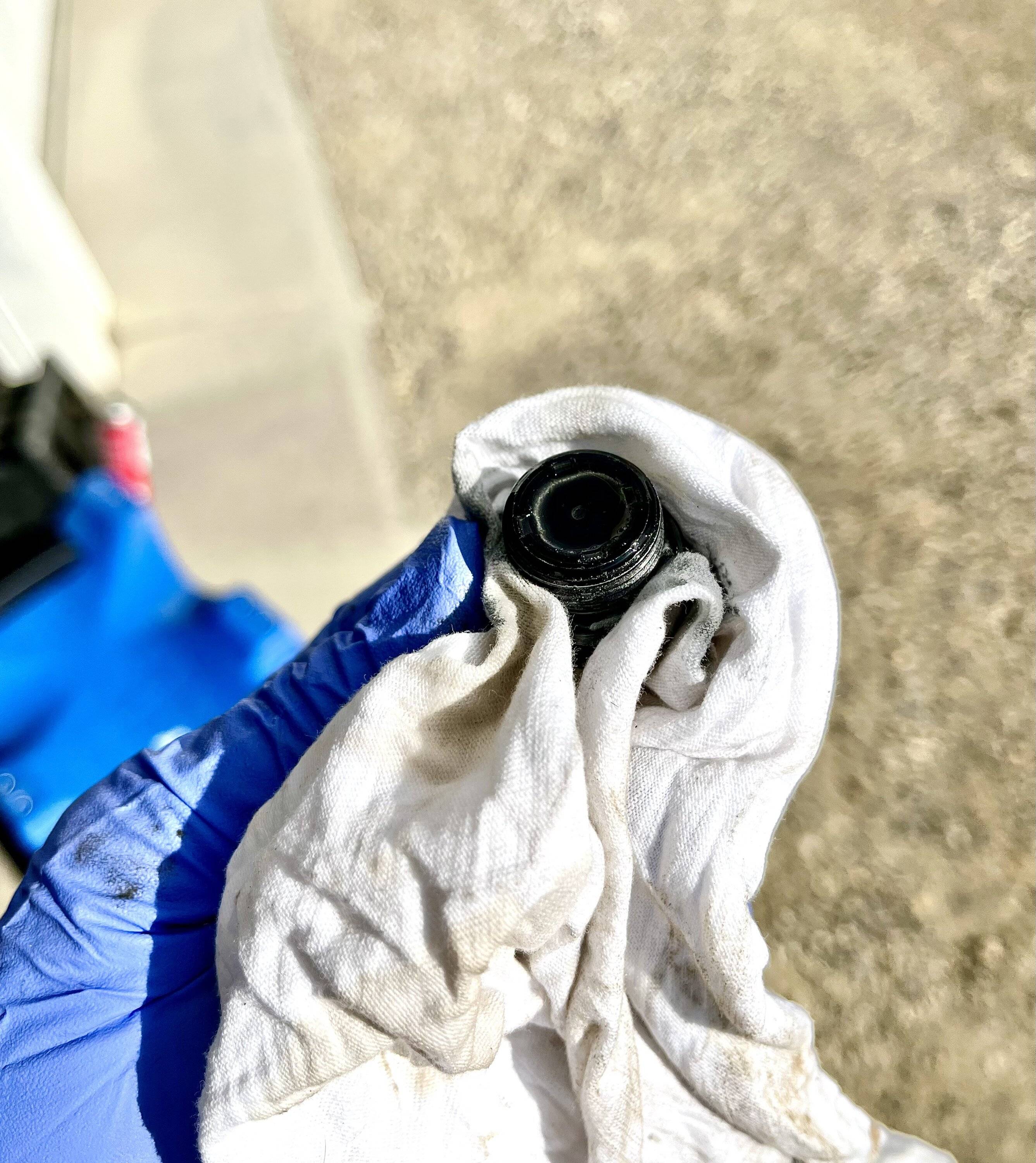

I changed t
Please let us know if you see a lot of metal glitter in the 17,000 mile diff oil when it comes out.
i did the change today on both diffs starting with the rear that had the LS fluid in it when the diff didn’t call for it and I was extremely impressed with how clean the oil looked coming out. The magnet had next to nothing on it and I’m running the oil sample to the lab tomorrow.
I filled it with non LS 75/90 this time and we’ll check again in another 30k kms. I took a photo of the front diff drain plug magnet which also had next to nothing on it too. The rear magnet looked just like the front.
Jeep Gladiator Front and Rear Diff Fluid IMG_1699

Be glad! Mine had a mound of filings on the magnet and tons of glitter in the fluid, and failed soon after. Around 20,000 miles.
