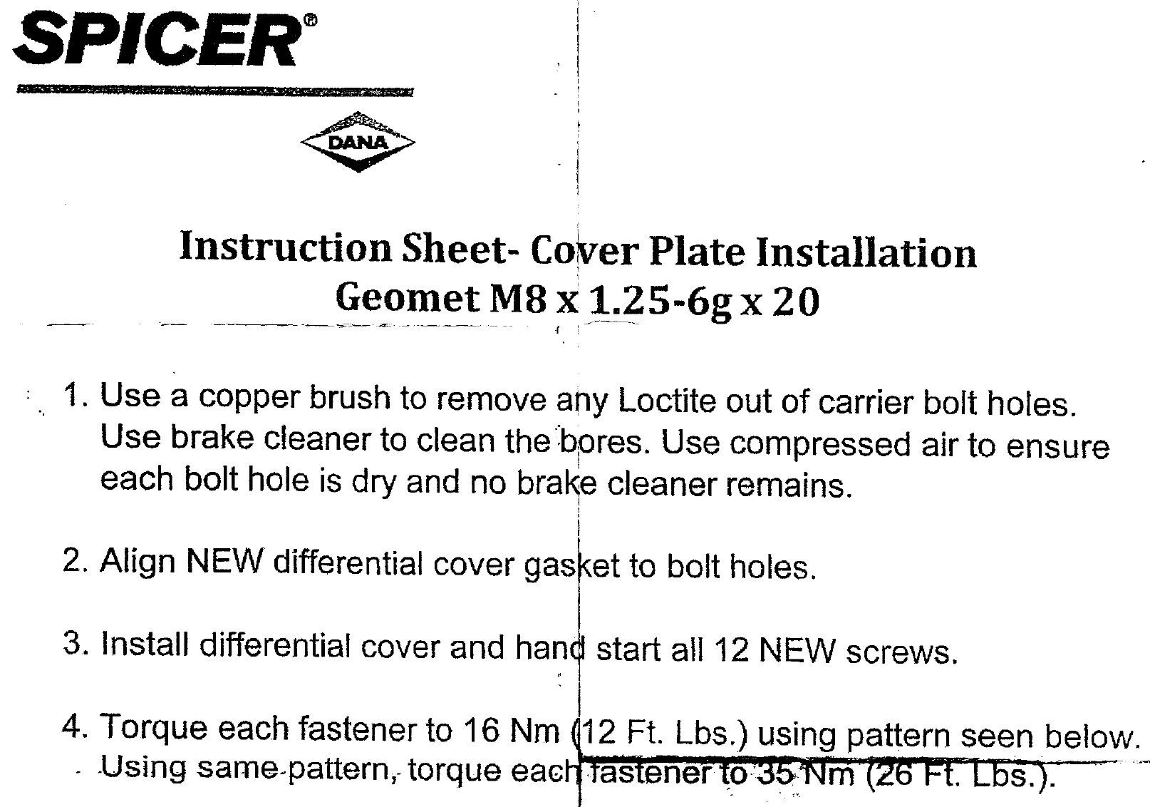

The instructions that come with the mopar replacement diff cover bolts that have the pre-applied thread sealant:

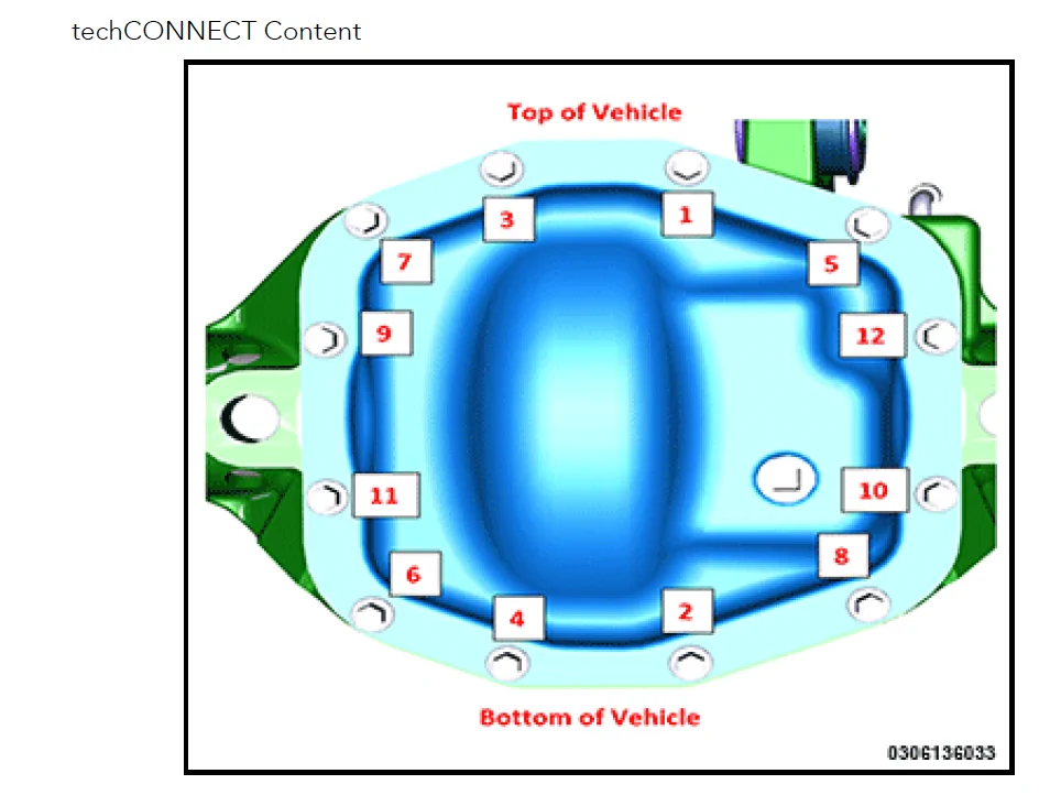

The recommended pattern to use when torqueing the cover bolts:
Jeep Gladiator Front/Rear Diff Service - DIY Screenshot 2026-04-09 at 5.09.54 AM

Interesting. The instructions above show both NEW cover gasket and NEW cover bolts. I want to do this the right way, but I'm also wondering if all of that is really needed since every tutorial I've seen to have watched shows them re-using both.
You find it interesting that a company that sells replacement parts would encourage you to buy more replacement parts from them? ;) Which is why I wrote that I have reused the gaskets multiple times. They are some sort of rubber with a metal core. Treat them gently, you don't want to nick or cut the little ribs that are on the surface.
Now for the bolts, the pre-applied thread sealant / thread locker may make a difference to you. Some of the bolt holes in the housing are open on the back side, exposed to water, road salt in the winter if you drive in such places.
That torque spec is for clean bolt holes with new bolts with the pre-applied thread sealant.
Here is the post where I snapped off one of the bolt heads when I was installing the Dana iron diff covers: https://www.jeepgladiatorforum.com/...ng-no-politics-no-gun-talk.23705/post-1562565
The bolts that came with the diff covers were crap. I haven't had any issues with the Mopar bolts or the Spicer ones. The Spicer ones seem like they have an even larger flange than the Mopar ones.
That 35 Nm is a lot of torque for a M8 class 10.9 bolt. The issue I had when considering re-using the old bolts was what to torque them to?

The dealer who I have free oil changes for life quoted me aroudn $900 to do front/rear/trans service - but after watching a few online Youtube videos - it looks pretty straight forward, and something I can do on my garage floor.
My only concerns and questons are;
1. Since my 22 JT does NOT have a drain plug - I assume I would need to remove the fill hole plug first, and then loosen the top two diff cover bolts, and remove the rest for the oil to drain out?
2. The dif cover should have a gasket - I would assume this is reusable?
2a. Should I invest in a different cover if I plan on DIYing this down the line?
3. The diff cover - can it be cleaned out with parts cleaner? How about the actual differential/teeth area?
4. What is the gold standard/recommended oil to use for a vehicle that doesn't rock crawl, and does some minor light trailer hauling for the front/rear?
5. Should I use YELLOW teflon tape around the fill plug?
6. Does anyone have the torque specs for the bolts?
I've read folks can do this easily at home, and spend about $100 vs $900 from the stealership. I just want to verify everything before I jump in.
Thanks!
-Brent
Are you sure you don’t have a Drain plug on lower front side? Mine is there on my 2020 JT REAR DIFF
