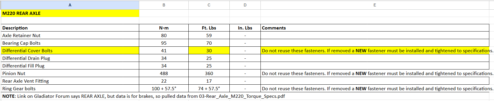

  • According to the torque values spreadsheet, Jeep states that the torque for the rear differential cover bolts is 30 ft-lbs (also see first attachment below).
  • Spicer (the axle manufacturer) states that the torque for the [rear] differential cover bolts is 26 ft-lbs. The initial torque, or what I call "torque round 1", and the bolt tightening sequence are shown in the same post.
  • According to the torque values spreadsheet, Jeep states that the rear differential cover bolts should not be reused (also see first attachment below).
    • In the same spreadsheet, there is nothing said about reusing the front differential cover bolts.

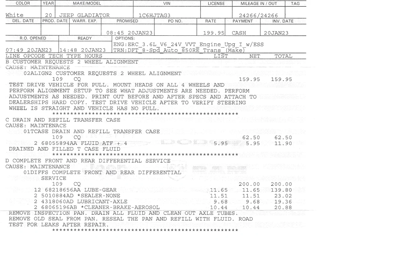

  • It appears that my selling dealer reused the bolts (no bolts listed, under group D, on invoice below). An independent shop also reused the bolts at a later date (invoice not shown).
    • Also see description of MOPAR part number 68218656AA (gear & axle lubricant, confirmed) below

Torques from Torque Values Spreadsheet on This Forum
Jeep Gladiator Front/Rear Diff Service - DIY 1775904845354-ra
Invoice from My Selling Dealer
Front & Rear Differentials (Group D), Transfer Case (Group C), and Wheel Alignment (Group B)
