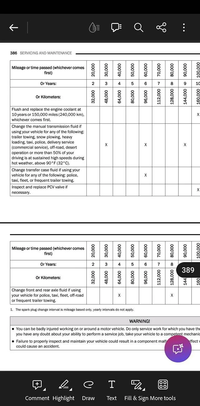

I've a 2021 Overland (3.6 gasser). I've taken it on a newbie run one time, in the spring of 2022. There were some seriously deep water sections (there were high level water marks in the bed at the back). I had the diff fluid changed at 37,000 km (23,000 mi), and now it's in for a "peace of mind" service at 80,000 km (50,000 mi) and the dealership says "time and mileage" to change the fluid again. The owner's manual is with the truck at the shop, so I can't check that. Just wondering if the dealership is maybe being a bit aggressive with the suggestion? I really can't complain about these guys, they've been outstanding dealing with warranty issues (rust, paint, leaking window, etc.). Just looking to see if it's on the up and up.

The Owners Manual is available on line as well.
They are certainly being 'aggressive' compared to the Owners Manual recommended service intervals. However, IMO, you are better off with early and often diff fluid changes on these axles, especially the rear.
And it is always cheap insurance to change the diff fluid after deep water crossings (or at a minimum inspect the oil for any signs of contamination).

They are being aggressive, but I don’t think it’s a bad thing in this situation.
