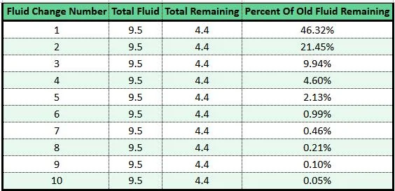

Interesting... have you figured out at which fluid change number the "new" fluid you are putting in your transmission becomes the new "percent of old fluid remaining"? Or is this a new variant of Zeno's Paradox?;)
GoHack
