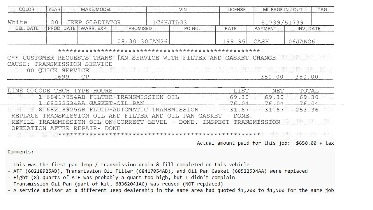

When the time comes to change the ATF fluid in my '24 JTR or even now in my '16 JKU (49k miles on it), after reading all the things, steps, cautions, etc. on the threads here, I wish I could find a reliable company (or mechanic) that could do it for me (I'm in South Florida, Miami/Keys area). I'm more of a plug-and-play guy and when the stuff gets too many steps involved, I will defer to someone who knows what they are doing. Installing my winch was about as far as I want to go. Which makes me question who at a dealership even knows what they are doing. Are they following the ZF steps as listed?
Any recommendations for this stuff in South Florida?
I can't comment on the Miami area, but I recently had a pan drop done by my selling dealer. My vehicle was already in for a different repair and the price for a pan drop was not insanely high, so I pulled the trigger and got it done. The details are shown on the attached invoice.
After having had some other work done by a couple of local independents over the last few years, I chose my selling dealer for this job because their techs are qualified, the independents couldn't beat the price, and the warranty provides peace of mind in case of a leak or mechanical issue.
As long as there are no leaks, the transmission shifts more smoothly, and the ATF level is good, I figure that the job has been done right. To check the level yourself, see ATF LEVEL CHECK procedure in SECTION 12 of Pan Drop Instructions.
Tip: Insist that the tech doing the work use a torque wrench for all fasteners, including the fill plug (26 ft-lbs). This should ensure that you are able to remove the fill plug later, to do a level check, without using a breaker bar.
Jeep Gladiator Transmission drain and fill at 60K 00063 & 00064 - transmission drain & fill (pan drop) - 2026-01-06
As long as there are no leaks, the transmission shifts more smoothly, and the ATF level is good (see SECTION 12 - ATF LEVEL CHECK, in this post, to check it yourself), I figure that the job has been done right.
You make a good point about the warranty, something that would typically be more limited if at all by many independents. At least with the dealer you do have some recourse if anything goes wrong.
Finding anyone who can do something right today is totally amazing, shocking, even. And yes, if a dealer does it, at least you have warranty. These quicky places and some independents scare me.
