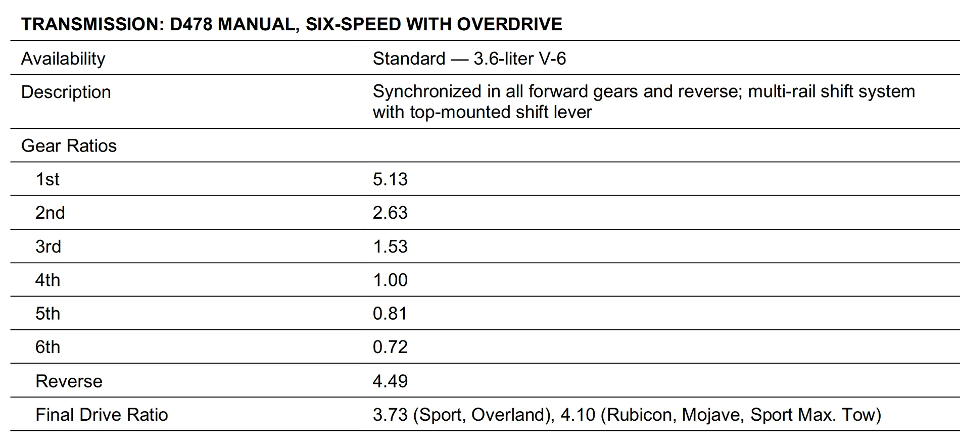

I know this is an old thread but this has not been my experience. I'm 7,000 miles into a 2024 Manual Transmission Rubicon with the 4.10 gearing and as much as I love my truck, 6th gear is unusable. Today in 6th gear it couldn't maintain 75MPH on a flat stretch of highway. I can't maintain 70MPH in 5th gear with even 1 degree of uphill grade. My truck struggles to accelerate at anything under 2200 RPM. It's effecitvely a 4 speed Manual because in the PNW there are so few perfectly flat roads that would ever allow me to coast in 5th gear.
Without getting into the weeds on tire sizes, driving habits, geography, etc........it's worth mentioning that our manuals ARE essentially a 4 speed.......with two overdrive gears.
