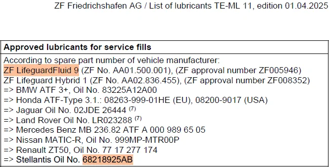

MOPAR 8 & 9 Speed ATF (68218925AB) is an exact equivalent to ZF LifeguardFluid 9 (not the other way around). ZF is the licensor. I have read that Shell manufactures MOPAR 68218925AB. I am not a ZF, Stellantis, or Shell insider, but it is evident that the formula and the manufacturing process are very strictly managed. A limited number of vehicle OEM ATF brands, shown in the table below, are associated with the ZF approval number for ZF LifeguardFluid 9.
In contrast, ZF LifeguardFluid 8 is not an exact equivalent, but it is the original ZF-approved and ZF-branded lubricant for the ZF 8HP50 / Chrysler 850RE automatic transmission.
From the perspective of ZF and Jeep, no aftermarket brand is considered an "equivalent". However, as you have pointed out in another post, the ZF, Dex VI, and Toyota WS standards are close cousins. At least five aftermarket manufacturers claim that their ATF can be used in the place of MOPAR 68218925AB.
MOPAR is manufactured in the United States, and ZF is manufactured in Germany. While it is true that not all oil comes from the same field or depot, the variations can be (and are) resolved during the manufacturing process.
The best way to settle this is to test MOPAR and ZF, but I'll leave the testing to someone else.
Key takeaway: The ATF part numbers shown in the following table meet the definition of the words "or equivalent" printed in the owner's manual (see doc #7 in ATF Equivalents)
- ZF LifeguardFluid 8 is a gray area
See doc #1 in ATF Equivalents. Here is the key part:
