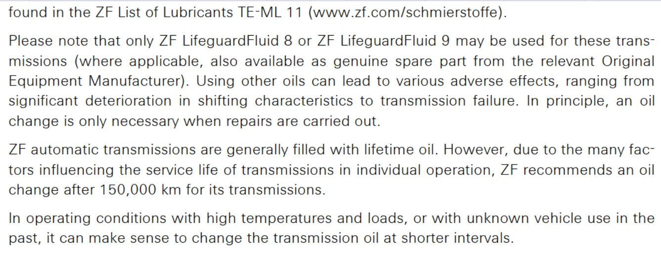

Some of that discussion is wrong. ZF has said it doesn't need maintenance under normal circumstances.
I've got the ZF document.
FCA is following ZF's own recommendations! So it's not being lazy or trying to show they are cheaper to maintain and so on. It's not about "making it last long enough to need a new one".
Here's the quote from ZF about these very transmissions -
Jeep Gladiator Anyone else use this ATF in their Gladiator 8-speed? 1756769895697-f
And this is what any manufacturer would tell you - again, this is a quote from ZF -
Jeep Gladiator Anyone else use this ATF in their Gladiator 8-speed? ZF fluid recommendation
So no, it's not like people are claiming trying to support or justify their own "Jeep is full of shit, I'm doing it right at every 40K!!".
It's lifetime - however, "YMMV" applies - tow a whole lot, get it hot, abuse it in the rocks - change it sooner. DUH.
Most of the arguments, even here, are just not right.

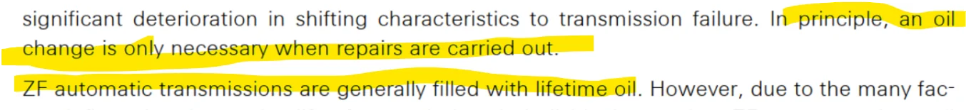

From Jeep -
Jeep Gladiator Anyone else use this ATF in their Gladiator 8-speed? 1756777701951-h1
Note the words - "Under normal operating conditions"...............
I've done more transmission work than anyone here, no way I'm going any less than perhaps 70,000 miles. Might go lower due to the abuse of snow plowing. But even my trailer towing doesn't see the transmission temperatures very high. Heat is what messes up the fluid.
That's always been the rule.
You can do whatever you want - it's your truck/Jeep, but unless you get it hot or in situations with extreme loads, constant shifting and so on - it will last.

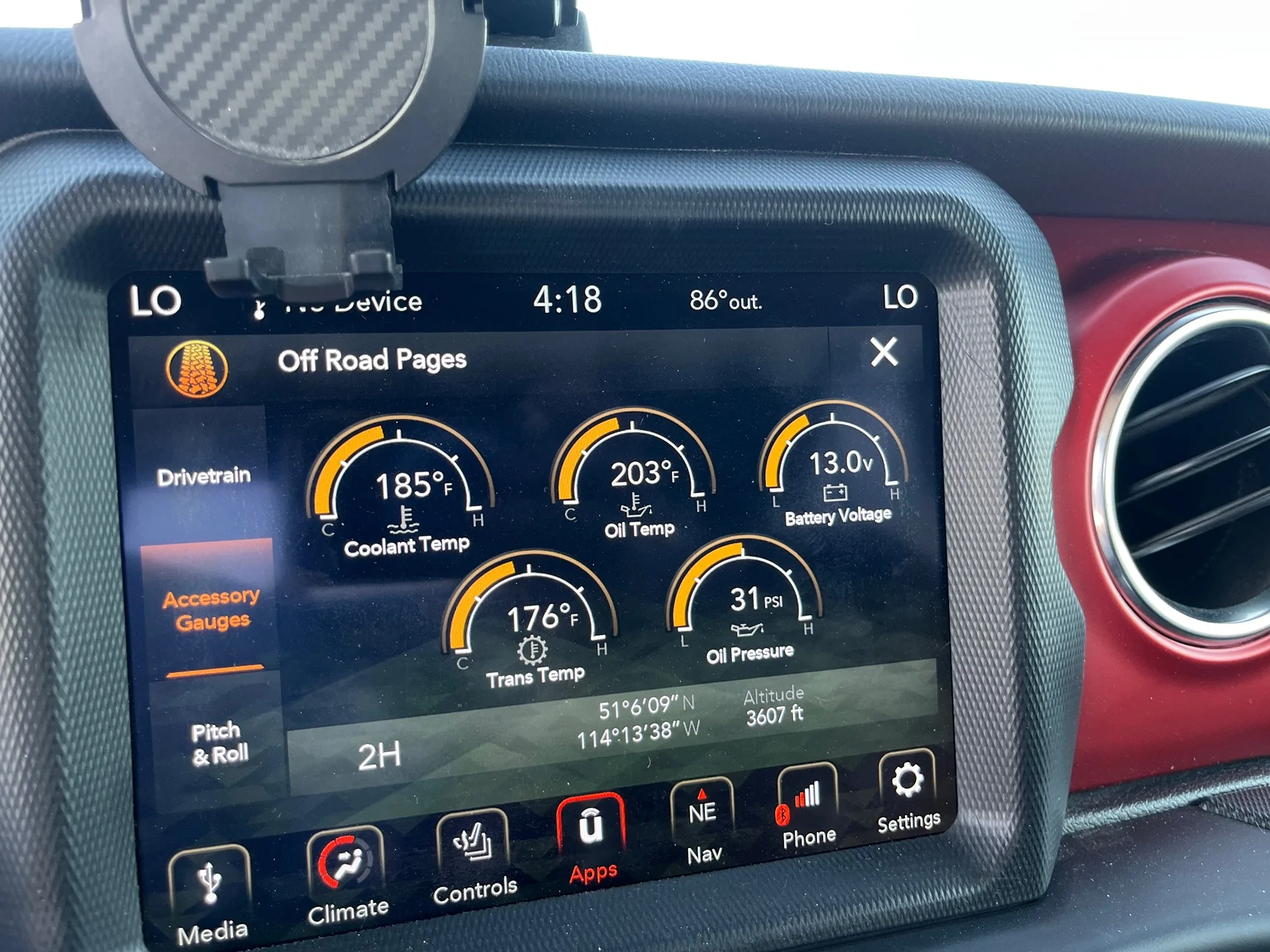

Well you can add my intervals being…. Once a year (approximately 30k kms) at about May, before our hot ambient temps kick in. Transmission has never seen temps 190+. Just because it can or the oil flash points are probably double + that, why would I want to see it or even push it there? Why?
Lab numbers look great. Lab can’t even get an oxidation number in order to obtain a “synthetic spike” in order to confirm if the Mopar 8/9 speed ATF is a synthetic or semi-synthetic oil. I could fix that by putting on more milage…a LOT more milage, but then there’s the “lifetime” guys, you know, the ones that trade in their vehicles just before warranty is up,…they have their own ‘badge of ignore it” milage numbers to have a lab test oxidation numbers and from that, lab can determine full or semi-synthetic type.
To quote a great question often asked by @ShadowsPapa, “why?”…. Why would I want to see oxidation numbers? Why would I want to see high temps because the oil can do it or transmission can go much higher? Why?
Why is maintaining a higher level of “clean, non oxidized” oil so much worse than a transmission that’s “learned” to function with debris saturated, never touched oil in 60k miles +?
Why are those who take a higher level of care (pan drops 50k or less) painted with a brush that’s demeaning or that we are wallowing in our own “fear mongering” ideas?
Why is early maintenance frowned upon by the “lifetime” guys and yet these guys jump ship when warranty is up but then hang their hat on their ability to have done absolutely nothing to help advance the health of that component?
So, there’s two camps here.
1. Don’t touch it, transmission will “learn” how to operate with oil that’s not touched in 60k+ miles. Oil full of debris from day one which includes so hot temps and maybe some aspects of being burnt a few times, oxidation numbers can be measured, wear and tear and just keeps compounding etc…(fact, not fear) and;
2. Keep it clean, transmission will “learn” how to operate with clean oil, additives are always at their peak saturation, doing what they’re formulated to do.
Jeep Gladiator Anyone else use this ATF in their Gladiator 8-speed? IMG_5016
