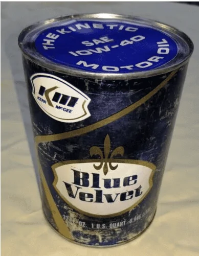

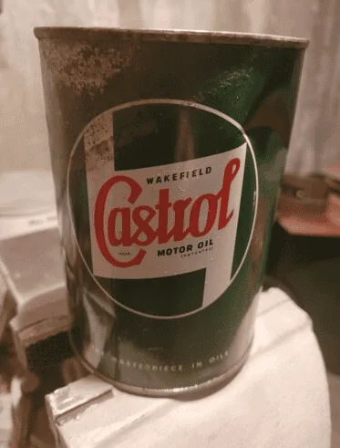

These aren't 1960s oils. Not unless you shop eBay for your oil.............
