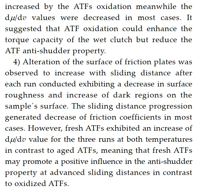

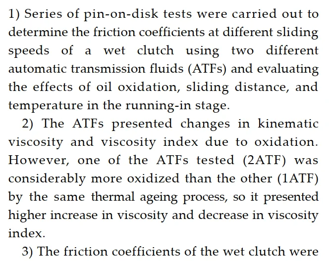

One reason to not get 100% hung up on some numbers is some scientific testing I've read about where - aged fluid if not take to extremes, can actually help the friction disks grab, and be better at some things vs. new - and there was a huge difference in the two fluids used in this test (called only by 1 and 2, no brands)
There were hints that artificially oxidizing the fluids in a lab actually helped certain performance aspects.

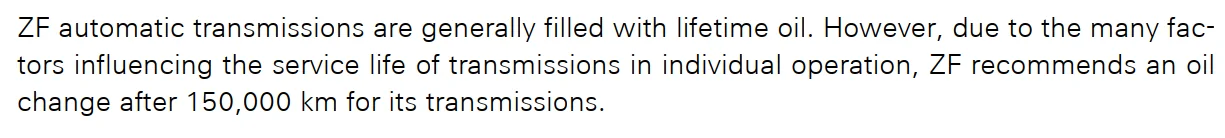

Look at the intervals ZF recommends for changes - they are still talking 80-90K or so with their own fluid.
For normal driving, ZF's recommended interval is 93K mi (conversion rounded down from 93.2K mi). I consider this advice, from ZF, to be an extension of "the book". Please note that, from a warranty perspective, ZF is not part of Jeep or Stellantis.

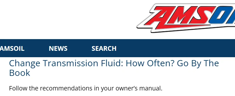

For normal driving, the owner's manual says "life of the vehicle". This is from "the book".

Also, the findings on increase in torque with some oxidation are interesting. This could set up a torque vs. longevity debate.

However, ZF also says that the fluid is good for life -

But that is tempered with "many factors influencing" - I prefer the 90K for ease of people "getting it" or understanding it.
