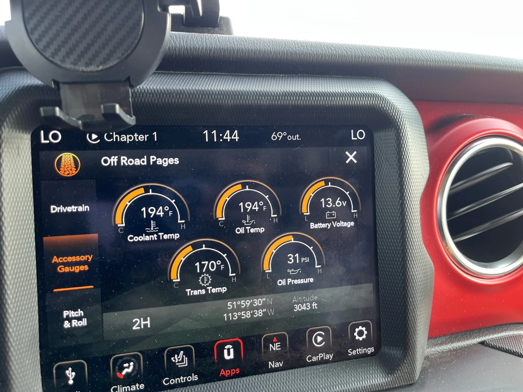

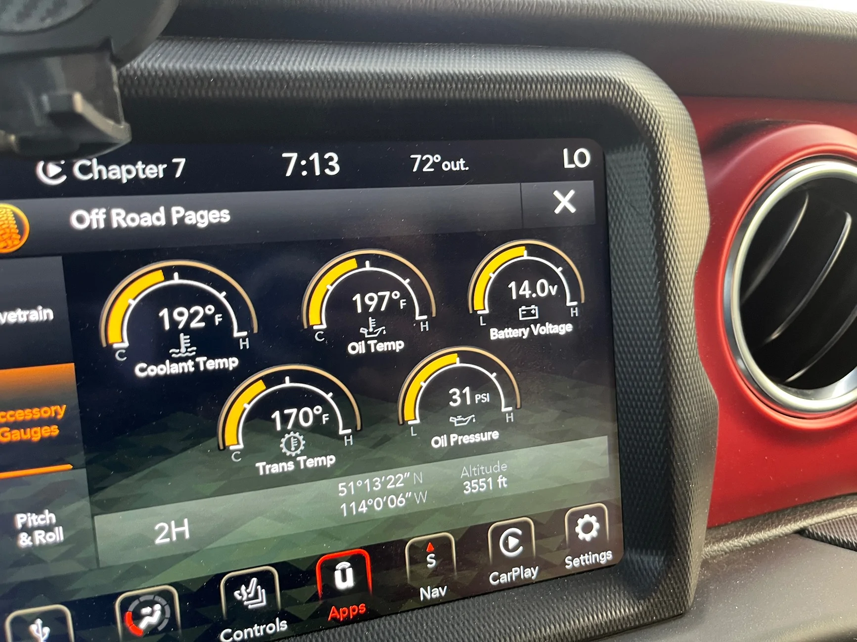

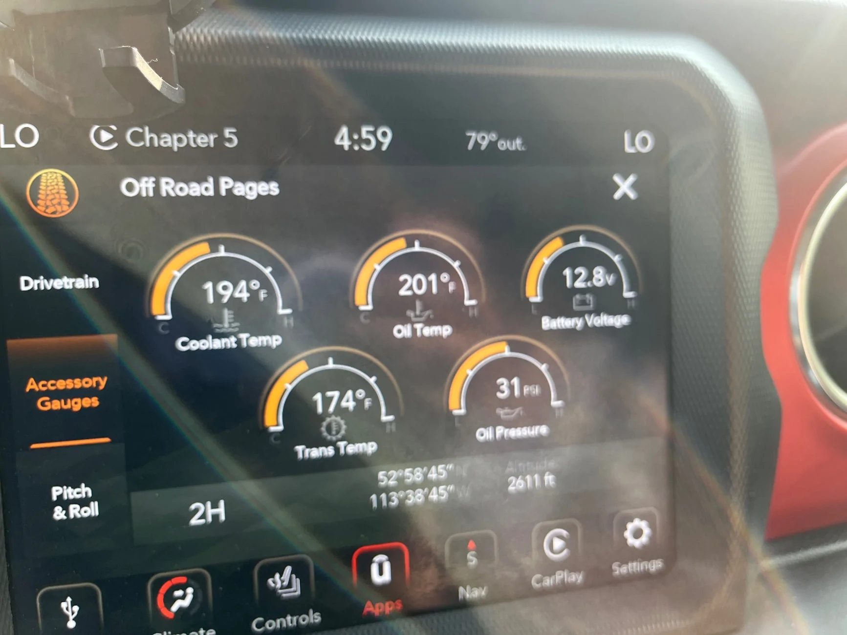

After the 3rd pan drop, temps fall, and now 3 months after my 4th pan drop, another decrease in temperature.
Had the pleasure of travelling north 3.5 hours to Edmonton on Monday! Finally doing a road trip that had me going there and back in the same day. Truck loves the road trips and I saw another drop in transmission temps.
I said above that after my 3rd pan drop was when I noticed temps drop. Then after the 4th pan drop last May, temps dropped again. I honestly didn’t expect to see it drop even further, but it did.
So, not speculating, not guessing this or that, just real world test and what comes of it. Cause and effect.
Maintained speed of 120 - 130 km/hour (up to 80 mph) there and back. Wind was relatively calm the whole day. Ambient temps were decent.
We have rolling hills here as we travelled north. I saw temps rise on those hills to 174F then as I levelled out, would drop to 170F.

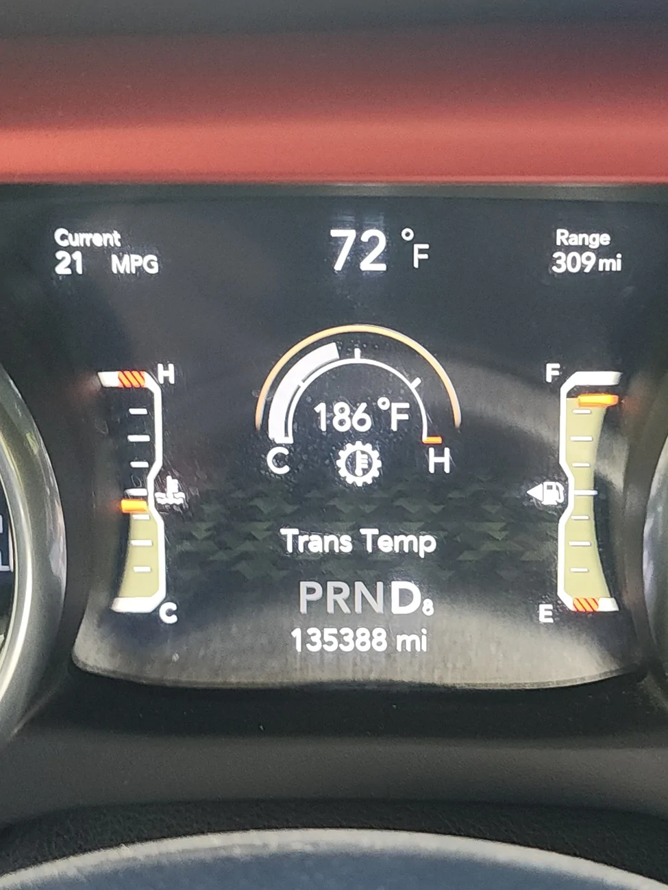

This is a very typical temp on my transmission. After outside temps reach the 90 degree mark transmission will go up to 192-195 & only under load up ling grades it will and has reached 199 and I am heavy in the skinny peddle at that point also at 4k + rpms.
