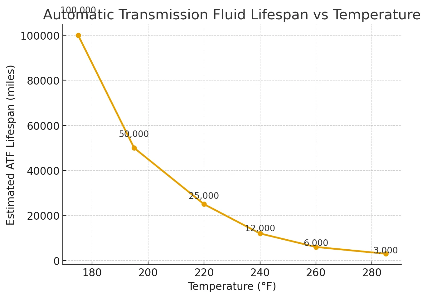

For me, if I saw that, I’d have a sh$&! But many have seen those temps before and I’d guess the consensus would be from some who are wiser and much smarter that the oil and tranny can go even hotter before there’s concern. Heat kills trannies but I don’t know at what temperature heat starts doing damage. @ShadowsPapa would definitely be the one to say.
Well in some of the documents shared here the flash point is 402 degrees Fahrenheit. That is super hot . I can see towing grade for long distance making transmission climb that high. ( hope you spray dust out of the radiator etc..) but I usually never see mine go above 199 even on a long uphill pull going 65-70mph but it has to be about 90degrees Farenheit outside

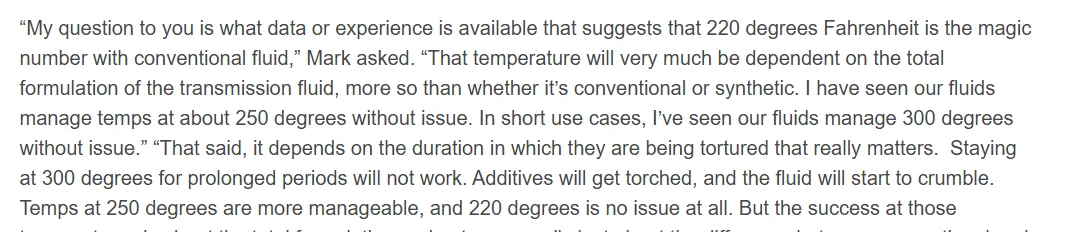

What is that derived from? I think there is more leeway with modern synthetic base fluids than mineral based ones.
That would have me changing fluid every spring 😂
Bingo. There are wide variations in fluids and their make-up and resistance to oxidation/breakdown. More information is needed on this graph. Just on the surface, whatever fluid they measured looks weak.

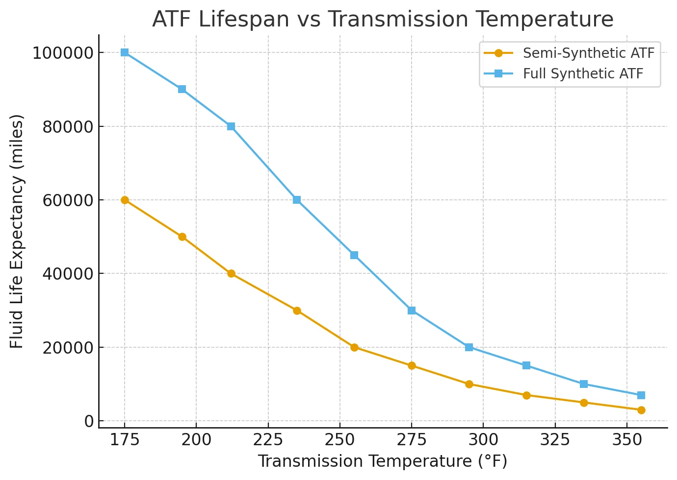

Here’s a graph showing both full and semi syn ATF. Sure it’s Ai, maybe there’s some wiggle room for discrepancies in how it comes up with the curve but if it’s in the ball park, we as drivers should be noting what temps we get up to and consider that maybe it’s “lifetime” could have shortened.
Let’s say the graph is correct and that we assume for a moment those two lines are showing Mopar 8/9 (they aren’t, the graph is generic) as being both full and semi syn, because it’s been published as both but my lab tech can’t tell me by my lab results what the 8/9 Speed is,… my question would be if the ATF’s life is up, done, used up, additives are depleted at at the points this graph shows, why would we ever accept the manufacturer’s position that this oil should run its life out before changing it?
Is there no cause and effect from additive depletion that’s taken place 30k, 40k earlier? Some see 220+ once in a while on a long trip towing etc… I don’t know, no body lab tests their transmission oil or try to get oxidation numbers. I guess it’s easier trading it in at 50k.

Where did THOSE come from? 1960?
Funny - really. 25,000 miles? Hardly. Wow, everyone would be trashing transmissions just in normal use.

Most of the charts you find online are from the mid-1990s or so, older transmissions, older fluid formulations, non-synthetics and so on. Get some modern info, new stuff, the last couple of decades at least.

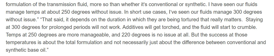

using the recommended fluid will not cause any damage at 220 degrees. You won't have to change your fluid at 25,000 miles if you see 220 degrees.
Do it if you want - but it's not damaging anything - IF you use the correct fluids.

The only time I've seen issues is when people got the transmission hot - and by hot I mean over 240 or so for more than a very short time.

Yes, to the synthetic, but more to the chemistry - the formulation. MODERN fluids make such a chart look really antiquated.
Jeep Gladiator Anyone else use this ATF in their Gladiator 8-speed? 1757032474679-uq
But again, they also said the chemistry matters - thus, choose a quality fluid that meets the specs (and they can prove it)
Is there no cause and effect from additive depletion that’s taken place 30k, 40k earlier? We see 220+ once in a while on a long trip towing etc… I don’t know, no body lab tests their transmission oil or try to get oxidation numbers. I guess it’s easier trading it in at 50k.

220 degrees is no issue at all, 250 is manageable.........
You know that the numbers ZF and others use (Mercedes and so on) have a buffer built in, knowing that very few actually watch temperatures at all, and few will do the changes as suggested, most will even go over. When they say it's good to 90K, they really know it will be good to 110K, but don't dare say that because people will do it.
Well to be fair mine runs 192-199 on 75-90°degree Fahrenheit days while pulling up hill at 65&70mph look at that chart on the blue line that would place my fluid change firmly in the 93-95k territory which matches ZF's 93,200k fluid change recommendation 🤔. And seeing was AI generated it is hard to say what source that draws from.
That plots about right for the 60K to 80K miles ZF recommends for their fluid changes. I do not think I have ever seen my transmission fluid temps get above 220F and usually averages between high 190's F to 215F most summer days.
