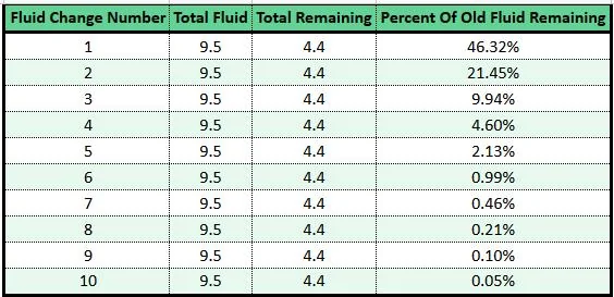

I have a post on doing my first transmission drain and fill from back in November 2023 with 57,000 miles on the dash posted here:
https://www.jeepgladiatorforum.com/forum/threads/first-transmission-drain-and-fill.74234/
I am an Accountant with a very basic knowledge of vehicles.
Thank goodness for Youtube and forums like this. I was able to DIY the service in my garage.
As of September 12th, 2024, my current mileage is 68,500
No issues
Transmission runs exceptionally well
Shifts are smooth between all gears
I plan to do another transmission drain and fill at 80,000 miles which I expect to happen around November 2025. That will be 2 years from when I performed my first drain and fill. That will leave me with approx 21% of the original fluid. I'll do another drain and fill at 100,000 miles around November 2027
No issues
