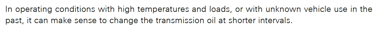

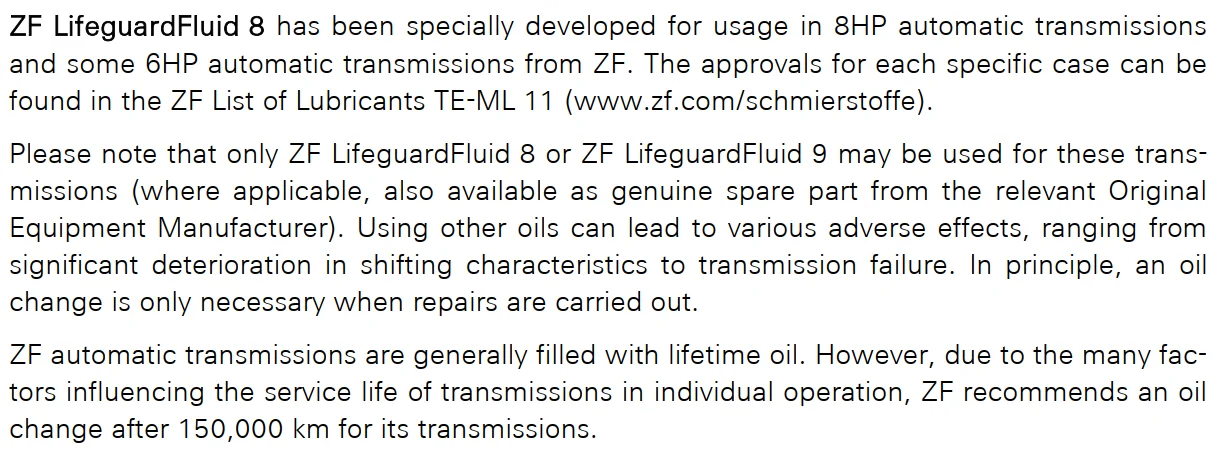

From ZF, the people who make the transmissions, designed them, and created the fluid specs for them -
Jeep Gladiator Automatic Transmission fluid change interval s on 2021 JT 1758652916150-5
Jeep Gladiator Automatic Transmission fluid change interval s on 2021 JT 1758652976078-o6
DUH

"Lifetime", meaning 5/60k. =D
If driven hard I cant hold too much against that theory. I mean even Einsteins peers thought He was nuts until He proved that Gravity can bend light.
