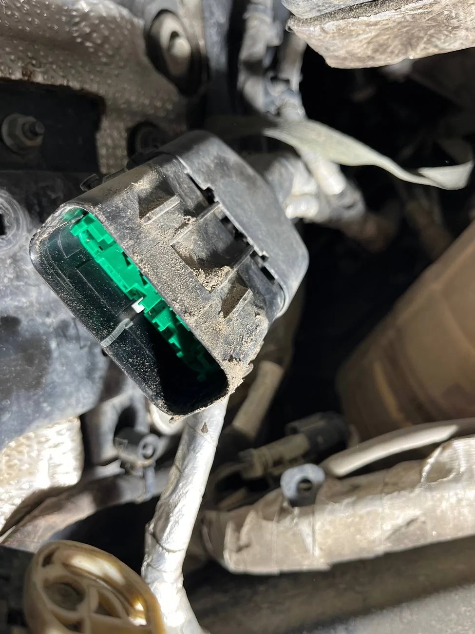

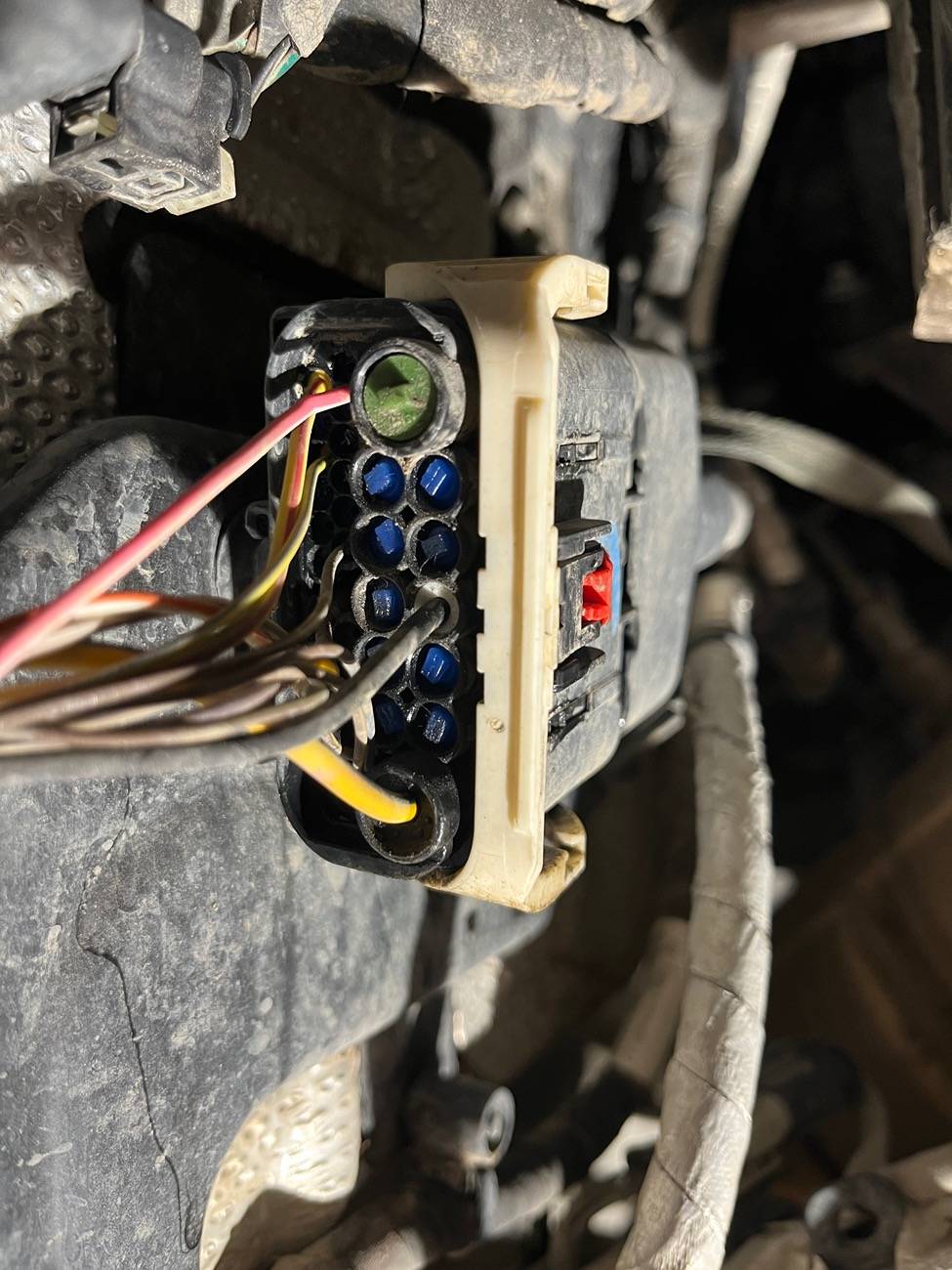

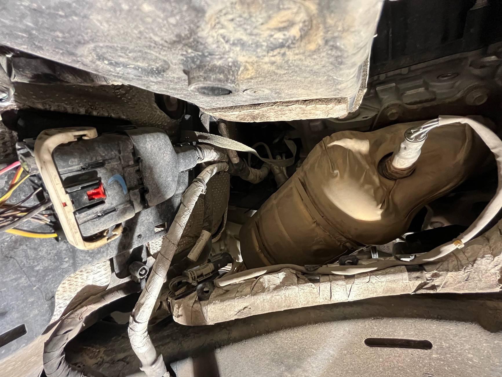

Did you by chance ever water ford or have the TCM connector under water? (You may know its location) behind the passenger wheel well liner and located just under the AUX battery. In case you know where it is, have you disconnected it, inspect it for water ingress or and cleaned it out or done any kind of maintenance to it to clean and lubricate the pins?

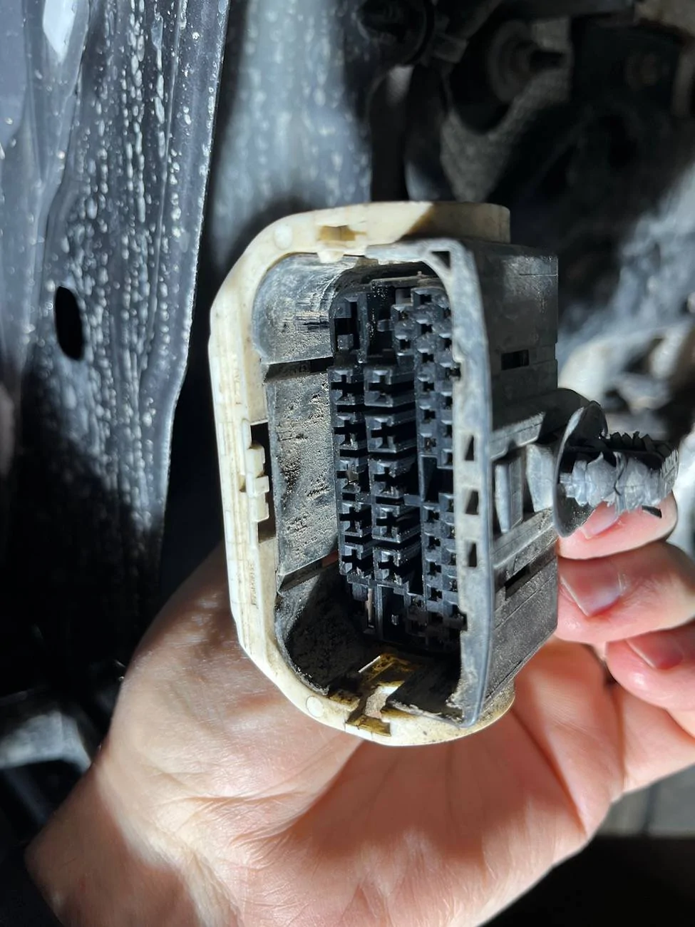

When I investigated mine, some time ago, I took my TCM apart and sprayed out both mating surfaces with DeoxIT D5 then top coated with DeoxIT Sn5 and put them back together. So far so good. All the pins are communicating.
I think many of our operating issues can be some grounding gremlin in a connector. As you know, we have so many of these major connectors that are “water proof” but I think using this cleaner and spray is just another line of defence that works in our favour to maintain communications.
Not too long ago, I had a code that said I had an injector stuck open. If I thought the worst, I was looking at tearing off the top of the engine to get at the connector and injector but because the wiring goes into a harness and this harness eventually ends up at the major connector to the ECM, and because that connector is just easy to get at, I pulled it apart (which automatically reboots the system) and I sprayed it out with the DeoxIT and put it back together… no more stuck open injector. A big problem for me, became simple.
Nothing that deep not that I can recall , now some mud one time long before the issue started yes. It was slurried mud frame deep . But never experienced this till many thousands of miles later ..and I recall washing it ALL out from under it
Great info. Good troubleshooting.
