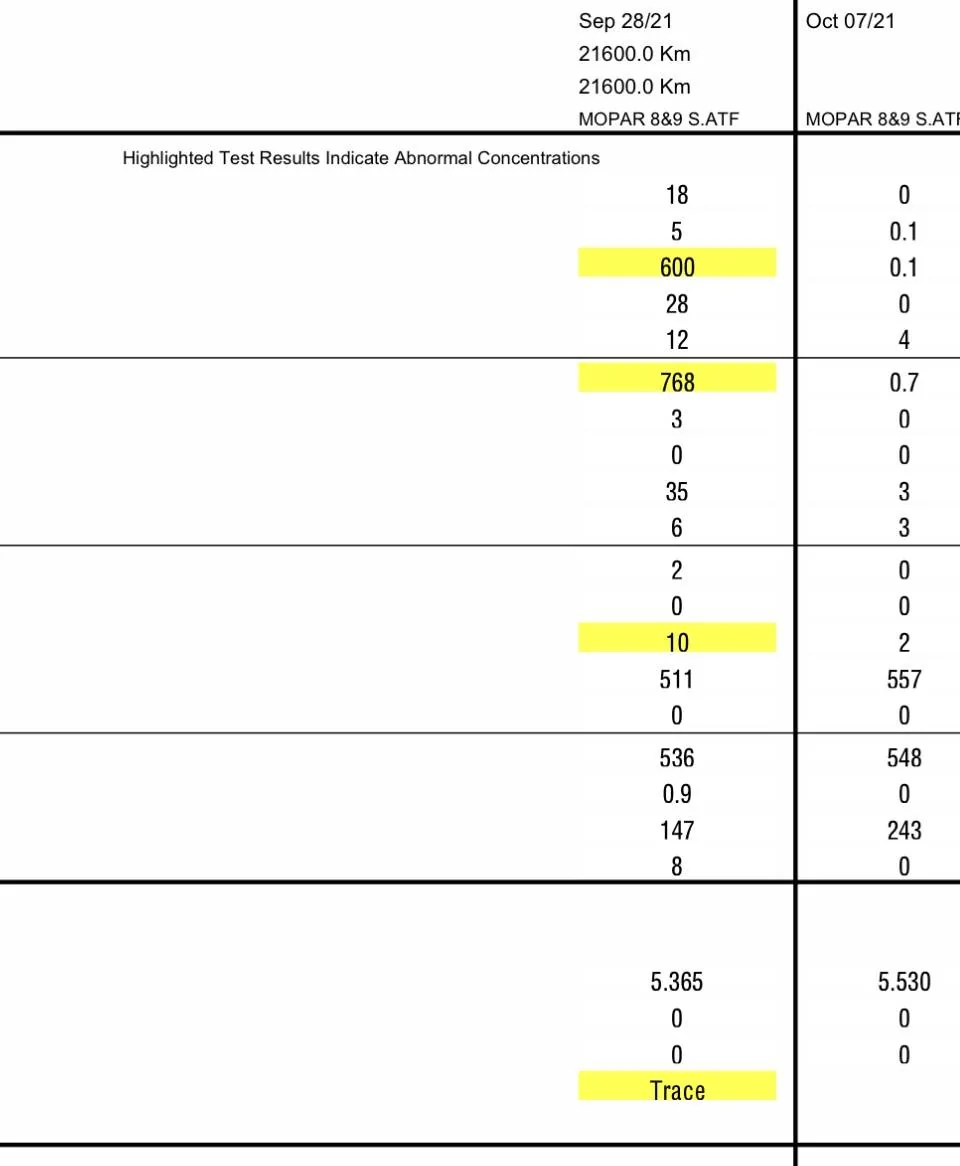

Here’s the reason several of us, NOW, use and rely on oil analysis reports to tell us not only the condition of the oil but it also shows us the health state of the component we’re checking. If we know there’s a problem, like in my case, (I can speak about it and get the facts right at the same time), the report here was what I first obtained when I heard a faint whine in the transmission while on a road trip to BC from Alberta. My book, doesn’t basically say I needed to leave things be, it mandates me to investigate. If I was to find contamination in the oil like “water, etc”, I’m to “change the oil”.
Question @Mr._Bill (FCA insider), how does one “investigate” if you can’t tell from just looking at it? Do you open the forbidden fill hole and stick your finger in there and pull it out to find “water, etc” on it? Do you rub your fingers together to feel “water, etc”? Can smelling your finger you shoved in the hole satisfy your curiosity to what’s wrong or do you send a sample to the lab? So, if you guessed the lab part, you’d be right.
The lab report that was done BEFORE the infamous oil change flush that according to you, destroyed the perfectly operating transmission….. say with me, all together “B E F O R E”, ….Bill I need you to participate with the class and not stare at me in cold stone defiance,… say it,…. “B E F O R E”, good, this report was given to the dealership who said, “Chrysler would not view this transmission as broken because it still works”. The FCA investigative team REFUSED to consider the report proving the transmission was cooked and on its way out because of the glycol contamination, say with me Bill…”R E F U S E D”, good, you’re learning, you’ll be alright. They made a choice, the whole barn load of them willfully and willingly signed on to go along with the lie that the fault with the transmission was that AMSOIL was put in that caused it to implode.
I’ll tell you something else, I have the lab report that analyzed fresh Mopar 8/9 speed ATF and AMSOIL FE ATF and would you believe me if I told you they are nearly or “basically” identical in additive package?
The report I’m let you see again proves the tranny was cooked. No one here, including you didn’t tell me that and I also never dealt with this before. The yellow highlights from the lab indicates abnormal numbers. The items the highlights represent, from top to bottom are as follows at only 21k kms, 9 months after driving off the lot.
Copper 600ppm
Iron 768ppm
Sodium 10
(trace - glycol contamination)
If you were to gather reports of other “like or same” transmissions in perfect running and operating order at or around 50-60k miles or about 90-100k kms, the copper should read somewhere around 150ppm and Iron in the same ish neighborhood.
Are there any experts or oil analysis users out there that would like to comment on these numbers and provide expert or non expert opinion as to the state of my transmission BEFORE, (Bill, there’s that word again) I did what my book mandated me to do?
Copper 600ppm
Iron 768ppm
Sodium 10
