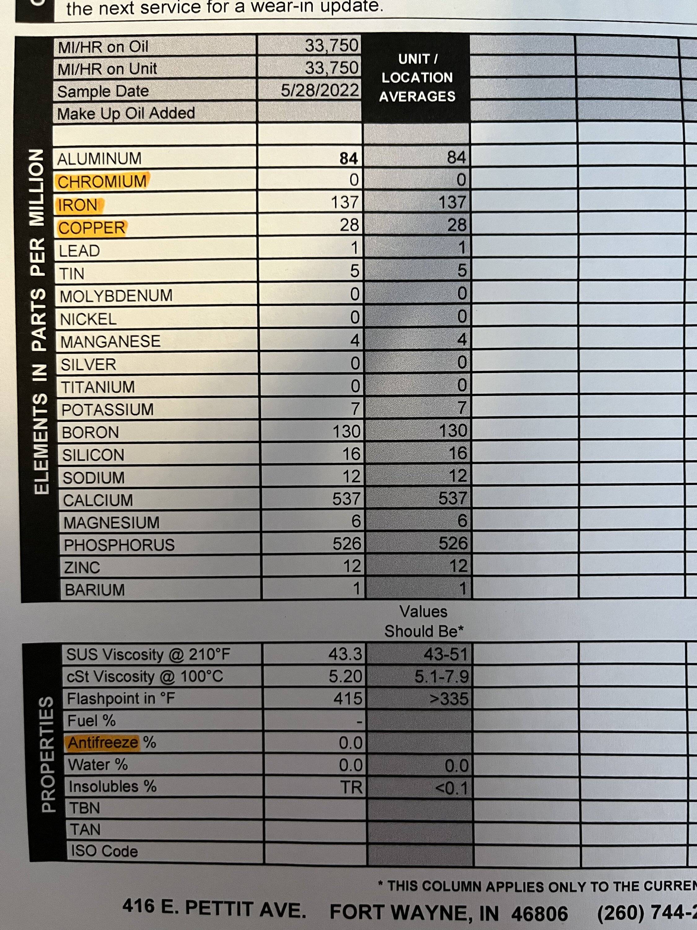

I was going to change the fluid anyways because of the color alone. It was really dark and sparkly.
Dark and sparkly is a reason to change it regardless.
I don't consider the boron to be an issue. It's an additive used in EP lubes, oils, and transmission fluids.
It doesn't indicate wear.
This is from a European test outfit -
Boron is an additive metal commonly used in detergent additives and occurs in some EP or AW additive chemistries. Only when the boron level deviates more than 25% from the new oil or reference value should a concern be raised
Boron is used in extreme pressure compounds
and dispersants. It can also appear as
a contaminant as it can be used in the
manufacture of coolant conditioners.
Because of how it works, I expect the amount in the fluid to be higher in newer fluid than older fluid.
It's not from the transmission itself breaking down.
And if there's no other elements such as glycol, I'd not fret the boron.
So it's either present as an extreme pressure additive to protect the transmission, or as contamination from coolant.

From what I can tell the sample is compared to a transmission with 70k miles of normal wear (no overheating or towing).
Now I have more questions, lol. Was the 70k mile trans the same zf trans or just a random one that was tested ions ago?
If it wasnt the same zf trans, that would mean my #’s could be completely normal.
aluminum: 63 avg 41
boron: 184 avg 133

What is a serious indicator of wear is how high the copper and iron get. My first transmission that had a bad whine at 24k kms, then tanked at 32k, the copper and iron were off the charts! A simple math of the lab highlighted numbers (and pretend I never did a flush) these copper and iron numbers tells you that this transmission will grenade when copper reaches 906 ppm and iron reaches 1067 ppm. The terrible situation of having had to deal with this with FCA saying "there was nothing wrong with the transmission to have done an oil analysis in the first place" was a statement made in obvious error.
Ive seen lab results on a great running ZF 8HP transmission pan drop at 50k miles showing iron at 150 ppm. Copper was slightly behind.
So, if you reach my numbers, expect to have to pull over and get towed. If you stay well under my numbers, you'll be ok but compare your sample with that from the bottle.

I appreciate all the reference material here. I requested a couple sample kits from blackstone labs and intend to send out a sample when i do my change.
I know of some resources out there and I'm sure Hootbro has some excellent resources on hand - likely more and better, on how to read what you get back, and to make sure you pay attention to the important stuff and not get hung up on some of the other stuff.
I'll pick on boron. It's usually in a compound that's used for extreme pressure lube protection. By itself it's an ok thing, even good, because the fluids will have various additives for wear, scuffing, anti-oxidation, friction modifiers, things to stabilize viscosity and so on. But it's sometimes the combinations of things that can be what to look out for.
Real high boron WITH high glycol MAY (I stress "may") indicate a cooling system problem in some vehicles where coolant and AFT are in the same "device" - such as a transmission cooler. If it happened in my car with an in-radiator transmission cooler, I might be concerned. But then - you have to look further - is there ATF in the antifreeze? The highest pressure wins so some logic will help there.
Sometimes things alone don't mean a lot. But combinations may.
The first change will often be the worst for some materials because as you "burnish" the gears, wear them in, there's naturally more iron and other compounds involved. But after that, it should dwindle.
And of course - all that glitters is not gold......... LOL
Small flecks in the pan - pretty normal. A lot suspended in the fluid, hmmm.
