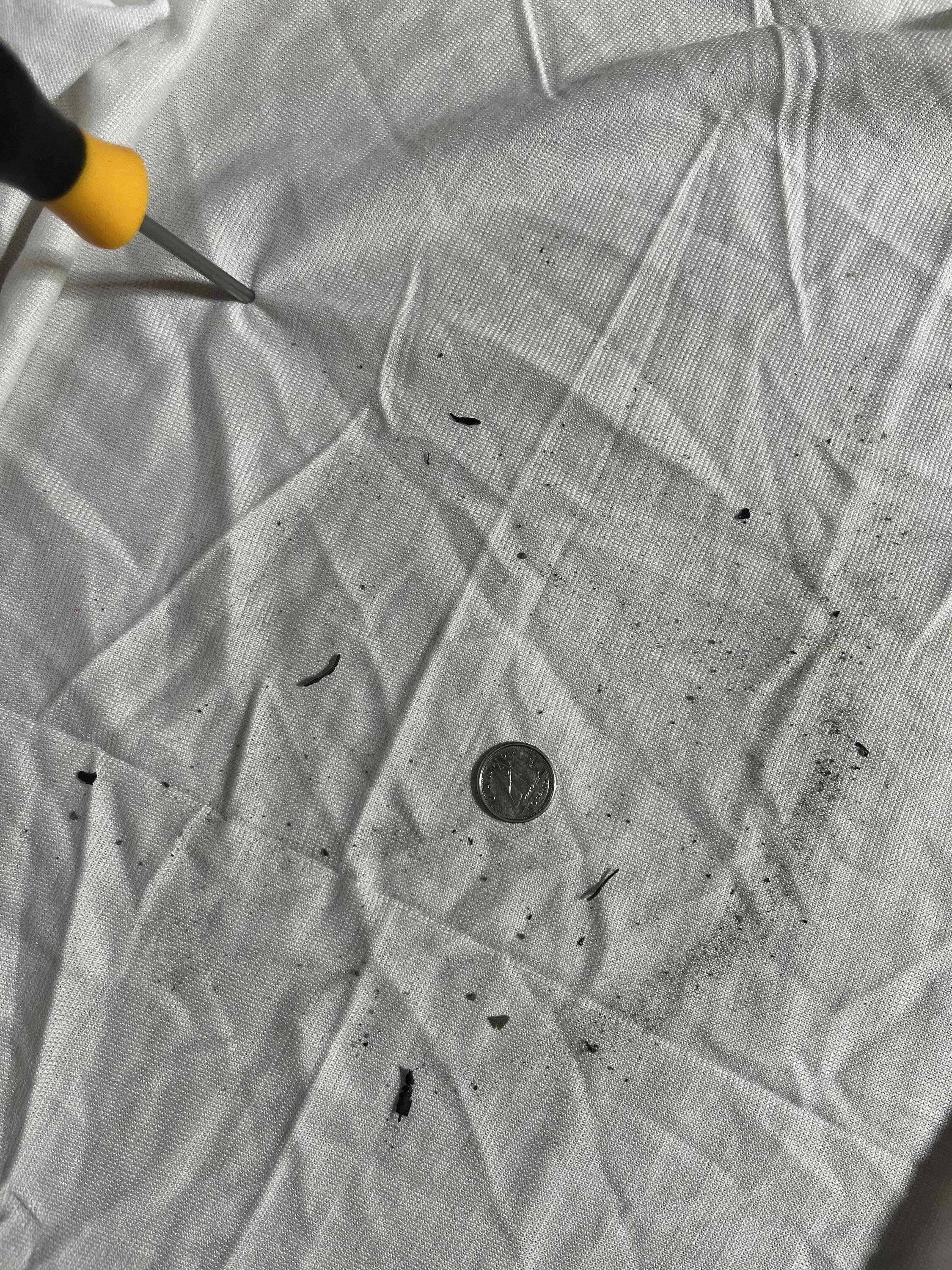

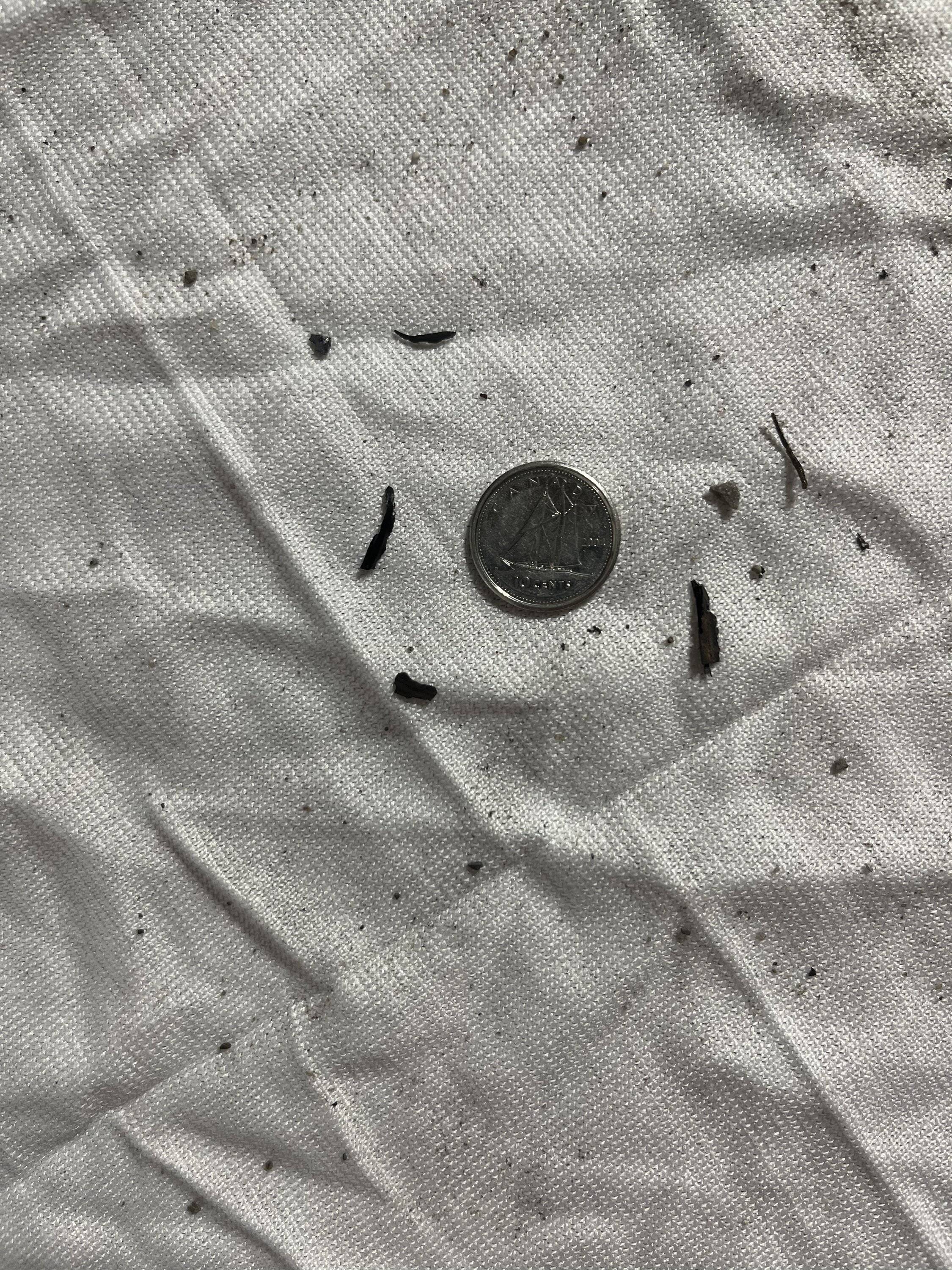

Experience in rebuilding and servicing transmissions for a few years has shown me that if the fluid has gotten hot, change it. But if you are changing it because of muck or metal in it, new fluid won't fix that, your transmission already has it's life-span determined.
Change it because of heat, or in the old days, because the additives were "depleted", but new fluid won't fix mechanical damage. It may extend the life a little, but it's destined to fail.
Why? because of what peers repeat out there? "common knowledge" and opinion of the internet?Just my opinion…. You already waited too long. Change the fluid now or pay out-of-pocket for a new trans when it does fail. Seems like a no brainer to me.
