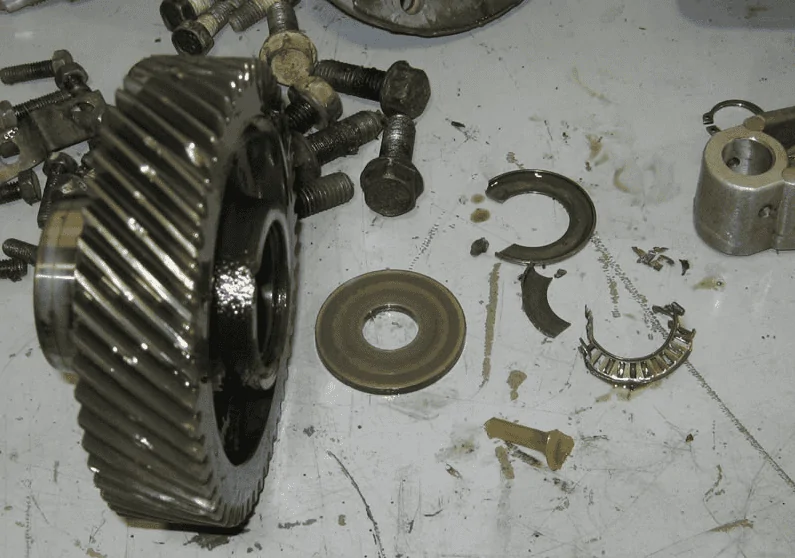

My T5 acted like a new transmission after a full rebuild and putting in the correct AMC spec (later Chrysler spec) syncromesh lube in it. The metallic flakes from grinding gears, wearing synchronizers get into the needle bearings and stuff happens........
I have to add, however, that both of these are at over 160,000 miles, all original.

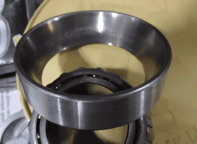

Pinion bearing -
