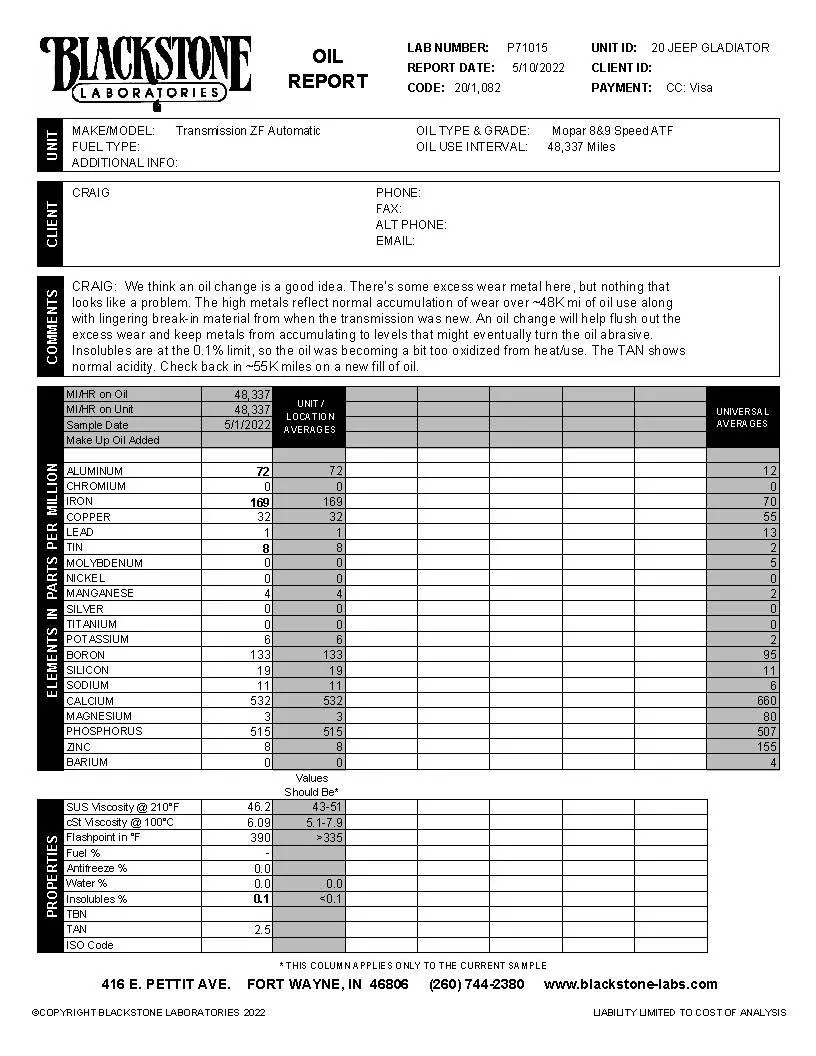

With all the discussion of "lifetime fluid", and facing a wait for the transmission filter, I decided I would do a used oil analysis before servicing the transmission (and because I promised @Maximus Gladius!). I'm not sure if some will question the efficacy of Blackstone Lab results, but I've been led to believe they are reputable and a good way to determine service needs.
The results confirm my own belief, and those of the engineers that designed the transmission and fluid, that there is a service interval that is appropriate and it's not a lifetime fluid. With that said, I do believe you could never touch the transmission and get a "lifetime" of service without trouble. However, until Jeep defines "lifetime" and "normal use", I'm going to proceed with a transmission service.

Yours has possibly been exposed to more "heat" than say, one like mine. Off-road, desert, mountains = more heat than a typical driver.
I've towed but the heat was never above normal highway driving temperatures, much to my pleasure. I expected to see temps at least a little above what I typically see, but did not. It didn't get hot. Heat kills the additives in any fluid or oil and you get oxidation. No "water" and nothing leading to acid formations.
Tin, zinc, lead - bearing materials - at least in the past. Haven't seen these personally but the replacements indicate similar composition so I don't see alarming indications of excessive bearing or bushing materials.

Transmission service is a good idea, for your use and the mileage shown on the report. The main issue would be future warranty coverage. Are you going to do it yourself, have the dealer do it, or take it to a independent shop?

Thank you, thank you, for doing this! Now we have more data of what’s happening with a healthy transmission. My vote is to have the dealership do the service to maintain your warranty, however, Chrysler may say ā€˜you were not to touch it for 100k’ (I’m thinking kms) so would they jump all over you if something happens with the tranny before 100k and void your warranty?? Give them an excuse and they’ll run with it.
It’s like I said in my thread about ā€˜is the lifetime fluid really good for life?’ I said that if you didn’t touch the fluid or do service for 100k and you are now at the end of your warranty, Chrysler doesn’t want it and now if you read Blackstone lab comment, you wouldn’t want your transmission either OR you should at least feel somewhat guilty you let the transmission endure that gritty, oxidized, break-in crap longer than it needed to.
So in all fairness, Mr_Bill is right for being concerned for warranty and staying true with the book and I am right for being on top of maintenance, to avoid malfunction and have long component life, well after warranty.

Here is a lab result of a fresh sample of the Mopar 8-9 Speed ATF to cross check the numbers. Also, my double analysis of my transmission to compare numbers. Look especially at the first report. 24k kms on the factory Mopar oil with glycol contamination.
