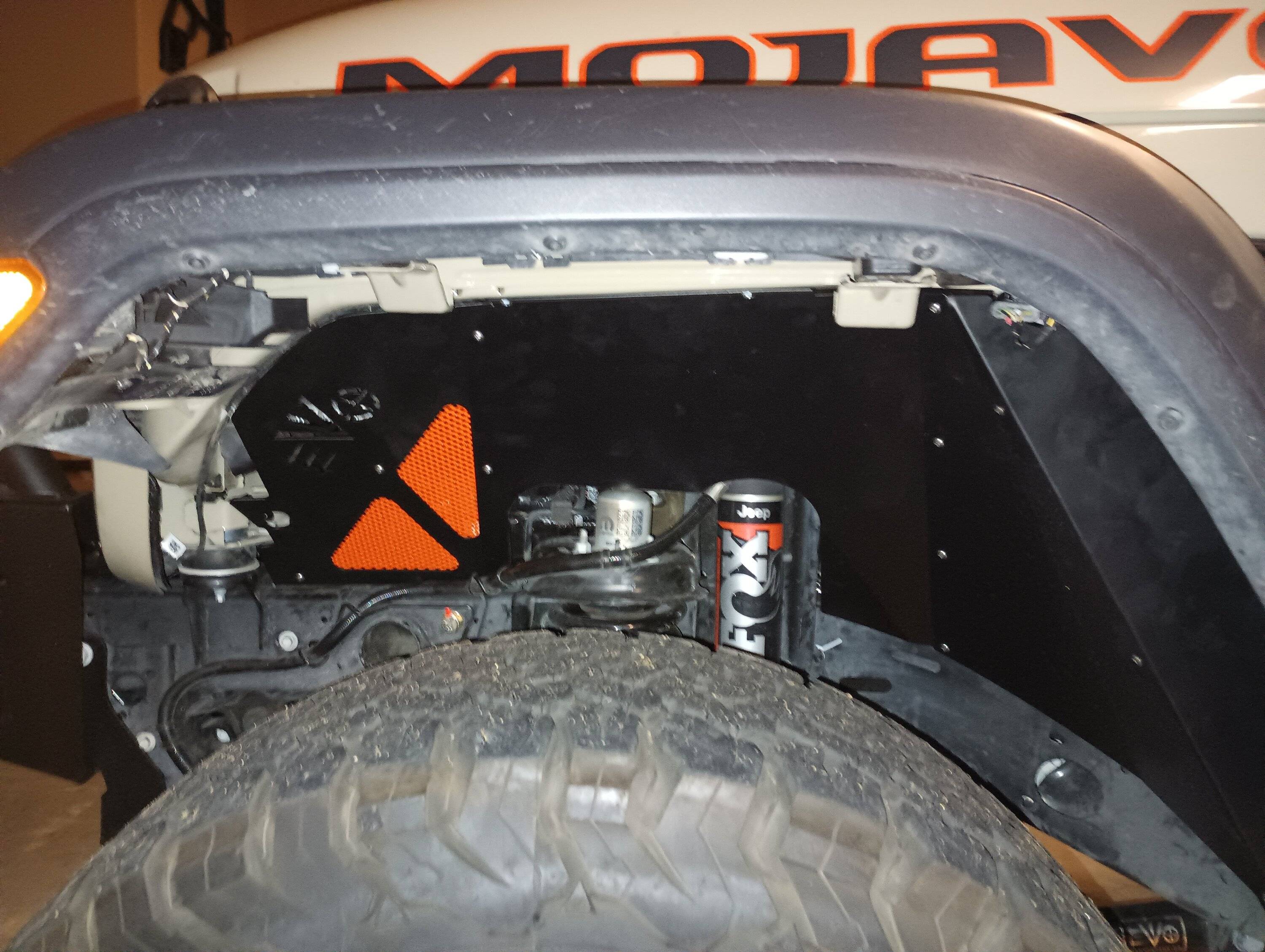

Anyone have pictures of EVO fender liners installed?

I’m trying to decide what inner fender liners to get when stripping my fenders. I think I have chosen the EVO liners, but I can’t seem to find any images of anyone with these fender liners with the factory springs. I have only been able to find the liners with the EVO coilovers. I’m trying to get an idea of how/where the ”bends” are to get an idea of clearances.
TIA.

What shocks are you running or plan to run? Any with relocatable reservoirs should be ok. Most traditional types would be ok. Falcon types with the reservoir perpendicular might require some cutting. One other thing I noted with the evo inner fenders is they work with the Grimm off road arb twin kit they make if that matters to you.
I am running a normal Fox 2.0 right now but will upgrade in the future to one with a reservoir. I do have the ARB compressor on the Grimm bracket which is why I'm looking to do the EVO. I'm just trying to get an idea how much that rear section sticks out in order to accommodate something like that compressor...

Well sorry I don't have a picture but I have seen them in person
  1. If you mount a reservoir like they intend with those inners the Grimm will no longer fit
  2. If you don't have the reservoir its kinda open and the ARB is going to get dirty fast
  3. the extra bit it "sticks out" isn't going to matter wrt to flexing out
IMO don't go EVO just because the Grimm. Its compromises all over. Go EVO for the awesome clearances for high end shock options down the road.

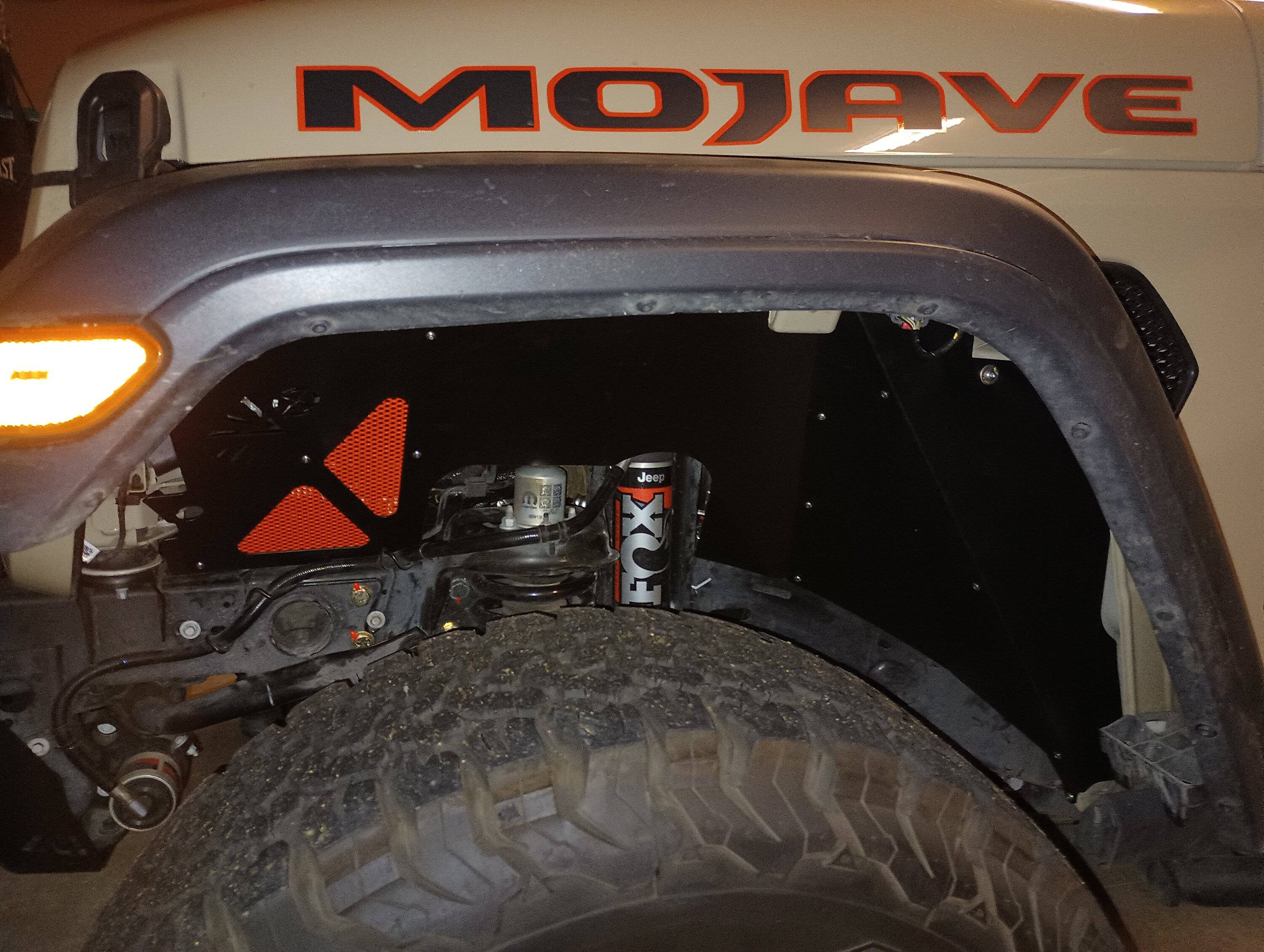

Just installed today...
