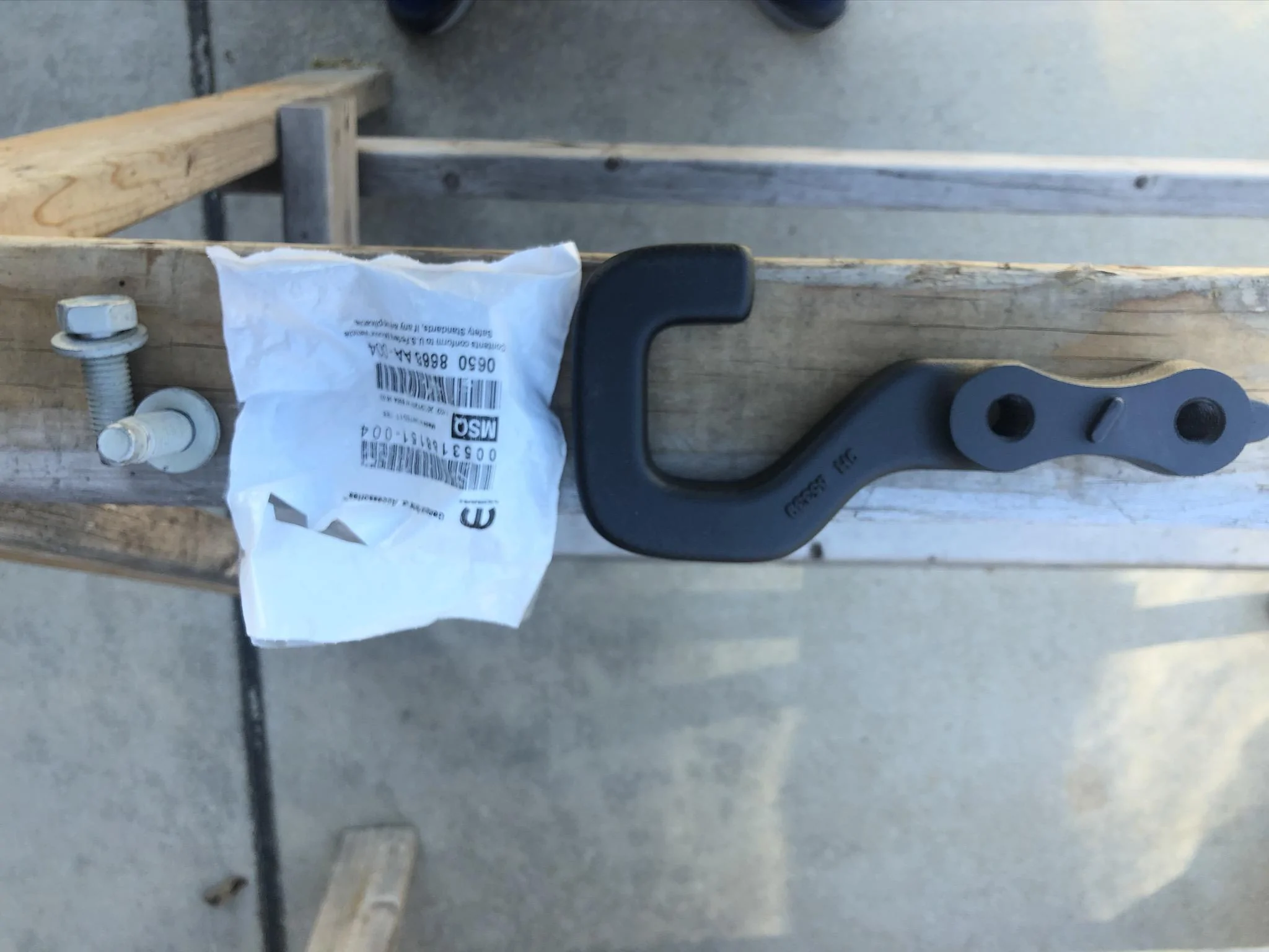

I put one on, thanks to forum member @Gregj who had an extra.

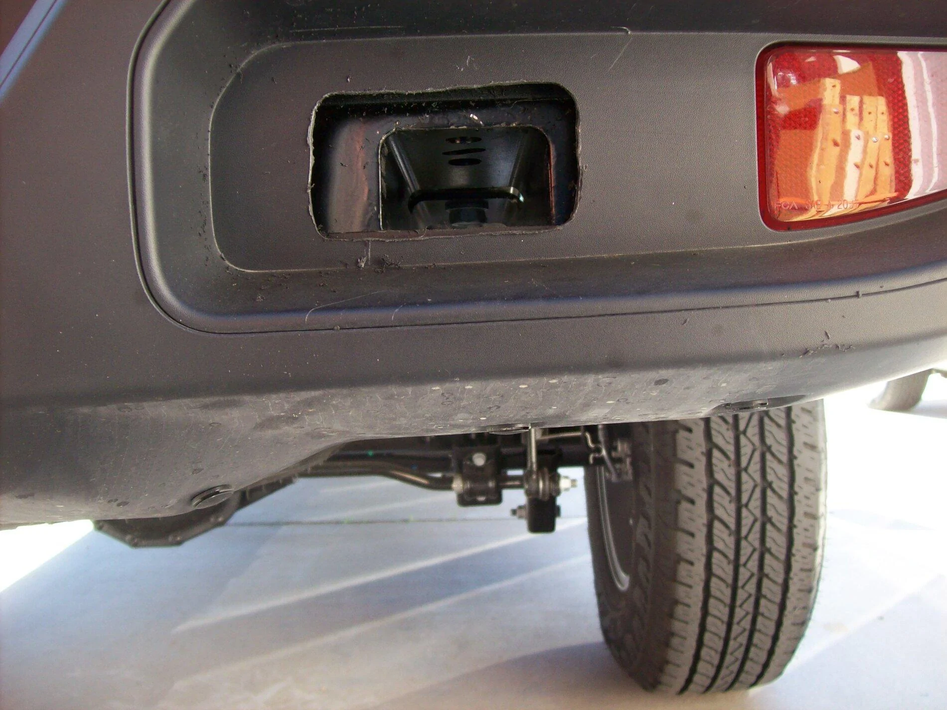

I did not remove the bumper. I just tapped on the plastic to find where the hook goes in and drilled a pilot hole so I could use a Dremel tool to route out the rectangular hole. If you look closely at the left hook access hole you'll see the frame has a hole the hook passes through. Just cut with the Dremel using that rectangular hole as a guide. When you buy the hooks make sure you get the bolts with it. You will need an articulating socket wrench to tighten the forward bolt.

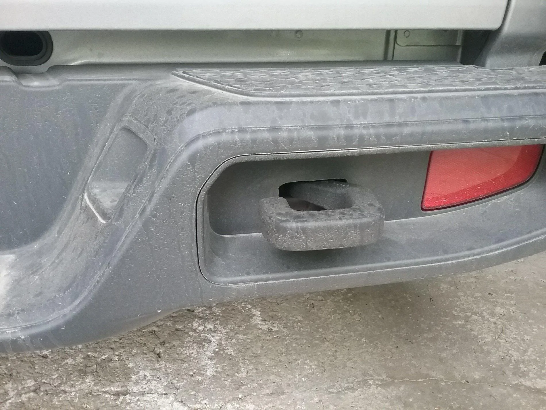

the Rubicon has both hooks and the plastic you need to cut is available. I don't have the part #S but I have done it!

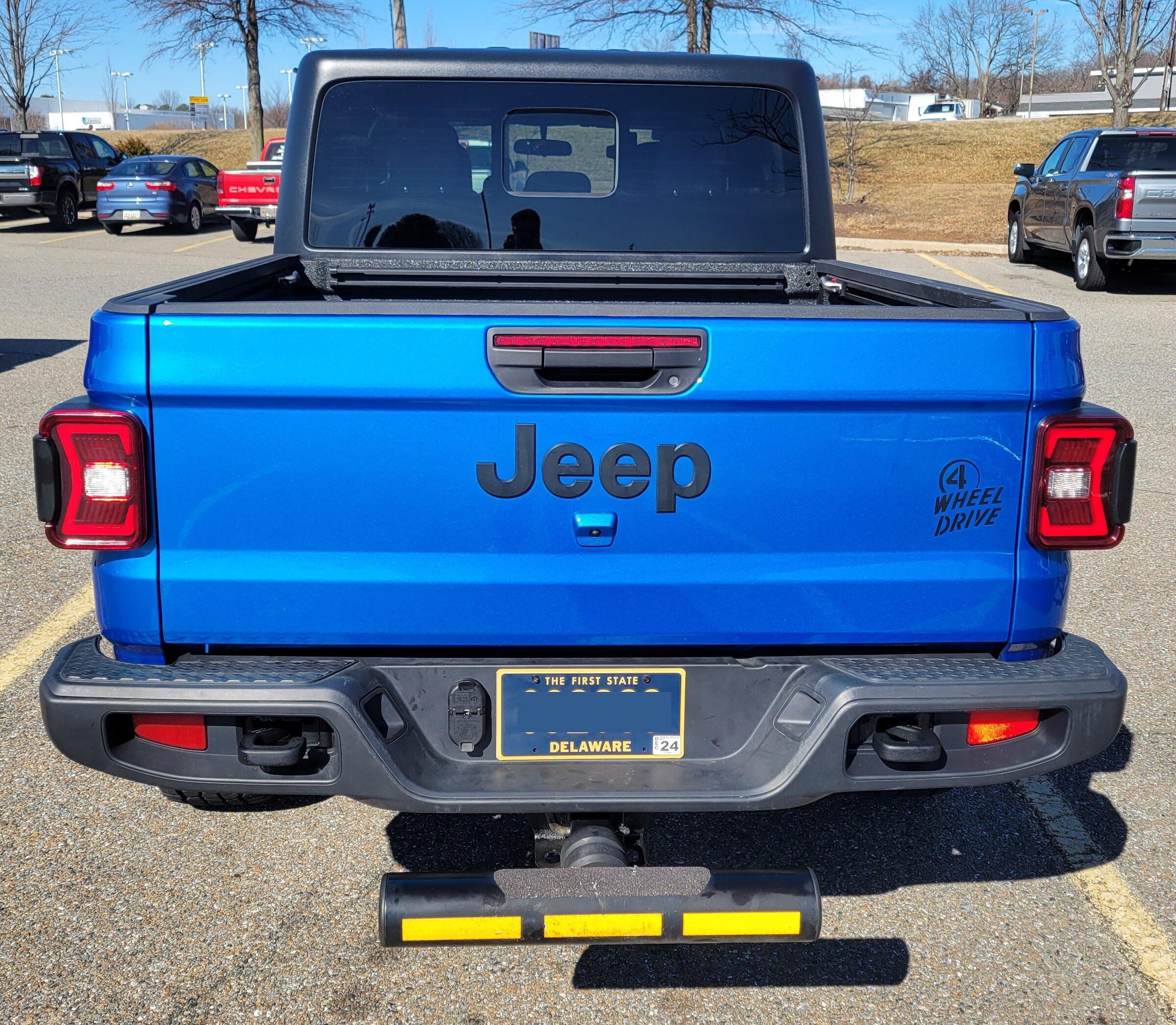

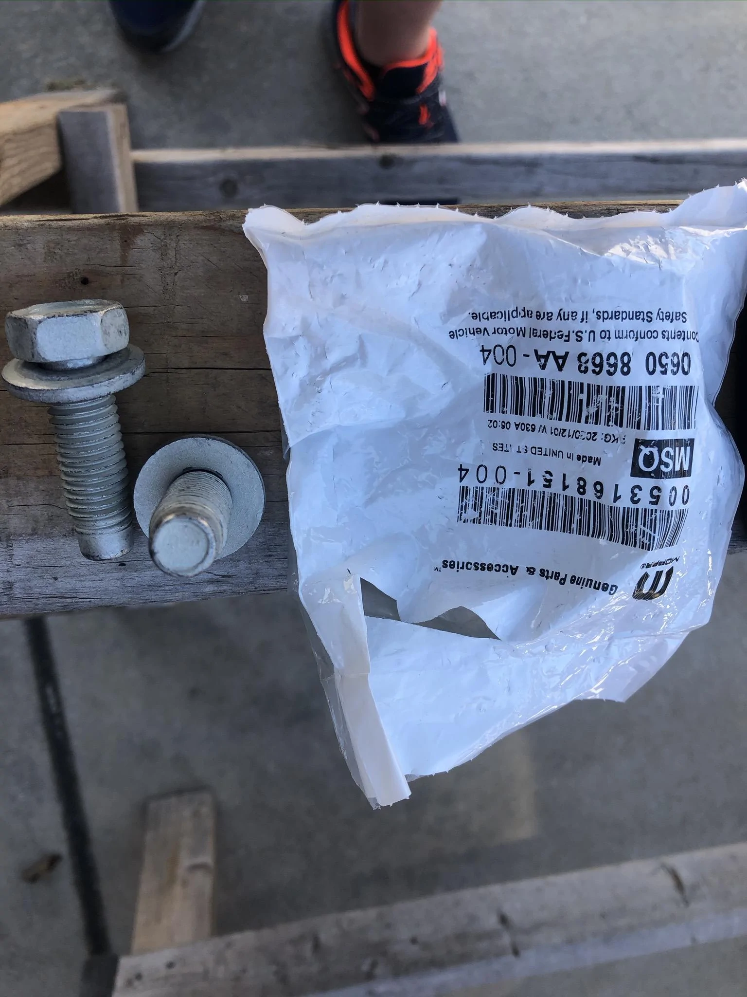

I made the addition last year, and used flange head grade 10.9 bolts from McMaster-Carr, shorter than the stock bolts for easier installation but long enough to end up flush with the end of the threaded holes. They are M14x2x35 mm long.

the kit is on backorder. You can cut your hole in the bezel easily, and I prefer the McMaster flange head bolts because the lede on the stock bolts makes them too long to install easily with the bumper on the truck.

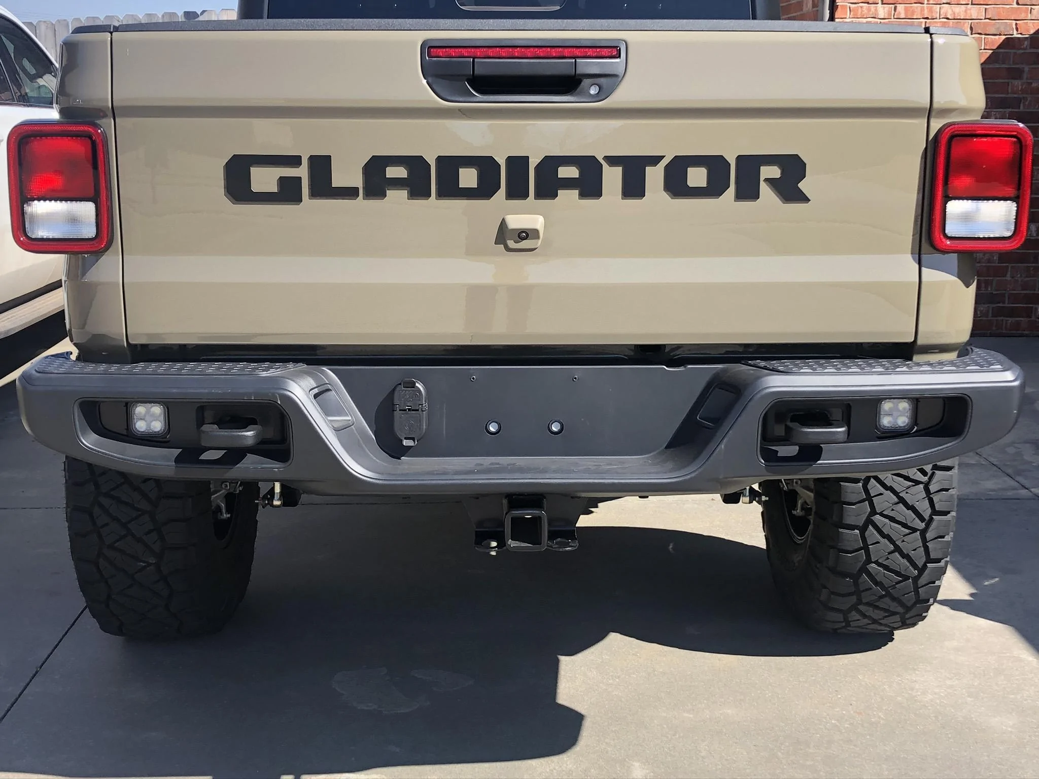

This is a super simple mod. I took the rear bumper off because i was installing real rearward facing lights in place of the reflectors at the same time. I used my dremel to cut out the panel and then used a mild sanding drum on the dremel to smooth and bevel the edges to match the factory side. You have to look damn close at it and know what youre looking at to tell its a mod.
