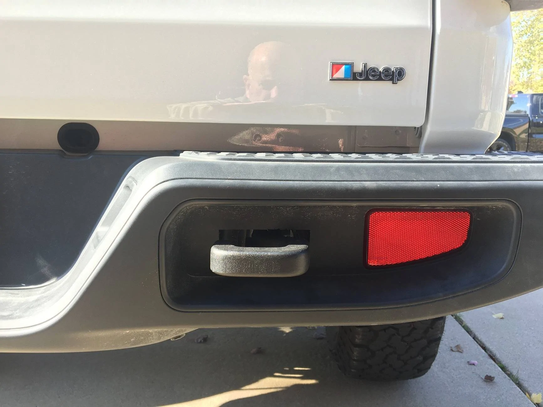

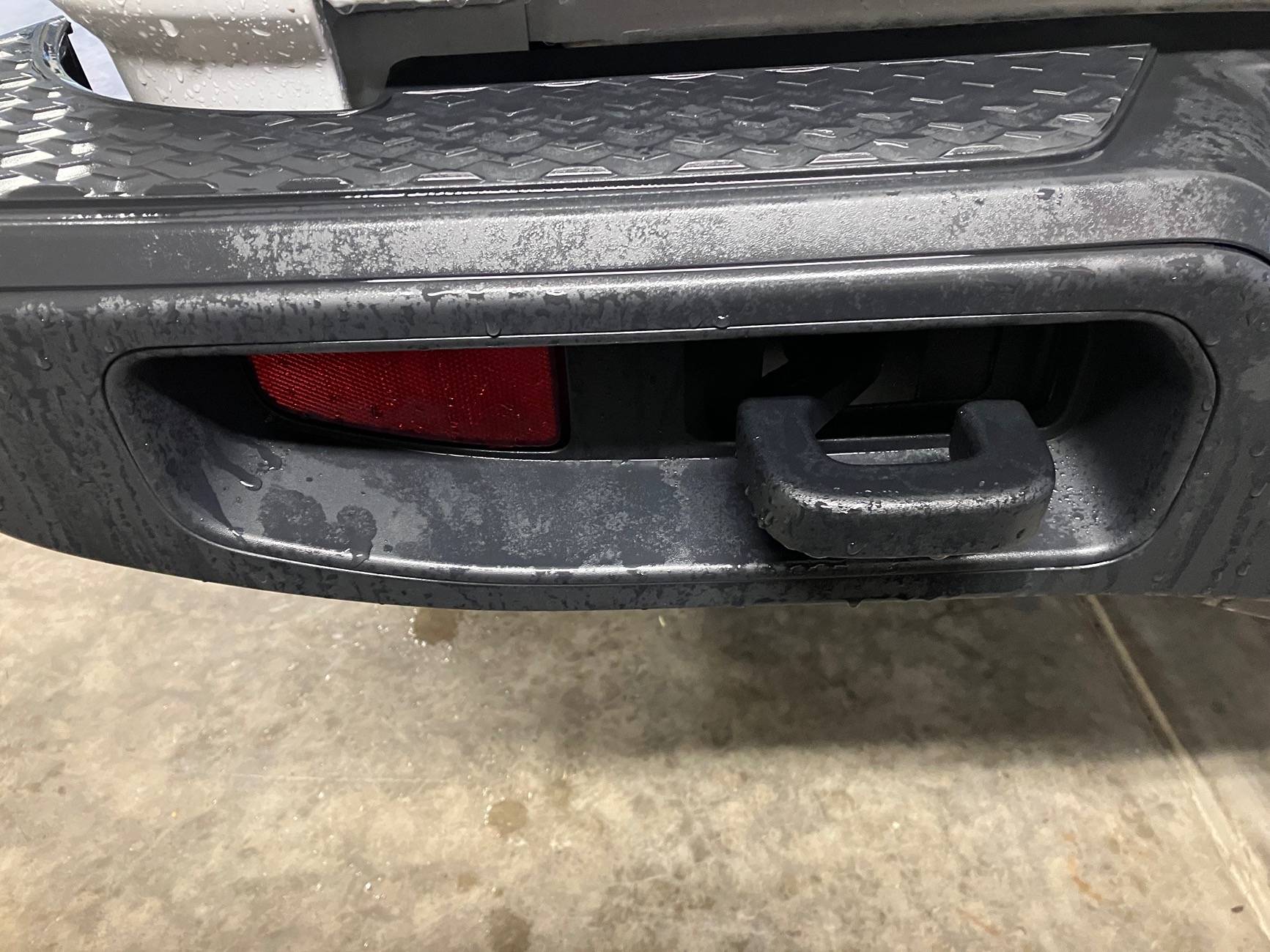

The rear tow hooks are all the same, there is no left or right the only difference is the color. On my old Overland I added the second hook. The frame has the threaded holes for it.
Jeep Gladiator 2 tow-hook rear bumper on a non Rubicon/Mojave trim IMG_3995
yes I painted the hooks silver.

I added a second hook after my first bumper got smashed on my overland and I picked up a like new OEM one on FB. I then had two hooks and so just had to cut a hole in the other side of the new one to put on the second hook.
Having a second hook is extremely useful for making bridles, etc. I highly recommend this simple and cheap mod.

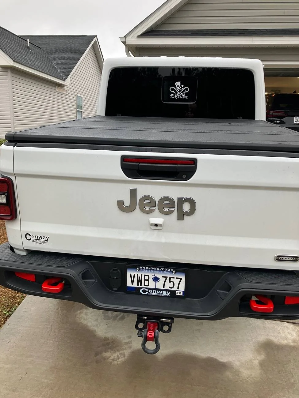

Its a 30 min modification. Easy Peasy for the 2nd hook.
I bought the new plastic insert, but decided it was quicker and easier just to cut the hole out vs tearing the whole bumper inner apart. So I never used it,

this was the first mod my truck got. You want to source a passenger plastic trim opening from a Mojave. This is VERY important. If you get the trim off a rubicon it won’t fit. The steel bumper has slightly different openings.
remove your rear bumper (4 bolts, two pigtails) and then replace the previously mentioned trim. (It slides right over the tow hook)
Bolt your tow hook in on the passenger side.
Reinstall bumper.
Proceed to look awesome.

Just realized you specifically asked about replacing with steel, my bad. Same process just without the trim swap. So even easier!
