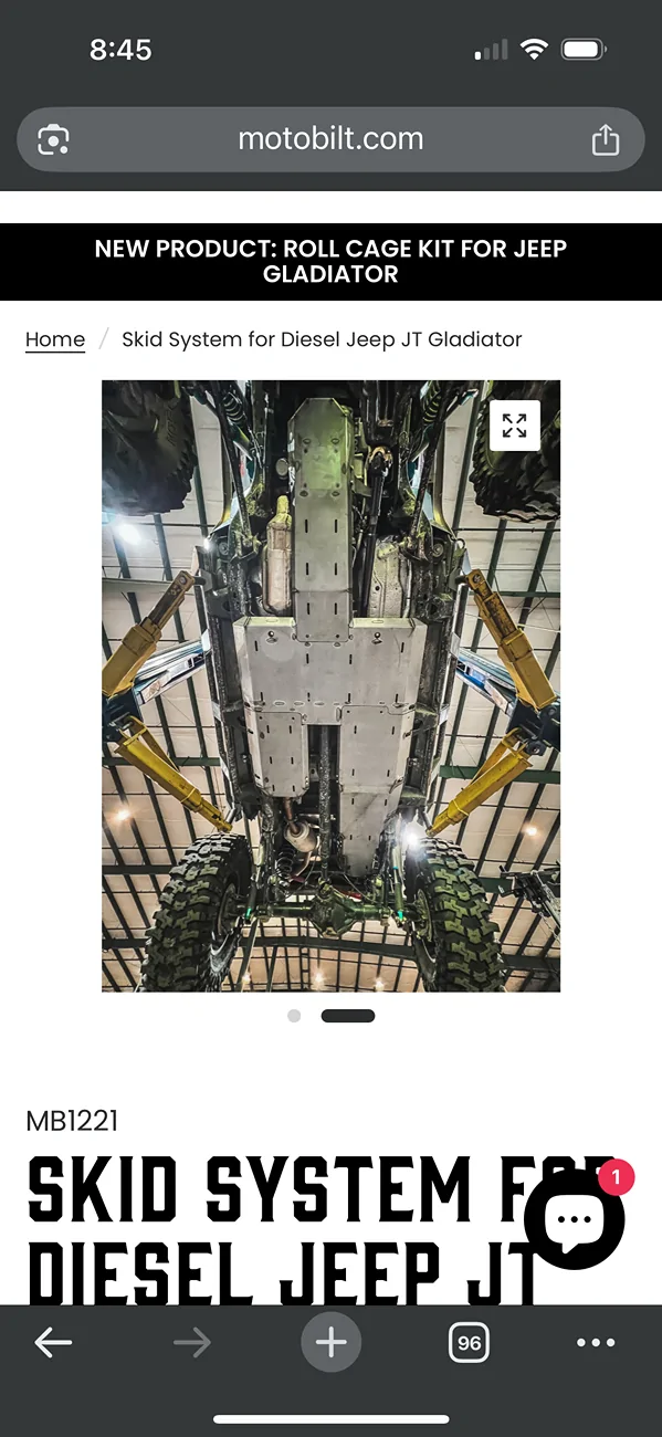

Motobilt makes full belly skids (steel) for the diesel and I’m wondering if you give up any ground clearance with them? They look nice and flat. I know some of the factory crossmembers are major hang up points/the lowest points. Do these skids sort of sit flush with the bottom of the frame rails more?
The fuel filter housing is probably the most vulnerable piece in its factory location since it hangs below the frame rail, even with its cute little skid plate. I’ve seen at least one company makes a relocation bracket to raise the filter housing. That seems like a good idea, but I think the fuel tank sits slightly below the frame rail anyway so the filter housing might not need relocating if going with fully flat belly skids.
Anyone with Motobilt skids have some pictures from the side profile while looking under the Jeep? Looks like you maybe give up a little ground clearance, but not much.
