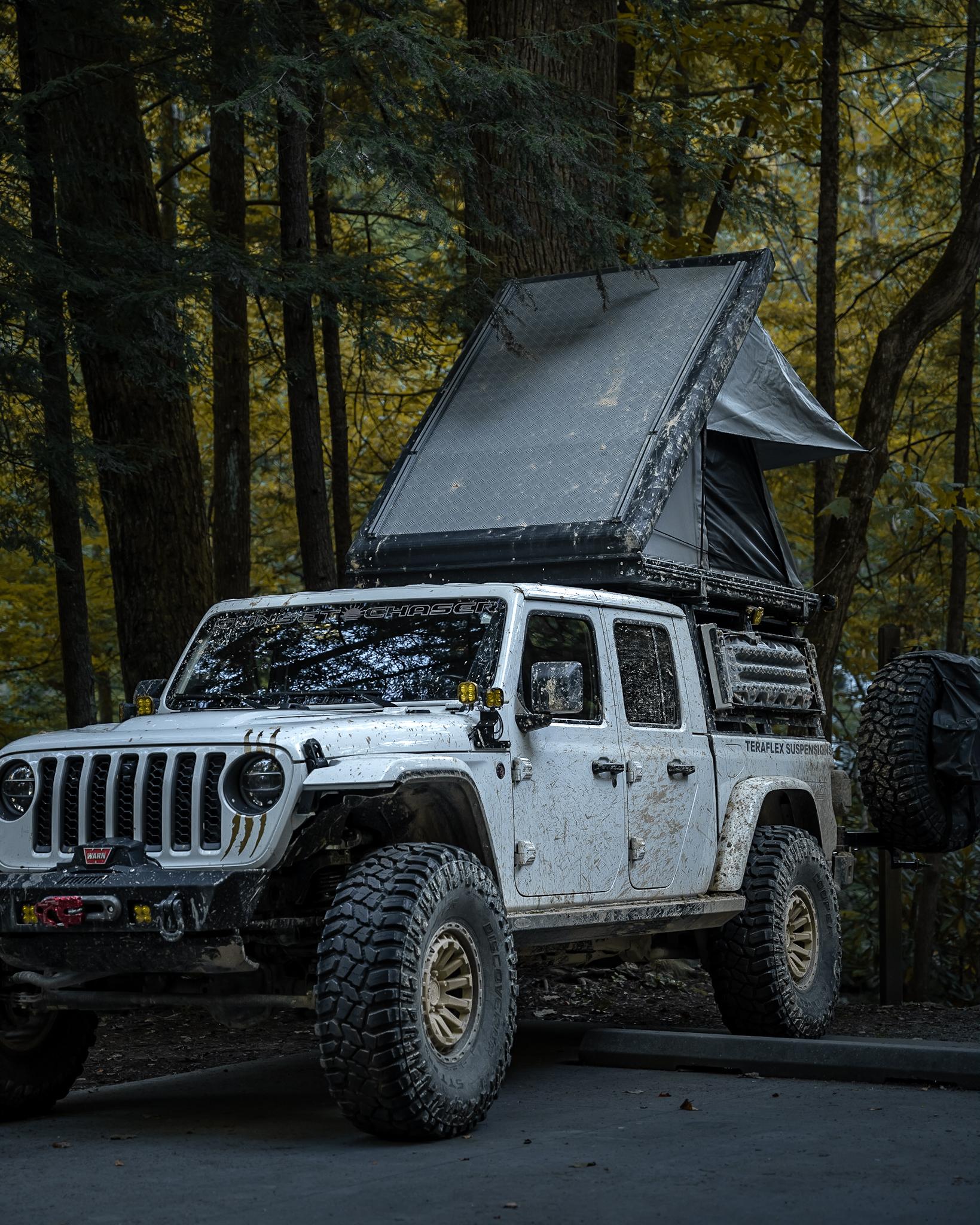

I'm about to make a 3,700 mile trip on 40's and a full "overland" setup with about 800lbs of extra gear. I'll report back what I get. On 37's I could easily do 23mph with the same "overland" setup. I expect to be in the high teens, maybe
Alright, well my trip ended up being about 4,400 miles overall. A pretty solid mixture of highway, city, construction zones, idling in traffic, idling in camp, off-roading/crawling, forest roads and general exploring. Massive terrain/elevation changes throughout the entirety of the trip. I averaged 19.5mpg for all of it. Saw as high as 22mpg, and as low as 16.8mpg active averages. Everything calculated by the dash, not by hand (too much to do haha).
8th gear still existed, but for the most part it seemed better suited in 7th.
Stock 3.73 gears. 40" Cooper STT Pros. And a bunch of weight (she's real thiccc back there).
Banks Pedal Monster set to City #7.
All of this being said, would I regear? Yes.
Do I feel like I NEED to regear... nah not really.
I'm going to look into getting 4.10's, but it isnt much of a concern. With the Pedal Monster set to City #7, it has plenty of power for what I need, and feels better than stock.
Hope this helps :)

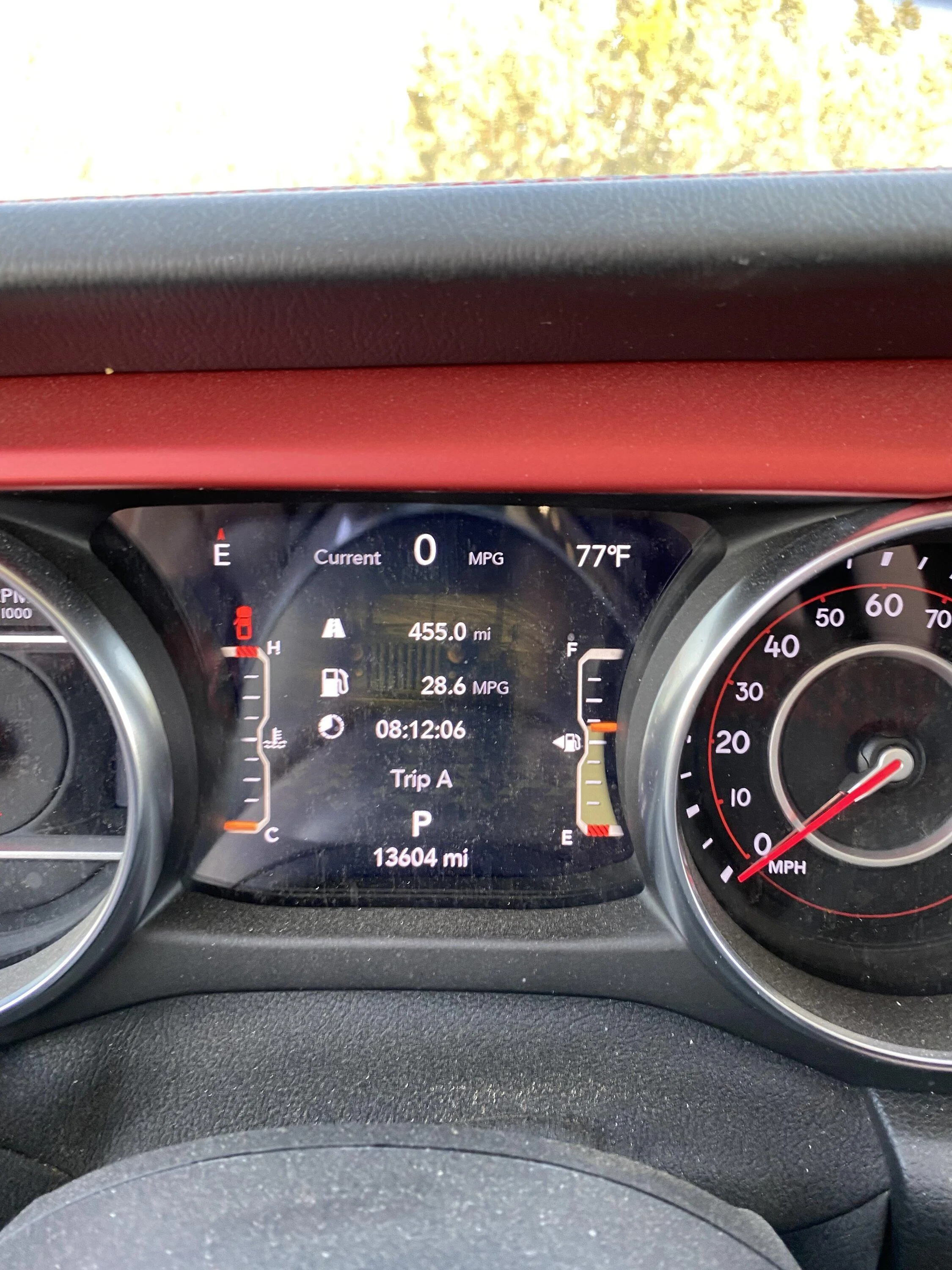

I’m on 40” Yokohama X-MT’s with 5.13 gearing. I geared for 42’s that I couldn’t get in time for the build. 40’s should be 4.88 gearing. The 5.13 is ok with 40’s, better with 42’s.
If fuel mileage is a gage: I’m heavy, close to 7K on the CAT scale.
I currently average 21 MPG mixed driving. 22 MPG highway with grades.
My wife driving the JTRD from Laughlin to Los Alamos following the Uhaul with trailer got 28 MPG. She is very light footed. Said 58mph was the sweet spot.
Yes GPS verified speedo and confirmed with quick math to confirm.
