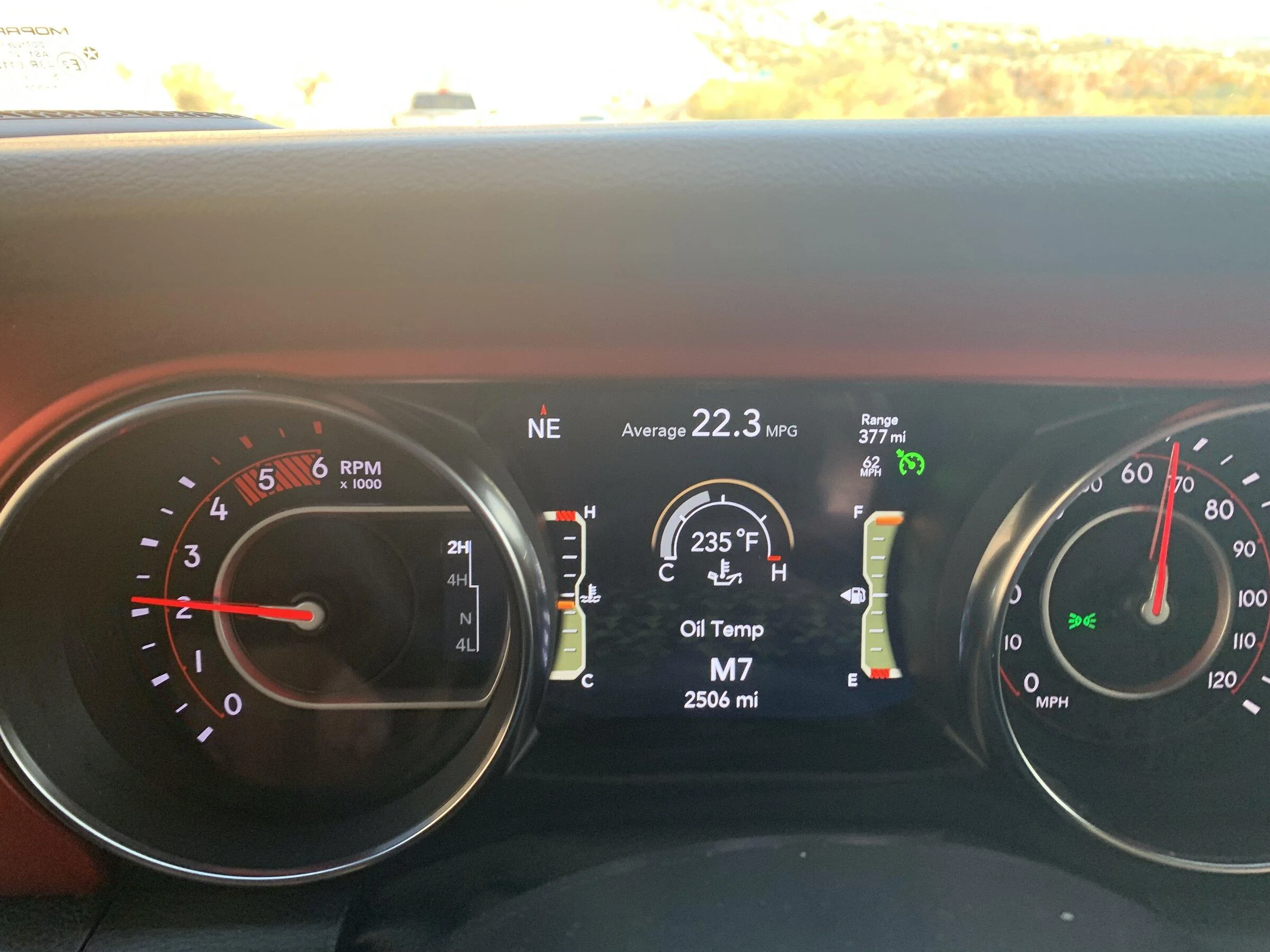

I think it depends on your goals for the Jeep and habits And also the weight of your Jeep and especially the wheels and tires you are running.
I see 7th and 8th all the time. Locking the trans in first + 4 low also gives a very usable range of speeds off road.
all that being said, if you tow a lot get 4.30s or 4.56 put in and do lockers while you’re in there
this is with 39s on stock gearing. Truck is happy at 1600rpm in 8th

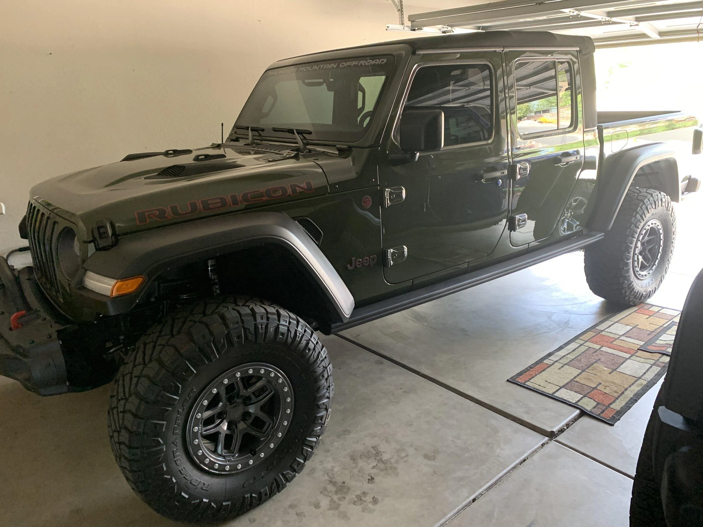

Yup 6000 miles on my 37s and no problems, then again my 4.88s just showed. I plan on installing lockers and towing with it

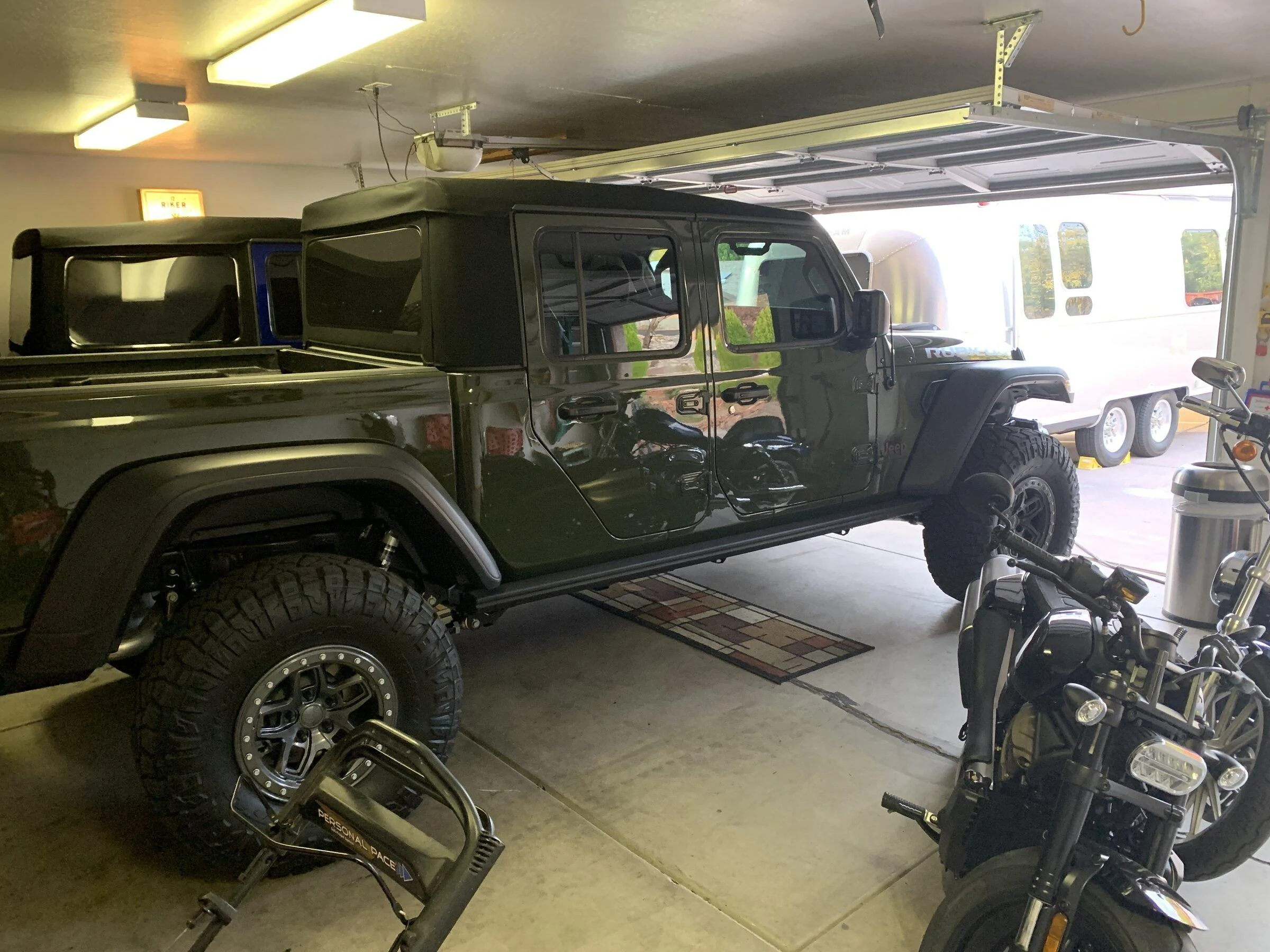

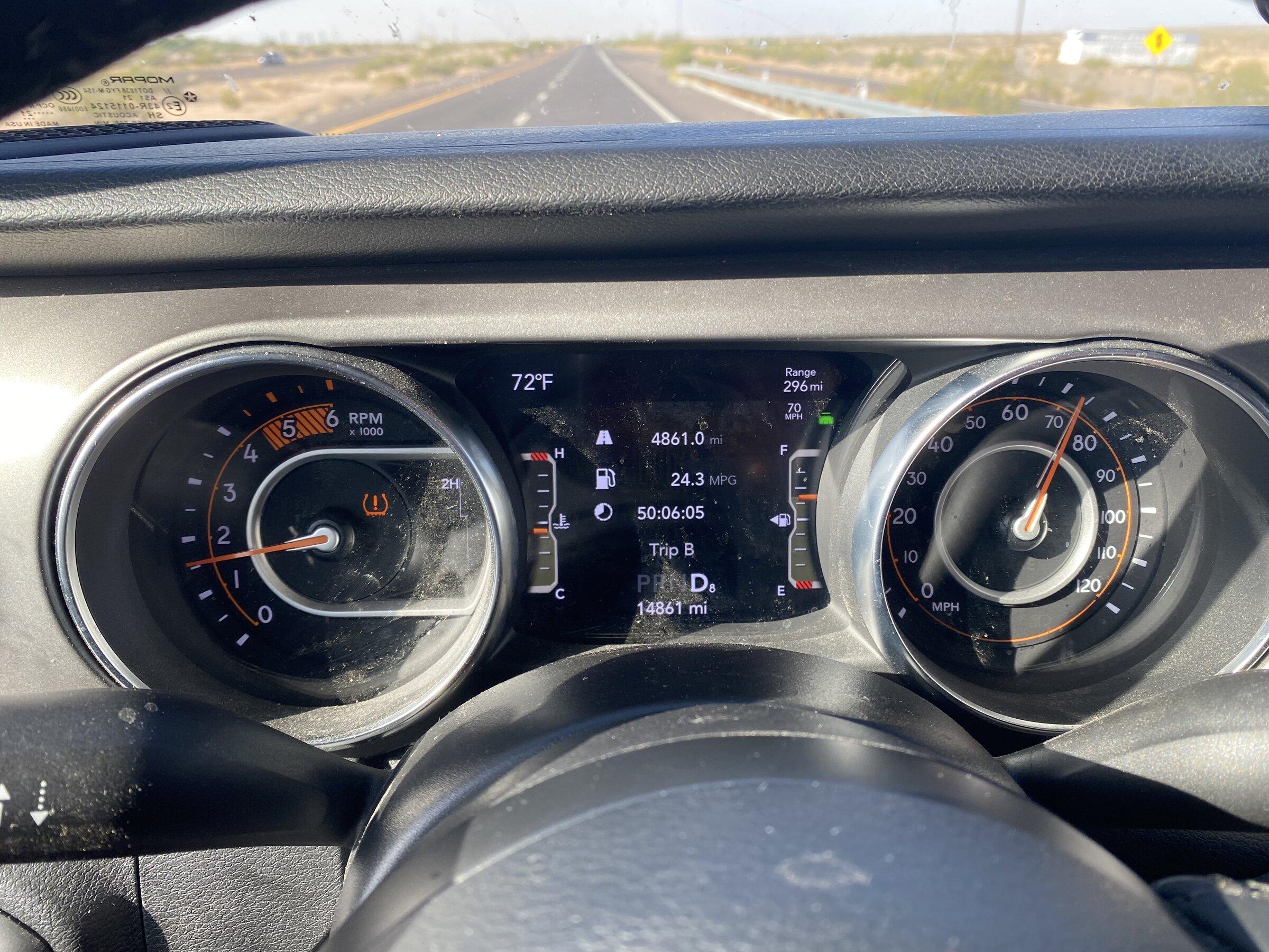

37/13.50/17 while towing a 28' Airstream up a 7 degree grade @ 4k feet...with 4.56 gears. 7th.
Jeep Gladiator 37" Tires non-Rubicon diesel 65653444425__361DBCCC-2772-41FF-9B62-E30B033D60B0 2
Jeep Gladiator 37" Tires non-Rubicon diesel IMG_2096
Deleted member 22728
After reaching home base. Gear/reagear? Let physics and the old lady be your guide.
Jeep Gladiator 37" Tires non-Rubicon diesel IMG_2099
You forgot to add in the snow with your eyes closed while eating a sandwich…??
