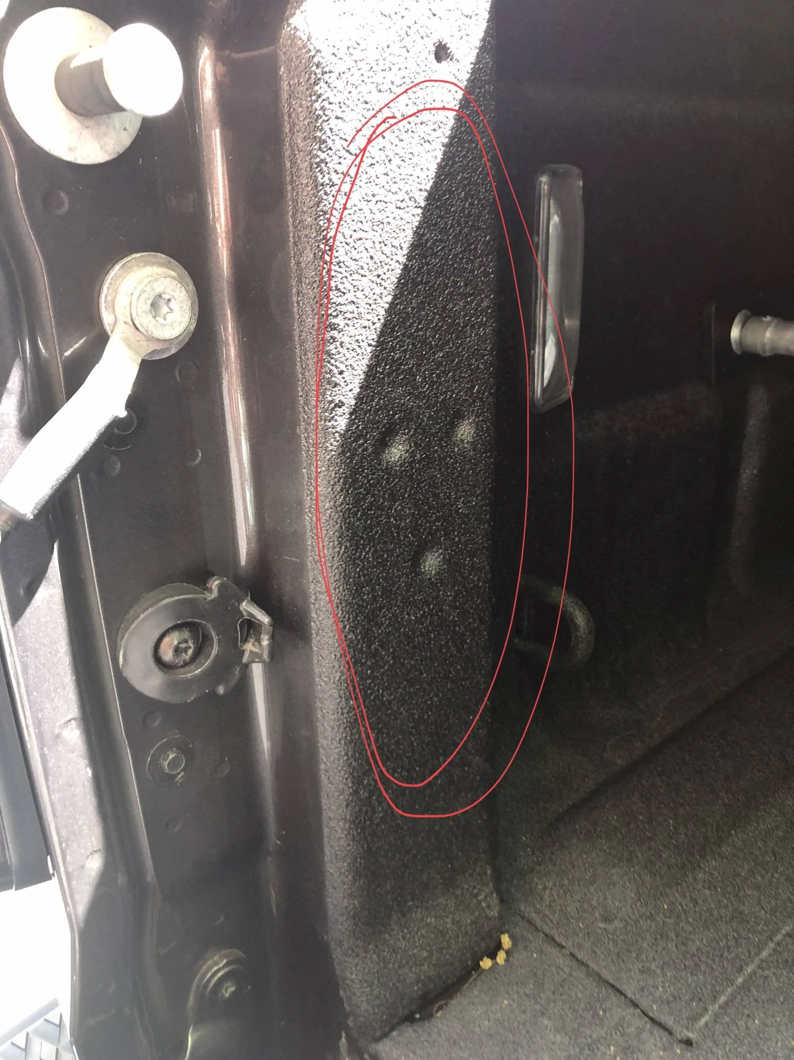

I was wondering if this area is safe to use a nut sert. Thinking about putting a removable flag holder there.

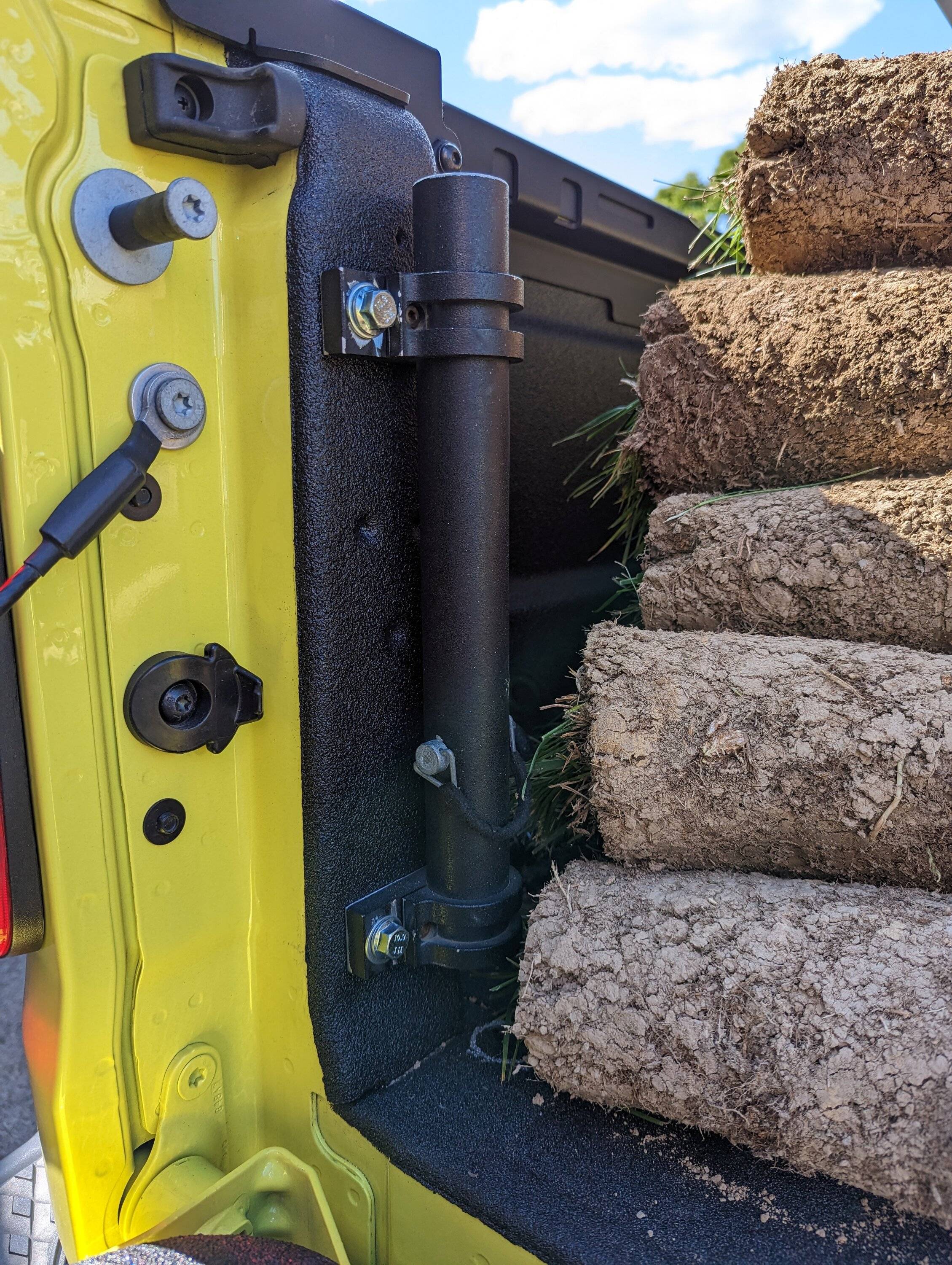

Yes, I have
7/16" drill bit to install M8 rivnuts

Very nice! Using the M8 rivnuts is always a simple way to fasten things to body panels. If you want to ensure strength of the hardware for accessories you might consider measuring the distance between the holes and drill and tap a piece of flat metal with the same distance between the holes. Add the taped flatbar inside the body panel.
