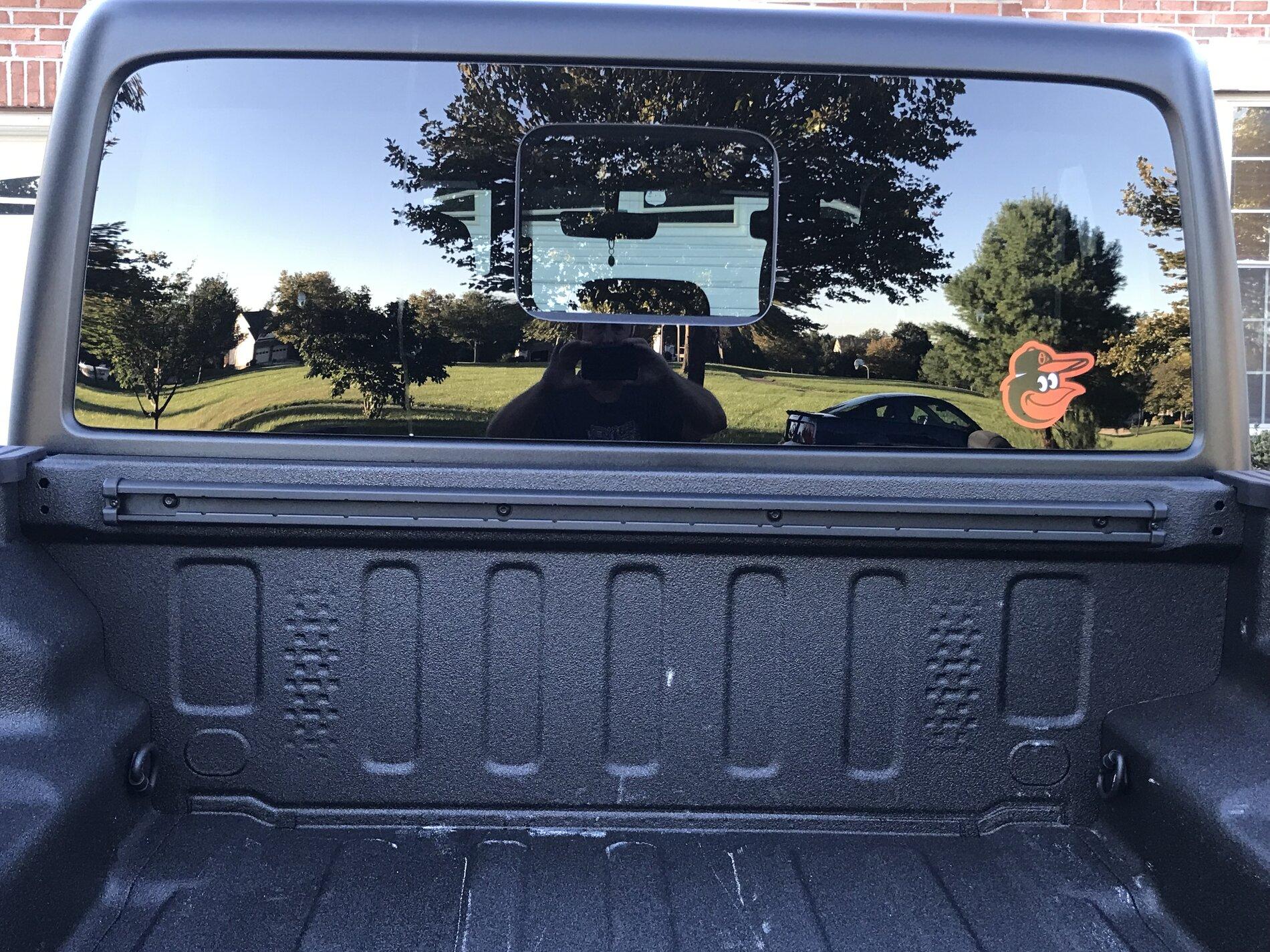

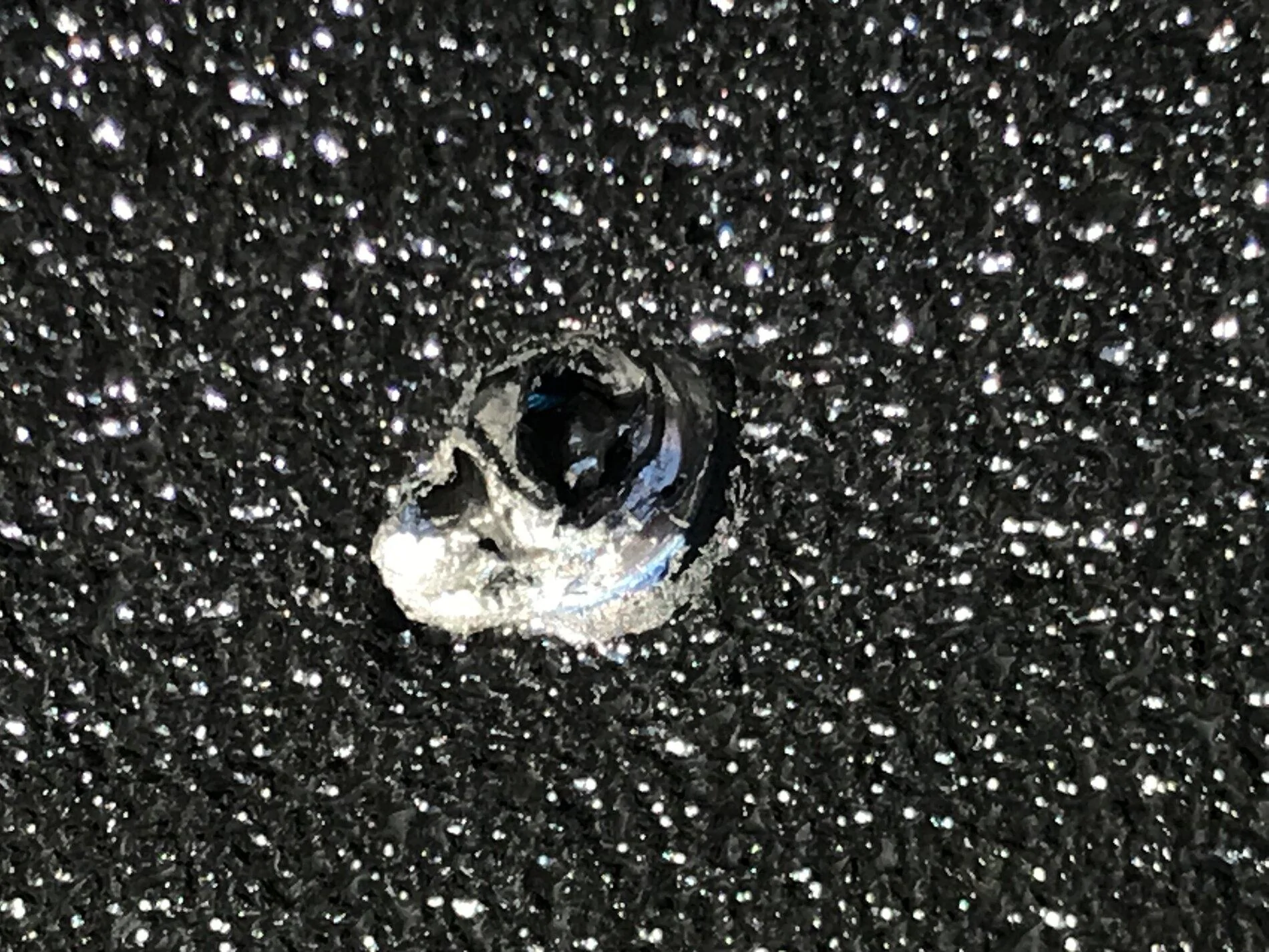

Broke M6 Tap off in the hole for the bedrail
40,514
54,050
Left handed drill bit......... don't want to force it in further and tighter (unless trying to pull it through on the back side)
Yes, there is such a thing. Reverse the drill, use a left handed bit, that way if the bit catches or snags the tap, it will pull it back out since you are likely using a taper tap. - easier to bring it out than further in.

So it is definitely cross threaded. I used a cordless drill and I should have been using a manual tap. I also used these Milwaukee comb drill/tap bits. I purchased straight tap bits and a manual tap for the other 11 holes. As for this one - Been drilling it out with cobalt bits going slow. Got outside my knowledge base on this one and got caught. Feel like a ?........... Don't they have a donkey icon?
Thanks for all the input. I'll post when I get it done and the bed rail is mounted.

I didn't pay attention to them before I had bedliner sprayed in. But if they are nutserts they could possibly be drilled out (think like a regular rivet) and a new nutsert installed.

Drilled through, missed the center of the welded nut to the right. Tapped the new hole 6m and it is installed. Once I figured out how to use the tap (by hand) the rest was a snap.
Thanks again for all the input.
