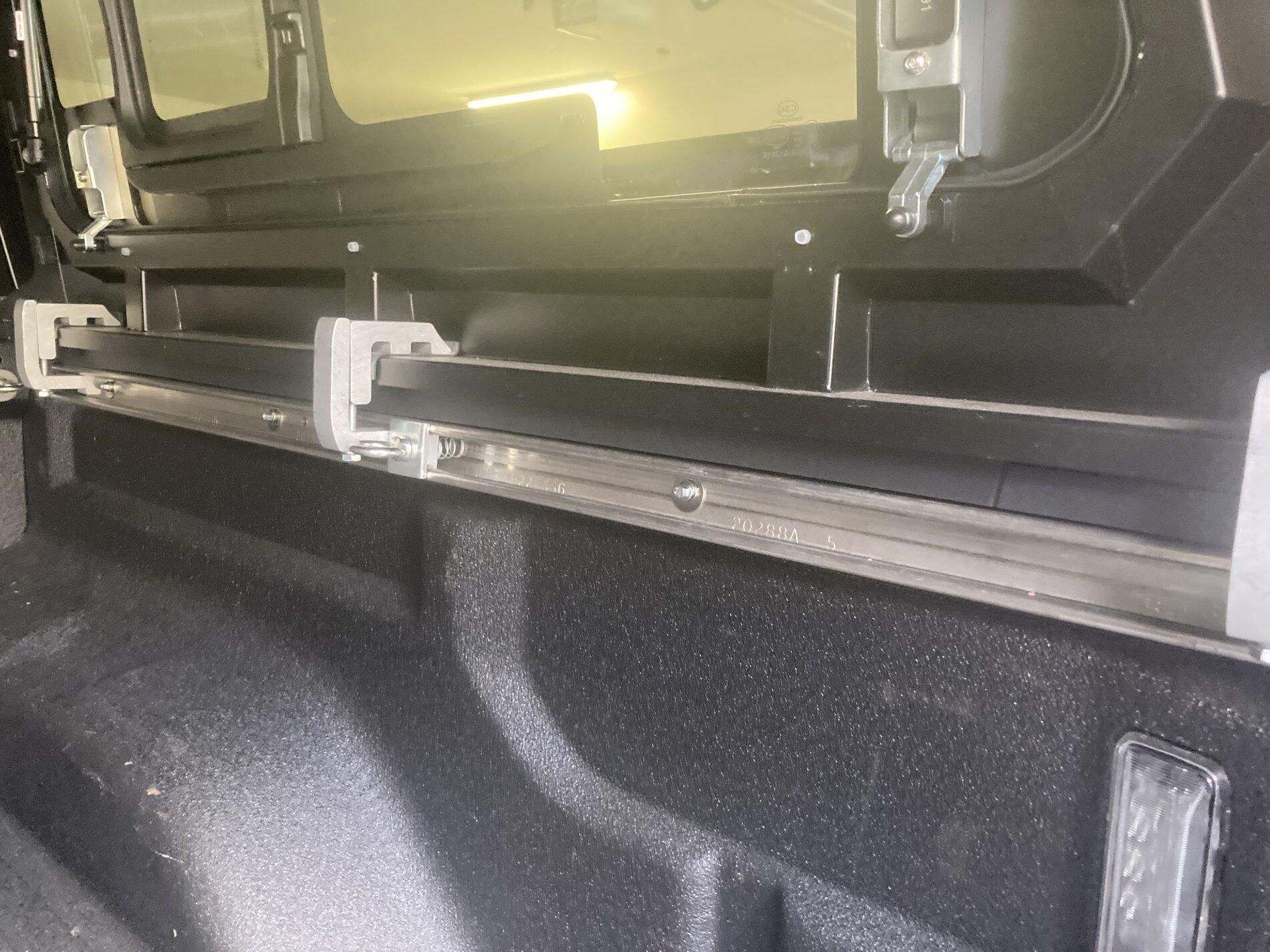

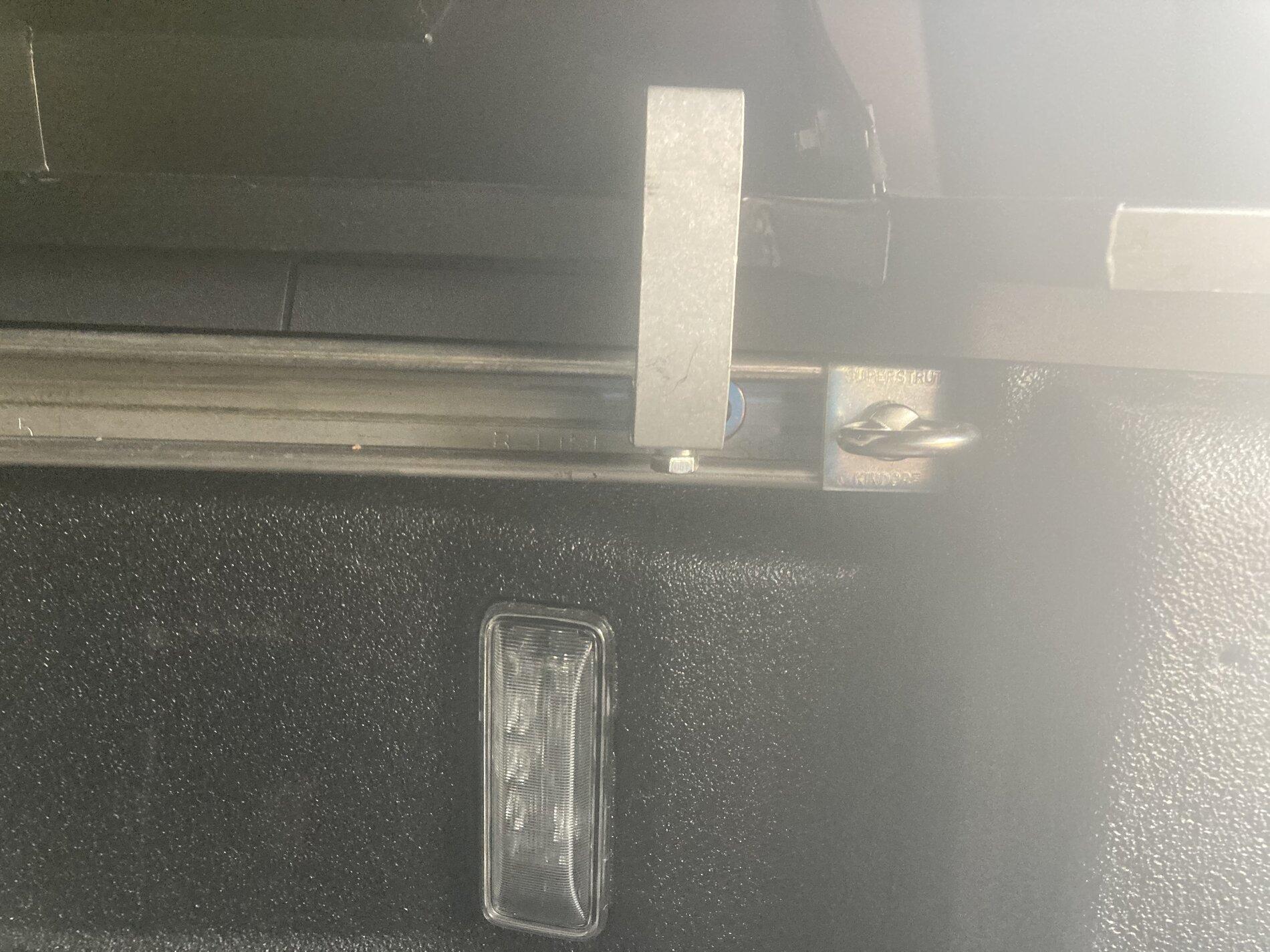

I got shoulder bolts from local Ace hardware store in stainless, I only did the sides and put two 3/8” eye bolts in large side corners at front, just figured one day I would be pissed trying to fit a five foot box in bed of truck that wouldn’t fit with a rail at front of bed……Jack
Jeep Gladiator For the trail rail/unistrut guys....what depth M6 screw to mount into bed? DA50A367-F02B-44F9-BDD7-3B03487BEFCE
Jeep Gladiator For the trail rail/unistrut guys....what depth M6 screw to mount into bed? 2BFF9B08-9C16-4432-B606-685F6DCBBAED
