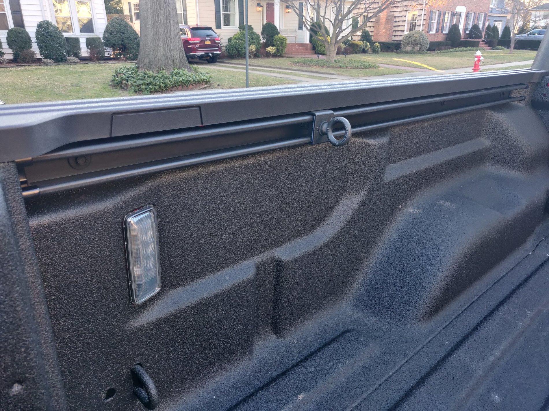

I ordered all my hardware from McMaster Carr. In my opinion, this DIY trail rail system turned out better than the Mopar system. I had to notch out a few spots on the slotted struts to match up with the holes in the bed, but otherwise easy install. I just installed the hi lift jack mount system using the 3/8" -16 thread strut channel nuts with springs. The strut channel nuts that come with the hi lift mounting system are meant for the Mopar trail rail system and don't work with these strut channels, as they aren't wide enough to hold. I ordered a couple more strut channel nuts and sit-on-top channel washers so I can put the ring eyelets back on that side.

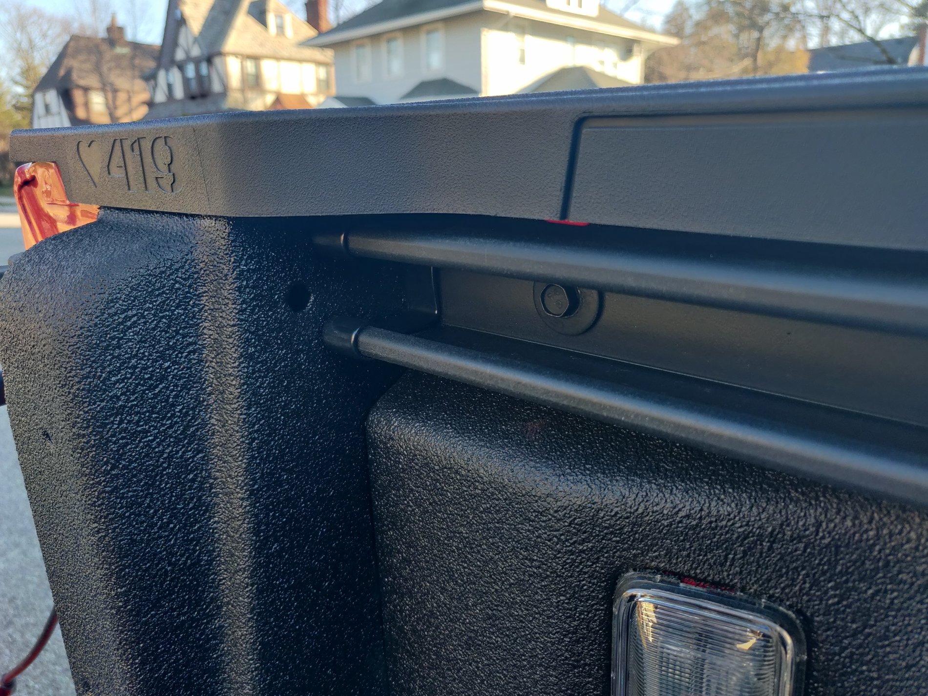

Like some others, I decided to build my own bedrail system out of unistrut. I think it came out pretty OEM looking.
I purchased all of the material from McMaster Carr for about $130.00
In addition to the material listed, you will need some M6 1mm x 25mm long screws and some rubber washers for the lifting eyes. I also put some polyethylene that I had laying around from making table saw jigs on the back of the runner.
Future Design Notes
  • I am going to remove the springs from the strut channel nuts because they make it difficult to re position the slider.
  • I ordered some custom stainless ratchet straps in red to match the truck.
  • I am working on a fishing rod holder that will use knobs to attach to the rails.
  • I am working on a bed divider system that will attach to the rails.
