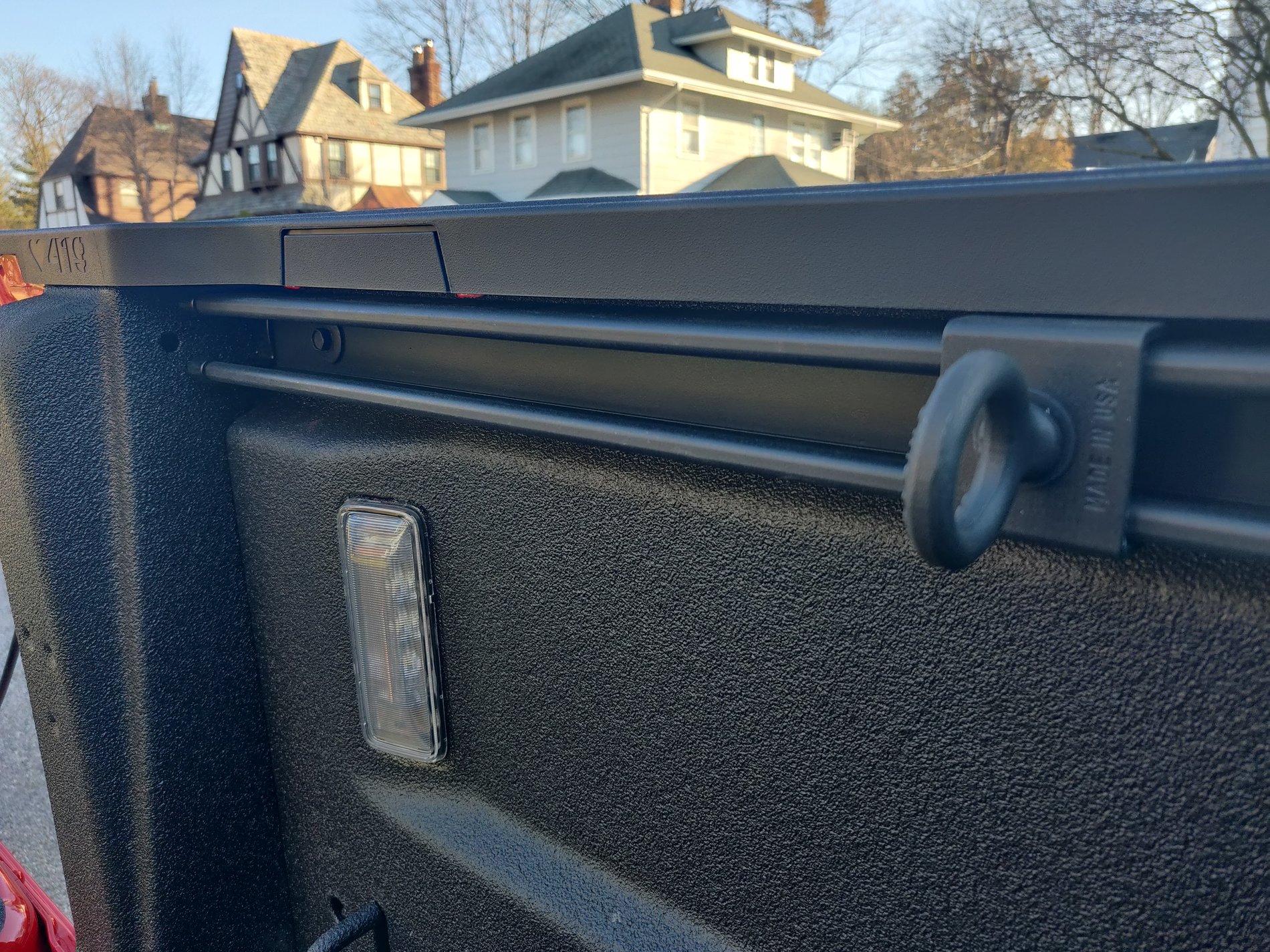

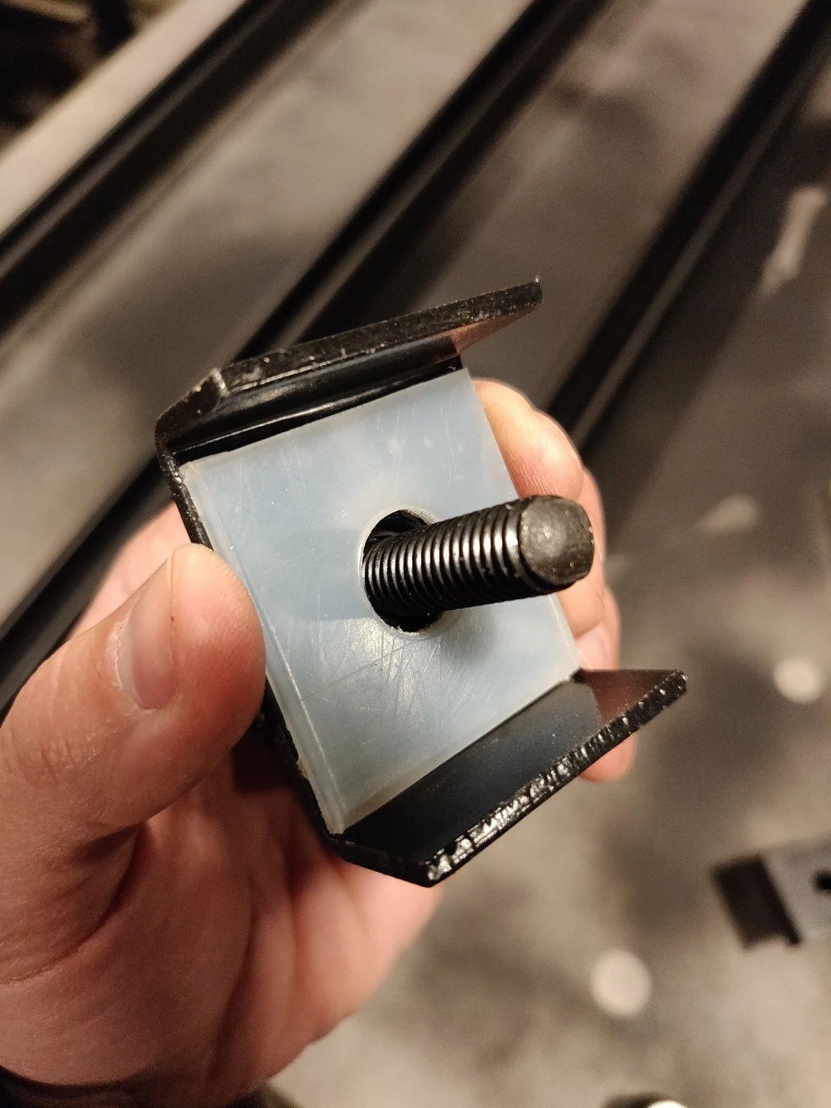

Took a lot of your advice to make my tracks except used home depot unistut that I cut to size and painted. How did yoh attach plastic to washer. Looks like a good idea to protect paint.

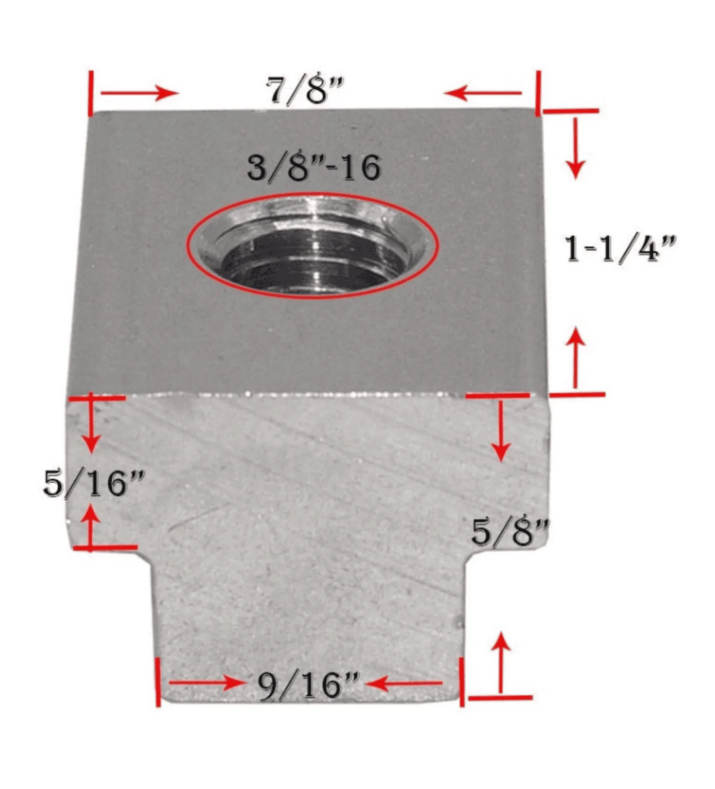

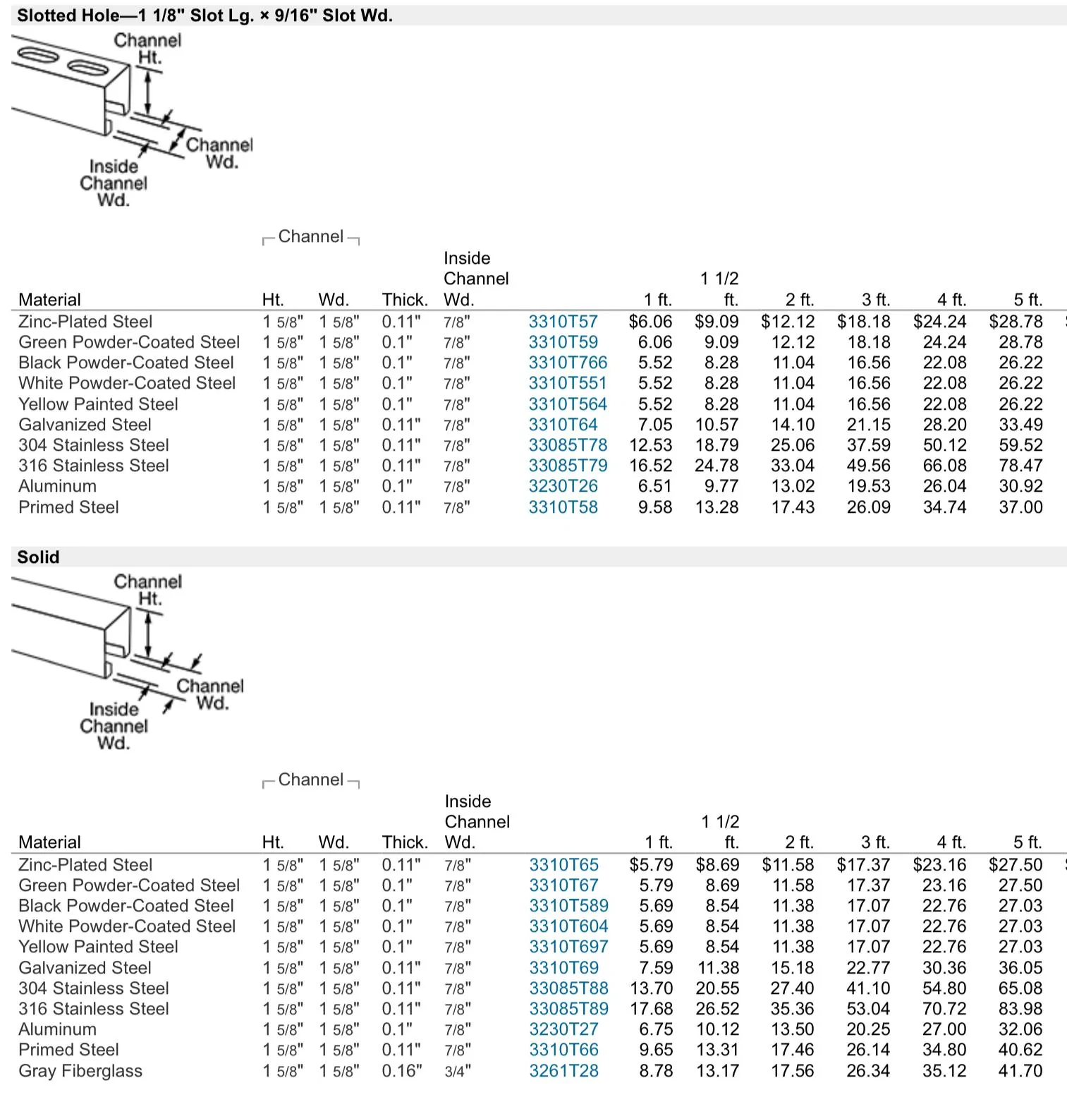

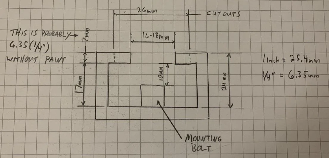

@kosmos - It would be nice to have all the bed rail systems in one post for comparison of measurements - could you measure the inside of the channel and slot to add to the list. I’ve linked below the McMaster DIY info along with the Mopar trail Rails.
6.35mm= .25= 1/4
10mm= .394= 3/8
16mm= .629= 5/8
31mm= 1.22= 1 1/4
Link:
https://www.jeepgladiatorforum.com/...or-me-gladiator-rack.27705/page-4#post-458355
McMaster rails

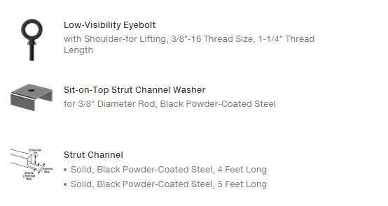

I ordered parts to make bed rails a few weeks ago and just got around to installing them today. Here are some lessons learned from me that might save you some time:
  • The posts show four-foot and five-foot channel rails. For whatever reason, I inferred that meant the bed was four feet wide and five feet long, so I ordered two five-foot channel rails and one four-foot channel rail. You need three four-foot channel rails. I spent a lot of time cutting my five-foot channel rails down.
  • I ordered the solid channel rails instead of the slotted, so I spent a lot of time measuring, drilling, and then widening the holes for the bolts because I did not get them drilled in the exact right spot. I recommend ordering the slotted channels.
  • I left the strut channel nut springs in initially despite the advice to remove them. After realizing how difficult the springs make sliding the eye bolts, I removed them. I recommend removing them from the start.

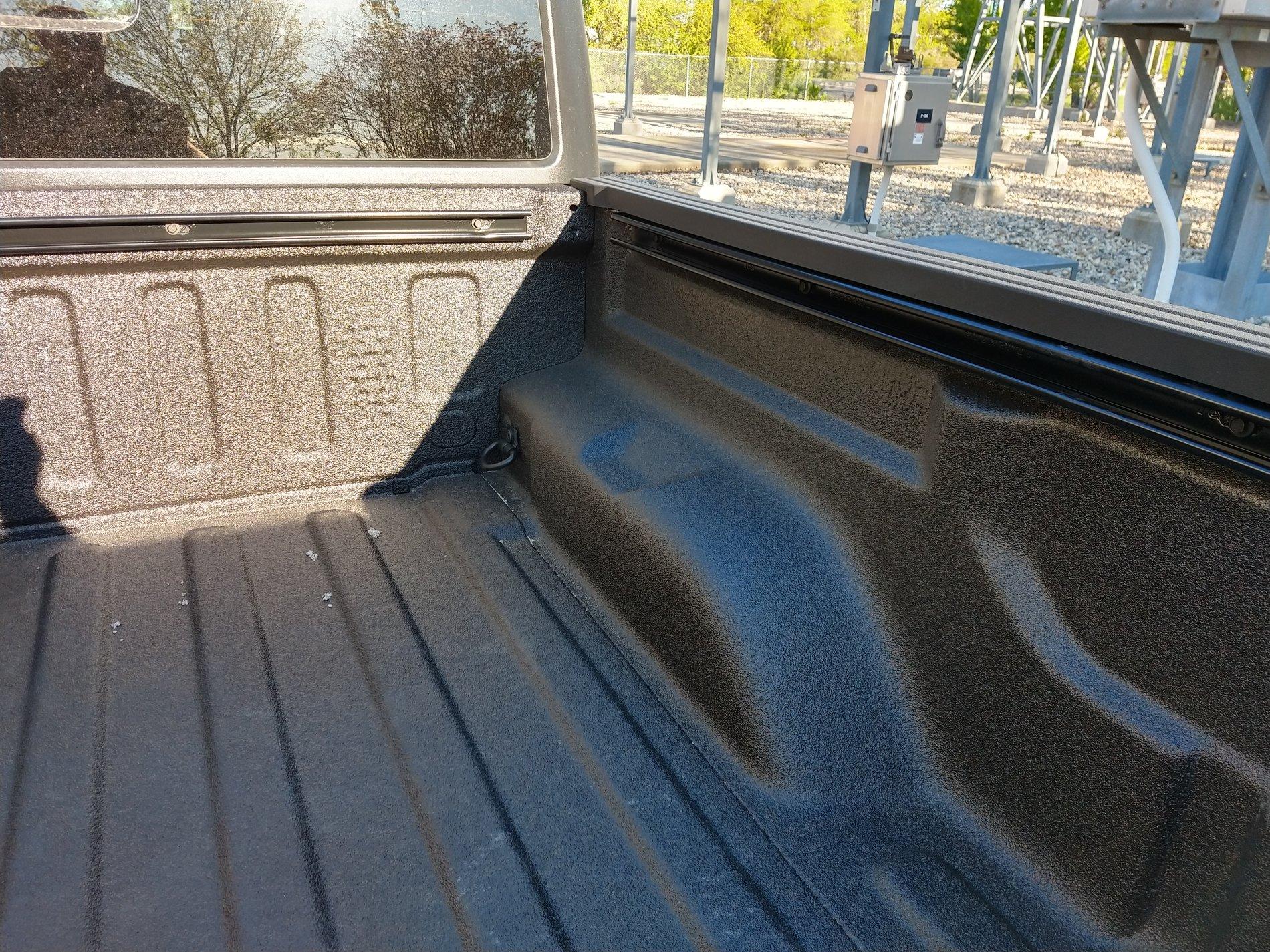

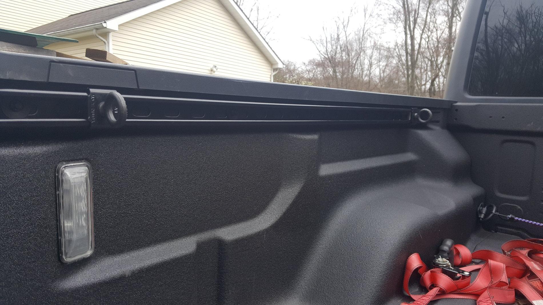

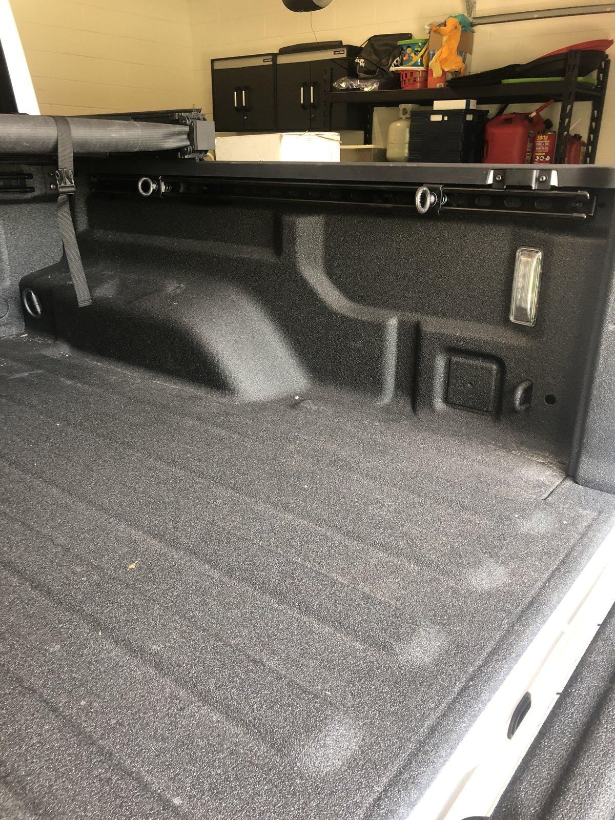

Got my rails back from the powder coater yesterday and installed. Can't find those little strut end caps that finish them off nicely anywhere up here in Canada though

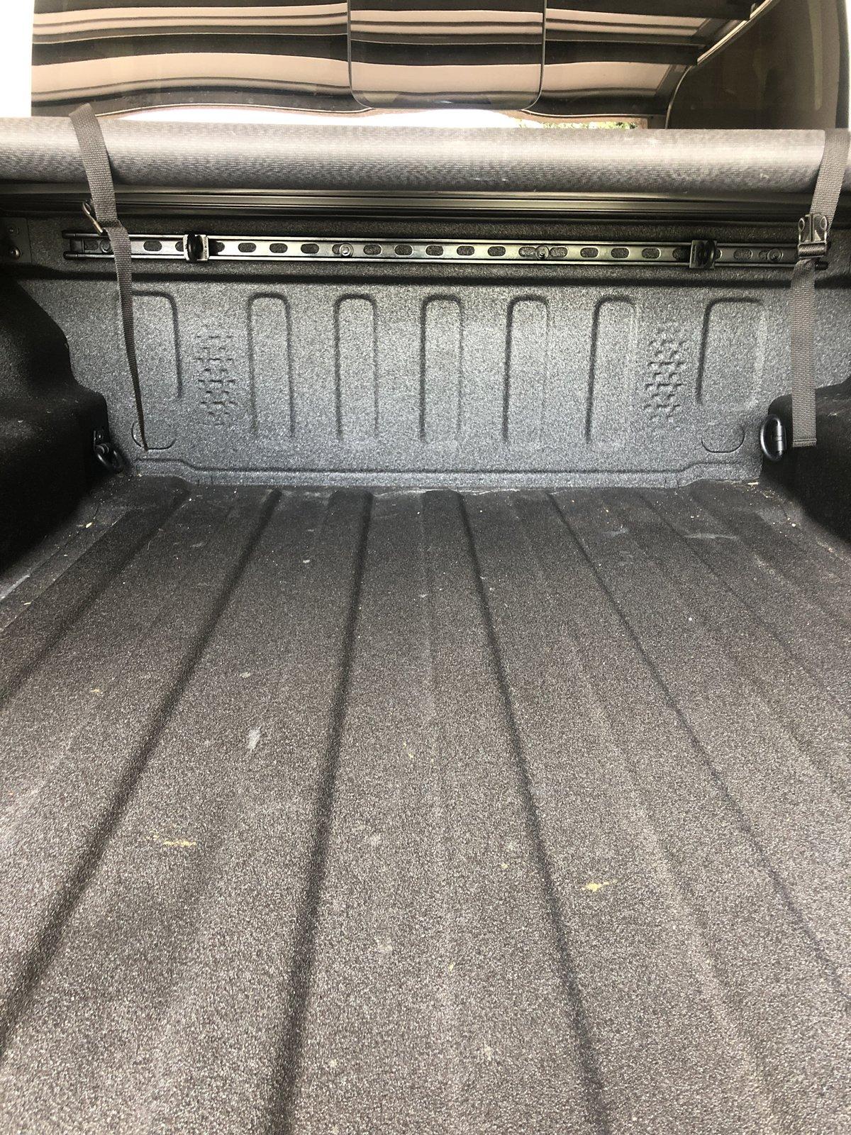

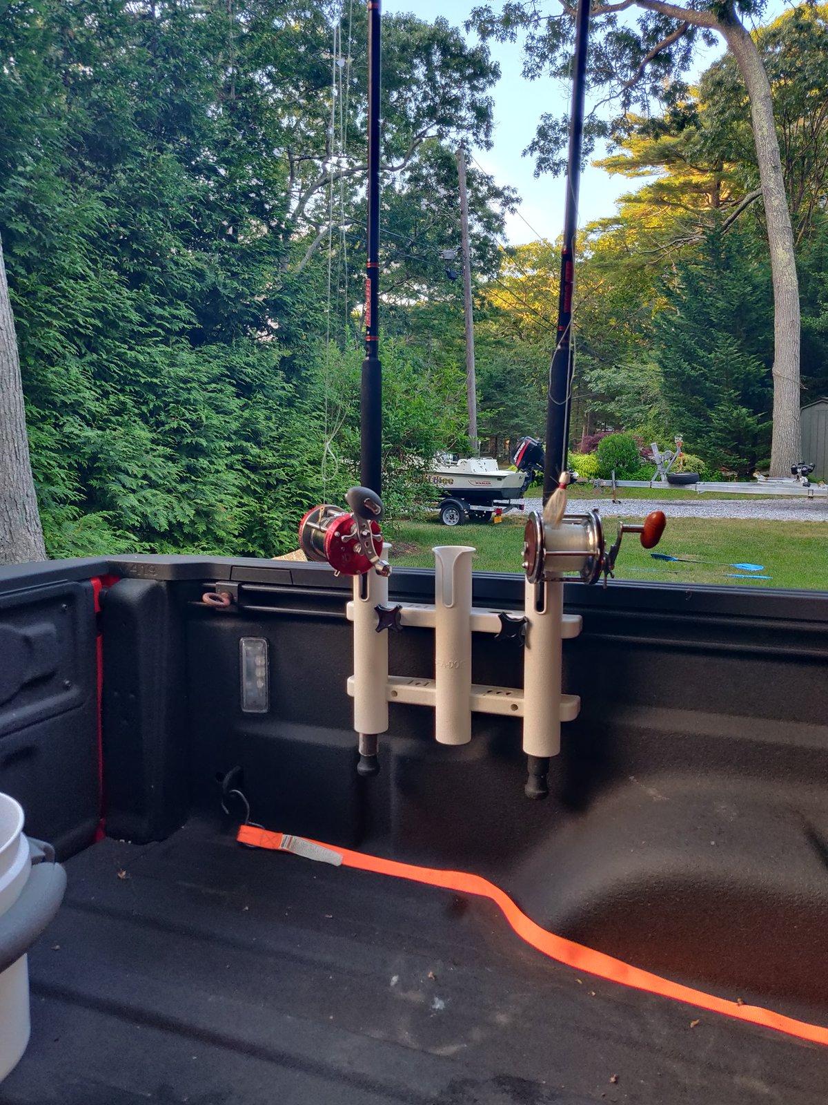

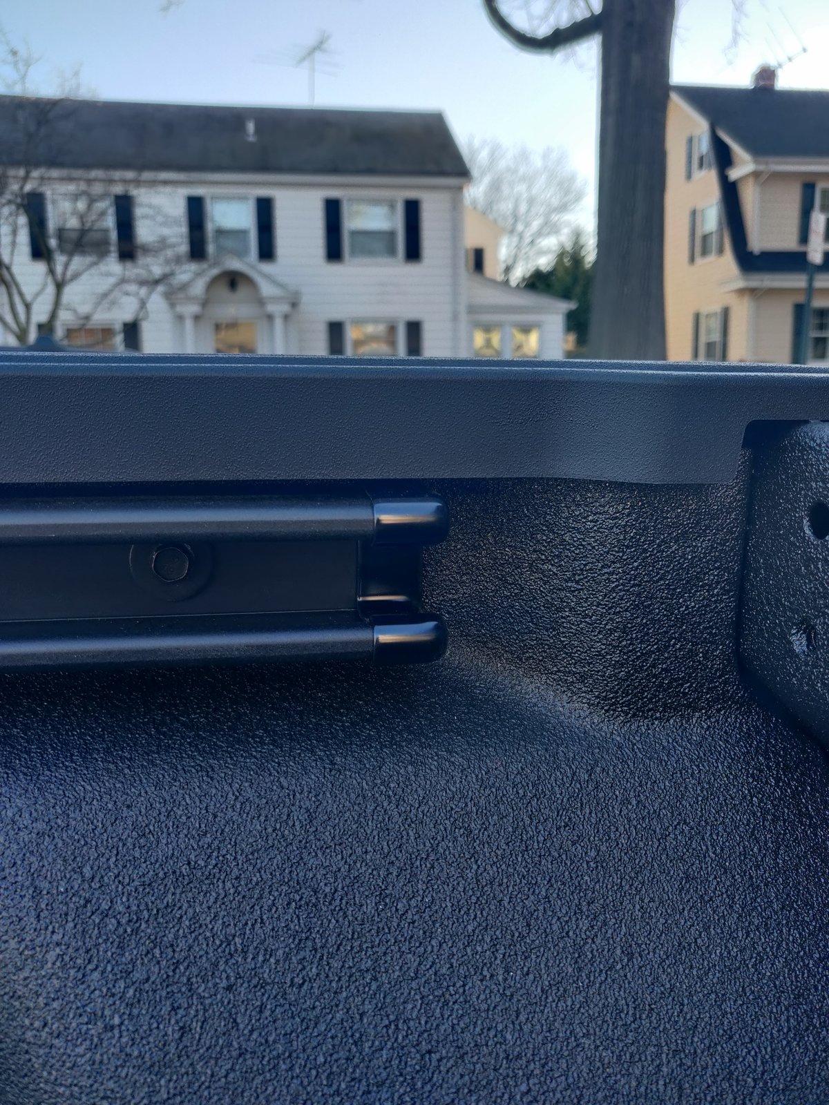

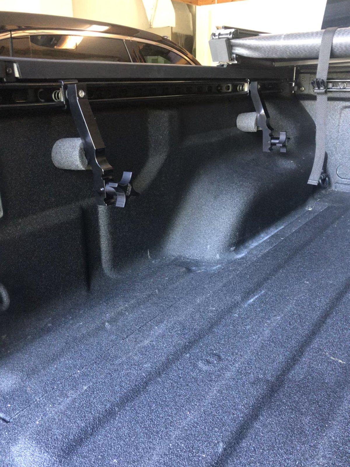

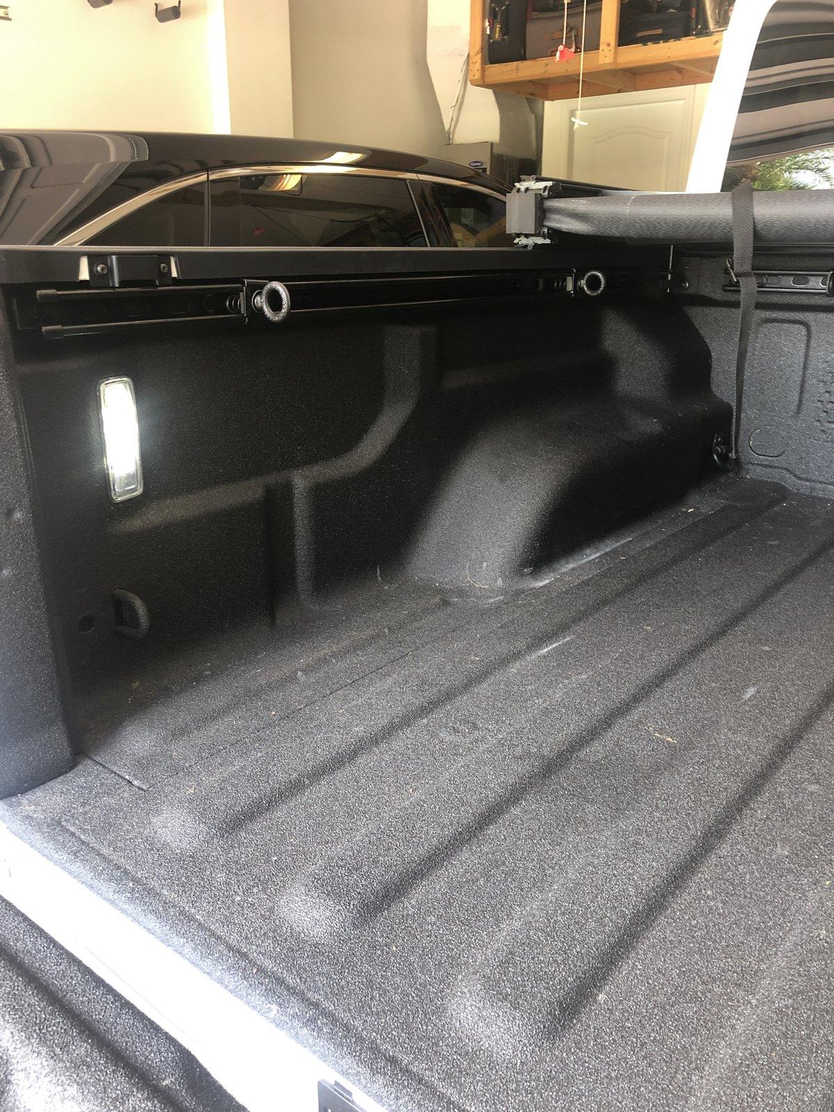

I ordered all my hardware from McMaster Carr. In my opinion, this DIY trail rail system turned out better than the Mopar system. I had to notch out a few spots on the slotted struts to match up with the holes in the bed, but otherwise easy install. I just installed the hi lift jack mount system using the 3/8" -16 thread strut channel nuts with springs. The strut channel nuts that come with the hi lift mounting system are meant for the Mopar trail rail system and don't work with these strut channels, as they aren't wide enough to hold. I ordered a couple more strut channel nuts and sit-on-top channel washers so I can put the ring eyelets back on that side.
