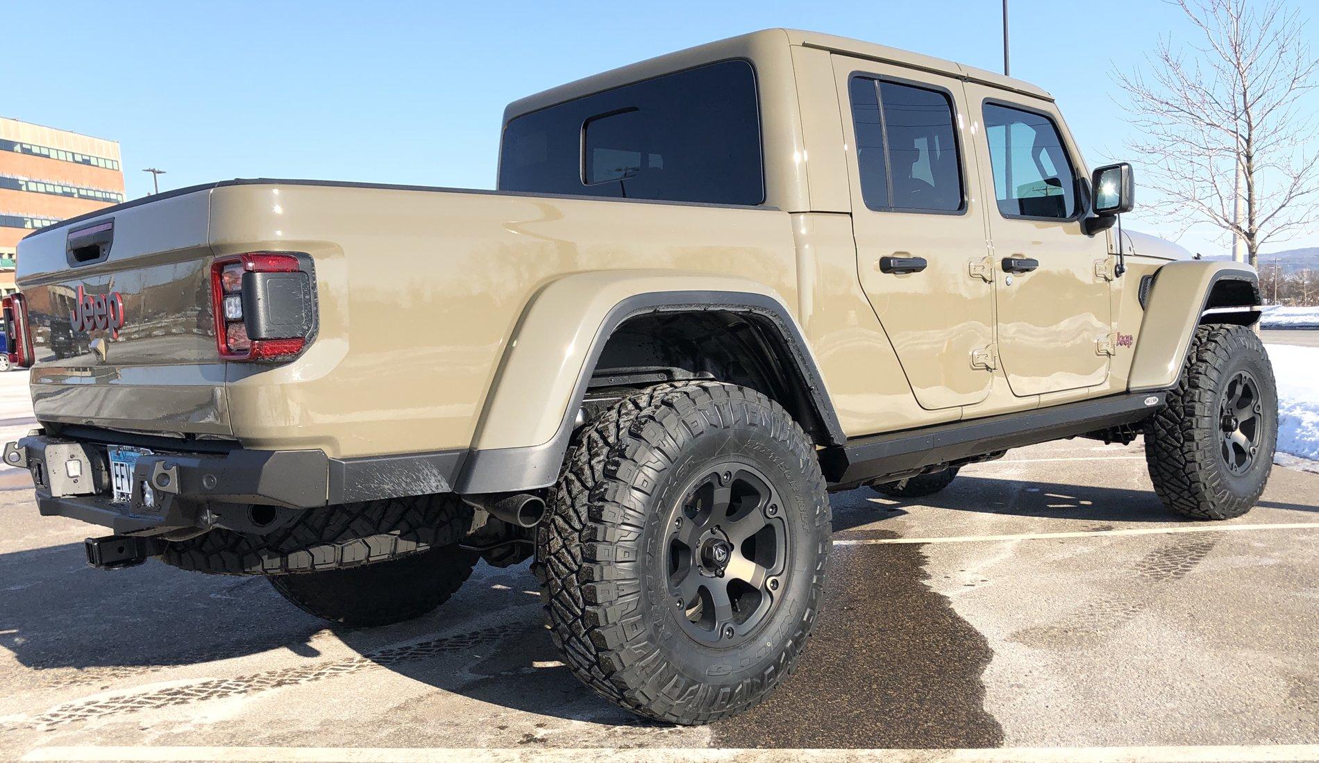

I'm thinking about doing that - cutting it off where it turns downwards right around the shield next to the spare tire (see pic)...

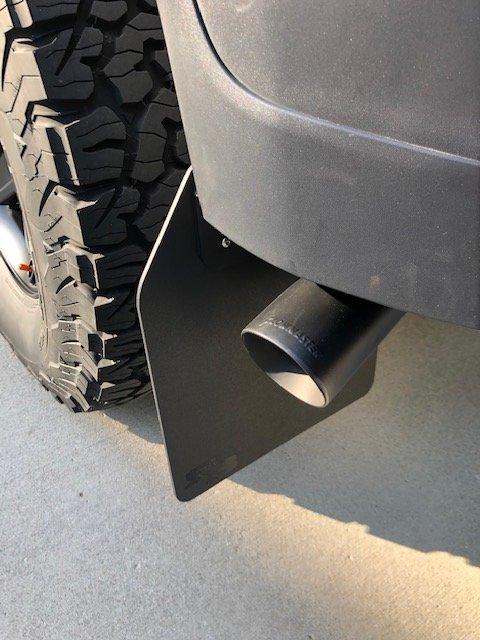

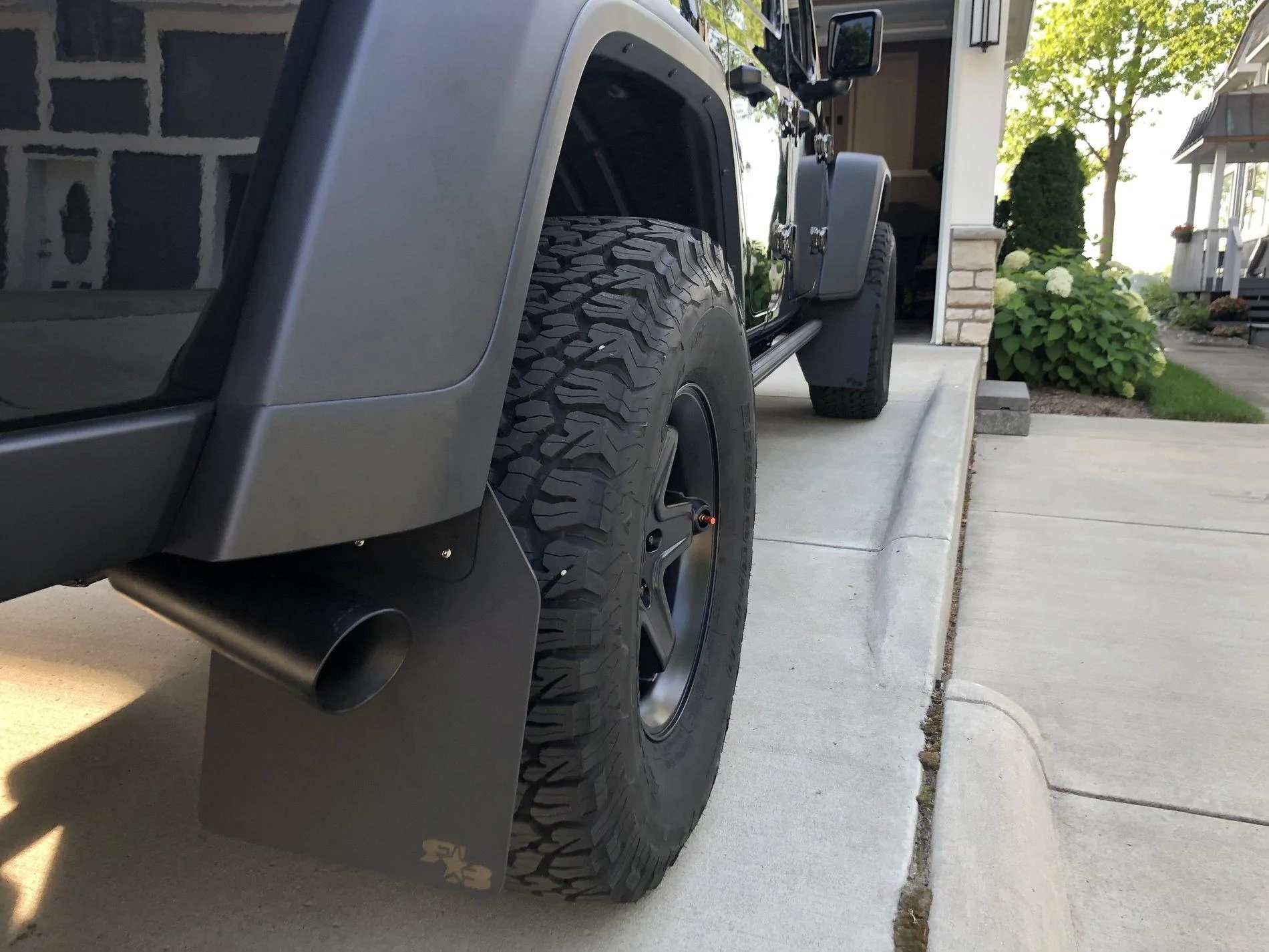

I purchased the Mopar performance exhaust and have to admit it may be the only thing I am on the fence about. First...the out of the box, square, out the rear set up was in my opinion both ugly and non functional (again just my opinion). Second...I am not sure I love the tone of the exhaust. Yes I know it is not a V8 but I was hoping for a little lower tone. Note - I have bad hearing loss so my hearing aids may be part of the issue.
Probably not much help but here is the original out the rear, dealership install and then the new, behind the wheel work I had done at an after market exhaust shop. I relocated as I did not like the look and feel it is highly unlikely I would crush the tips in the current location. I would most likely hit my spare first. If I smash them now it will be the least of my issues. :)

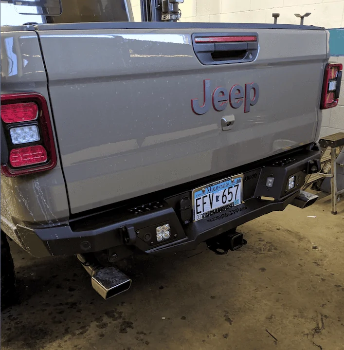

I went with Flowmaster and I think it sounds fine throughout
Jeep Gladiator Anyone thought about dual exhaust on new Gladiator? Magna Flow or Flowmaster? Exhaust and fla
Jeep Gladiator Anyone thought about dual exhaust on new Gladiator? Magna Flow or Flowmaster? Flap and exhaust
the rpm range. Also a truck exhaust should be out the side not the back.
