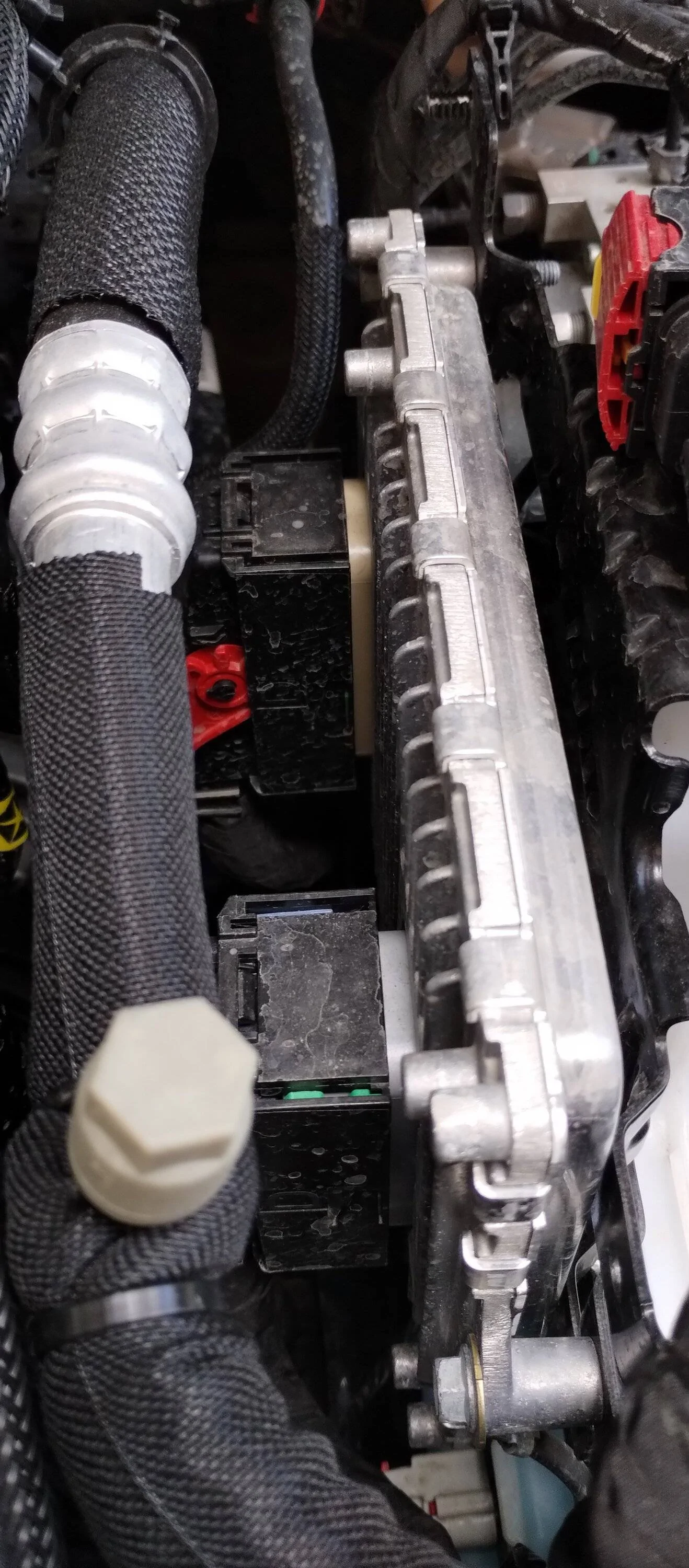

Between rev hang, throttle lag, and rumors of FCA detuning 6MT vehicles due to the clutch recall, I am considering a tune. Does anyone here have any experience with a tune on a manual transmission?
I'm fortunate enough to have a late 2022 build with the GSPEC2A.

*GPEC2A

Yes that is the GPEC2 .. the GPEC5 has the connectors on the TOP Edge; not the flat side like the pictures.. To Date; I have NOT Found anyone that has/can unlock the 5. (which BTW came on my 21 Mojave)

This is new info to me.. what’s the difference in GPEC2 vs GPEC5?
