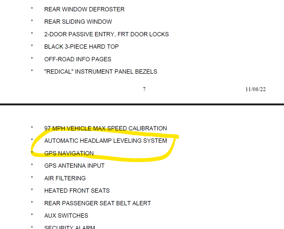

  • I have the LED headlights etc- the manual states the headlights are self levelling – so do I assume no adjustment is required after the spacer install ?

Not sure on the headlights, but if they say they auto adjust/self-level, you shouldn't need to manually adjust them after any lift. Cool feature if they do it automatically.
Yeah, pretty cool feature , our other 2017 Toyota has them also
No mechanics around the headlight them selves for adjustment , I hadn't realised till I had her apart adding a light bar then checked through my build sheet
