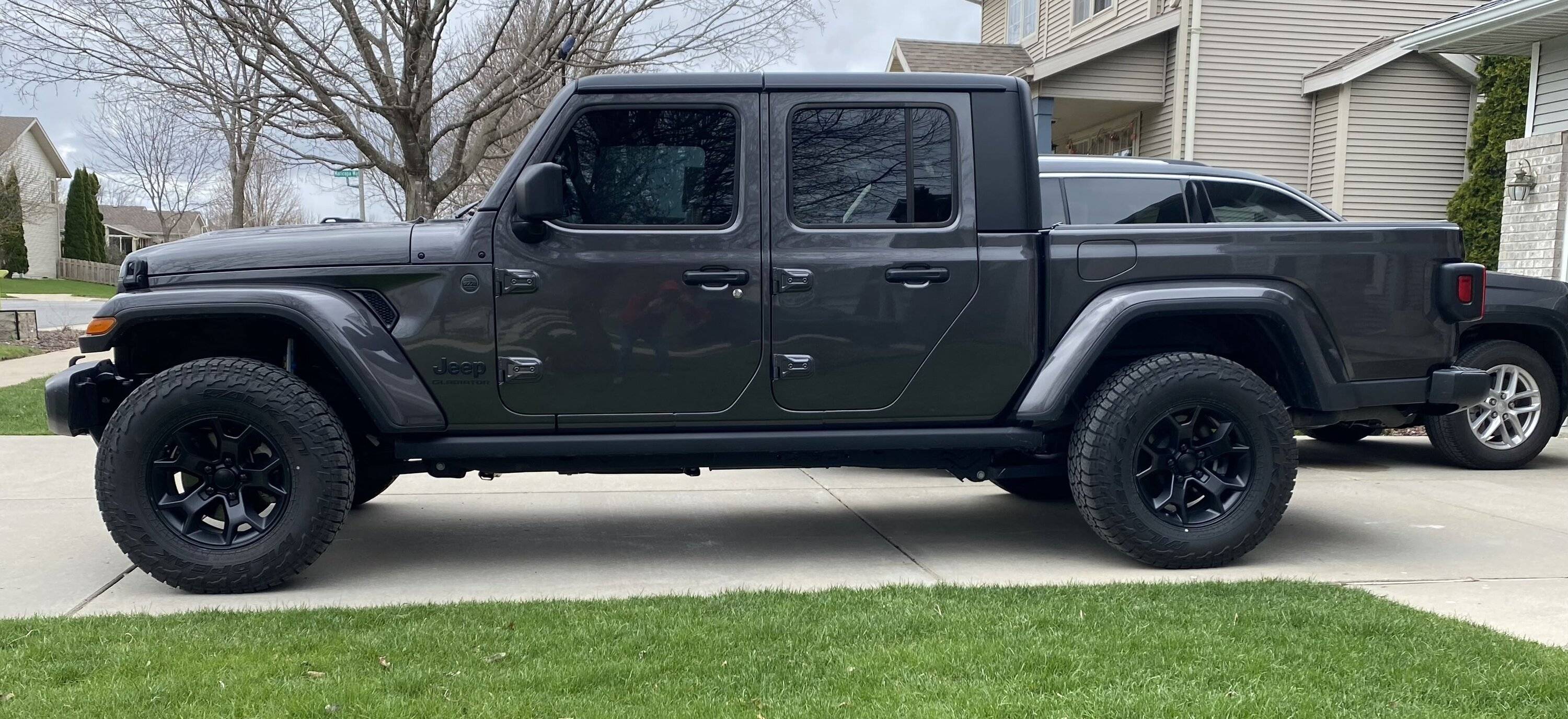

I had a lot of rake from factory with my 80AE Gladiator. I added the 1.5 Teraflex level to the front, Mopar LCA’s, and nothing to the rear.
I still have some rake, maybe 3/4, and I’m ok with that.
For reference, my tires are 34ā€.

what a gorgeous color, what gives you a small rake still, bumper?

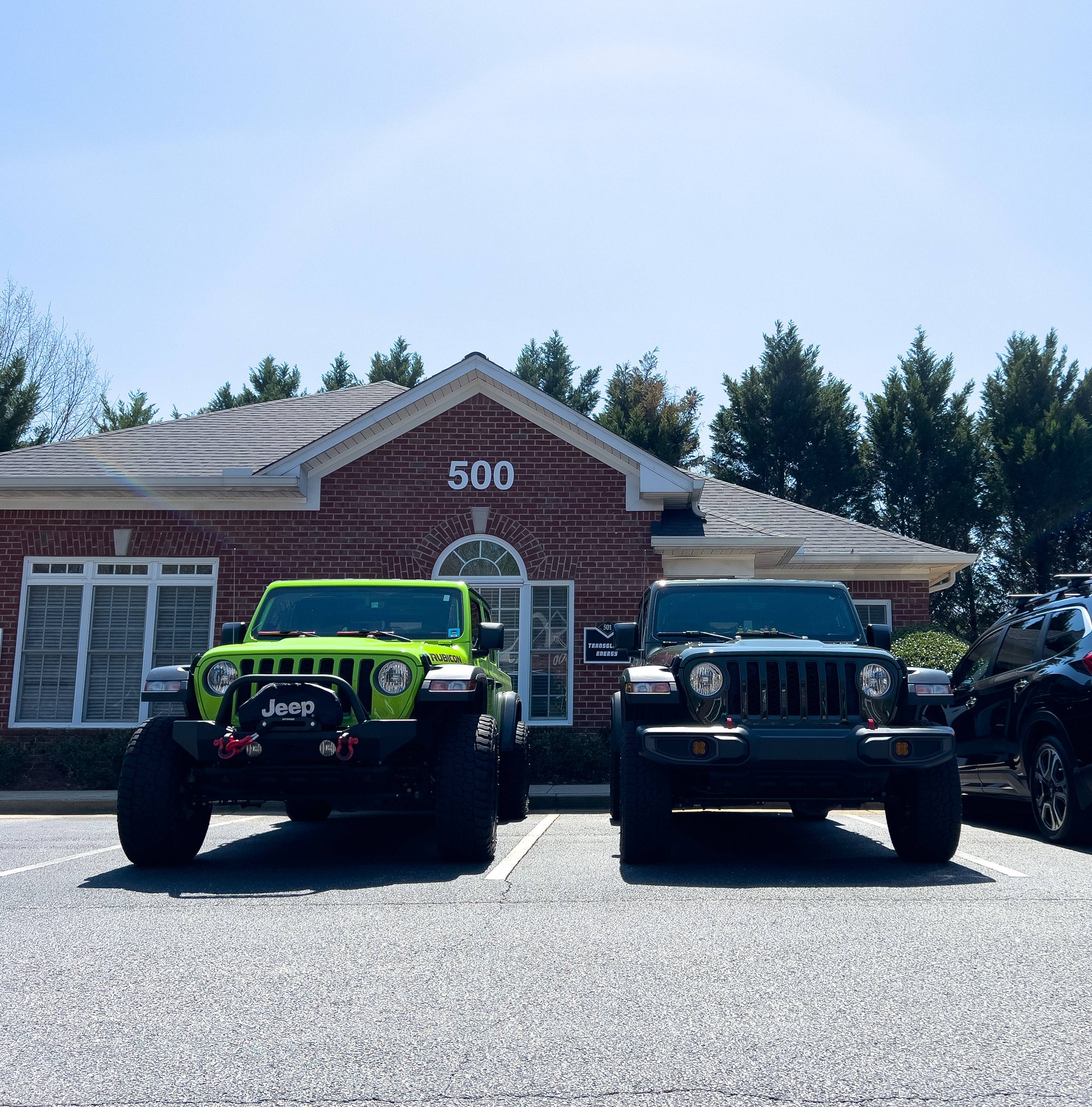

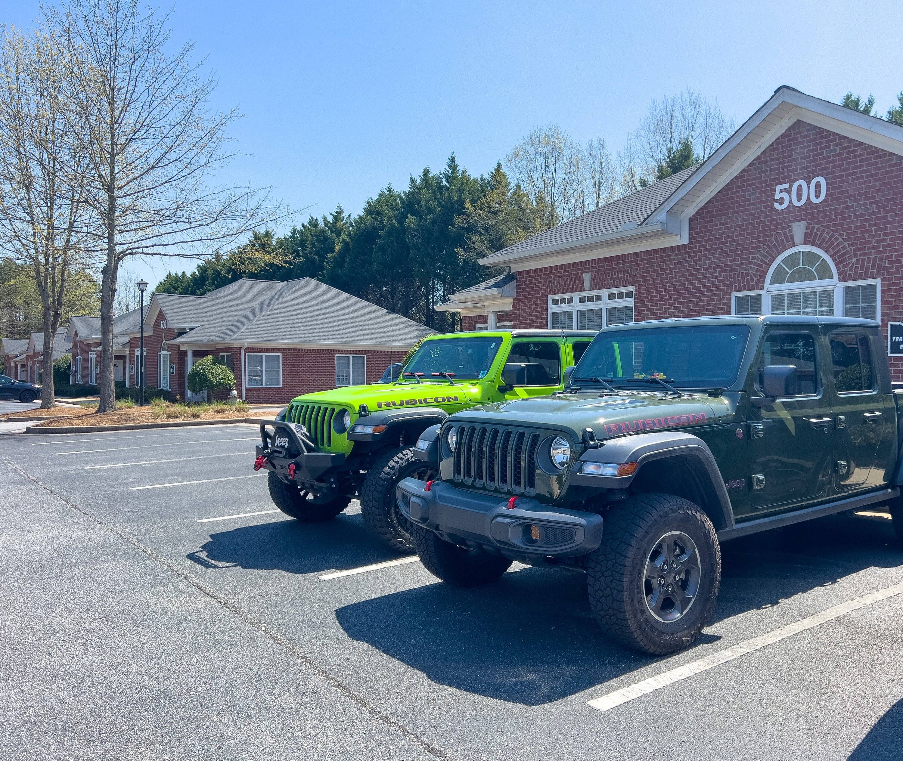

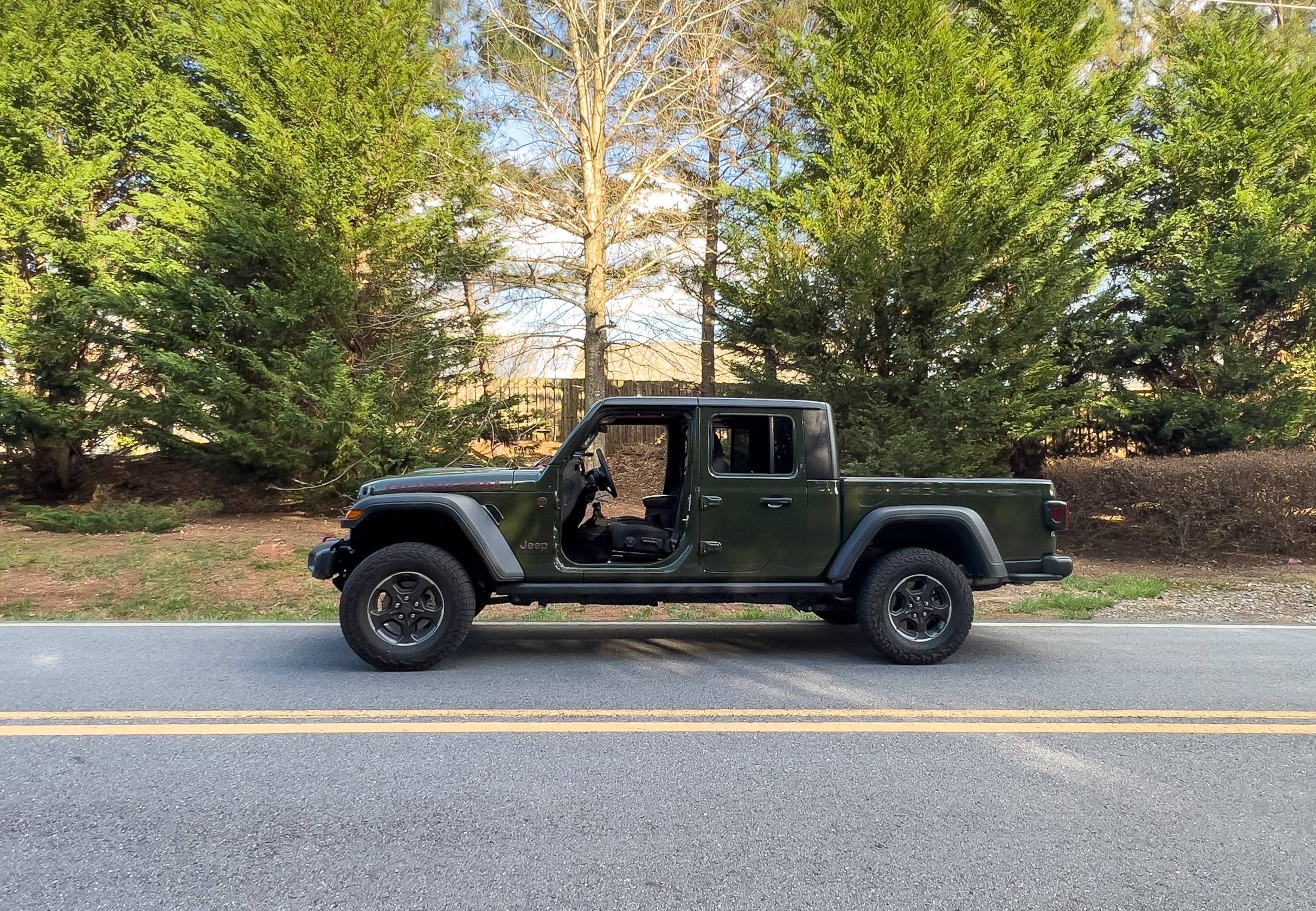

This is a 23 rubi w/ the full 1.5 on the front. I am on a *SLIGHT* incline in the 1st picture:
The following pictures are my rubicon next to a jeep on 35s, not sure on their lift setup:
Jeep Gladiator Tera Flex level kit? Yes or no jeep_5
Jeep Gladiator Tera Flex level kit? Yes or no jeep_8
Jeep Gladiator Tera Flex level kit? Yes or no jeep_9
I am dead nuts leveled front to rear, if there is any difference, it is small enough that rough measurements didn't catch anything. The directions and general consensus is you do not need a track bar, my scenario did not line up with this. Driver axle is about 3/4" pushed to the drivers side. Does not affect driving manners but just something to keep in mind.
Thanks!
Mine just seemed to have an excessive amount of rake from factory. Idk if that’s common for the 80AE or not. I don’t mind still having some as it does help in the rare event I haul anything.
