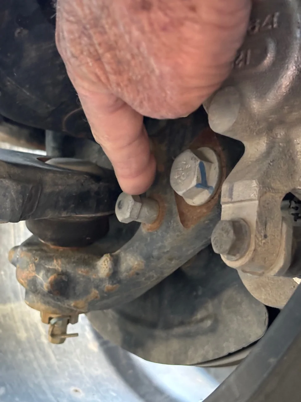

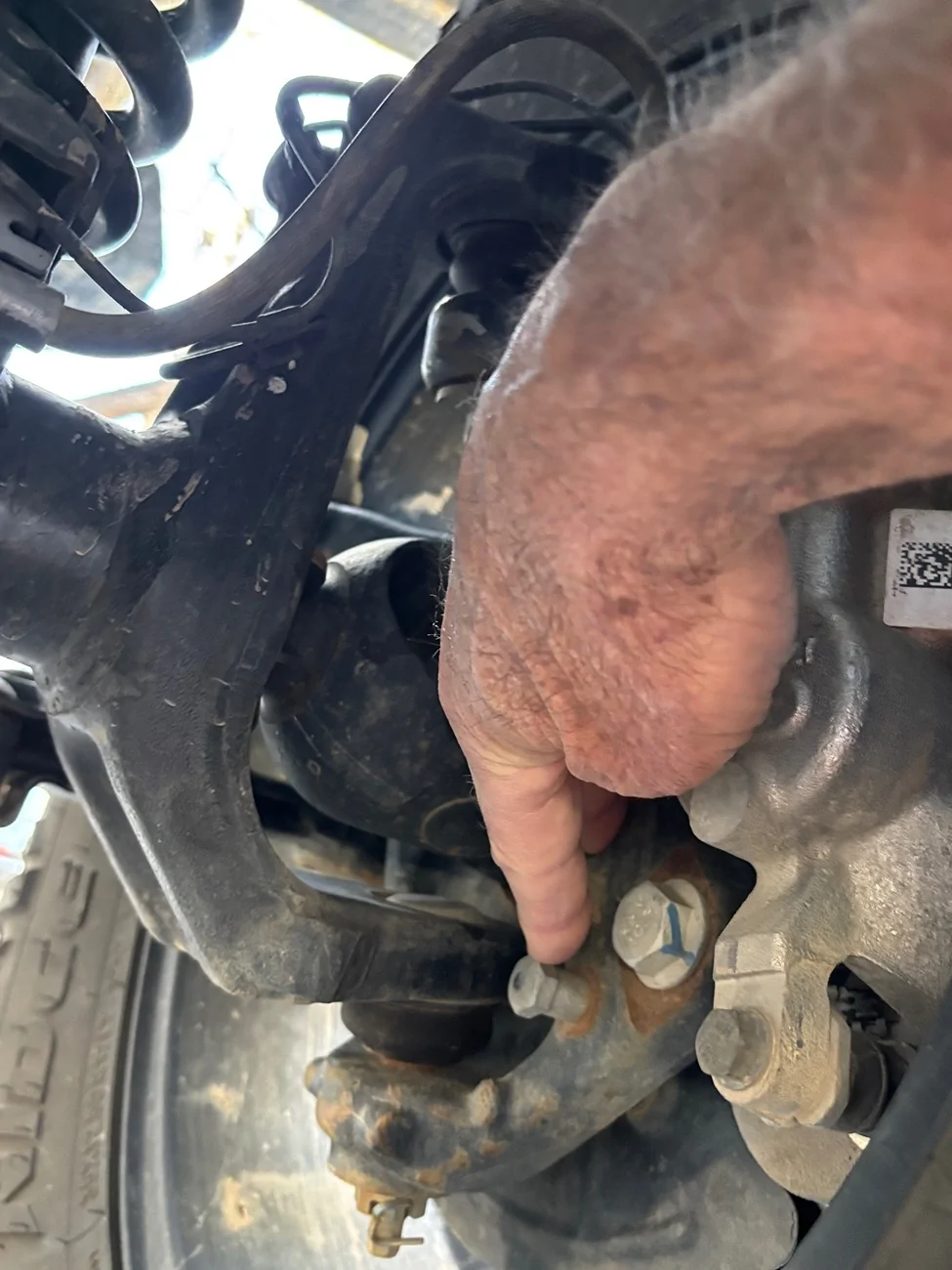

In the attached photos of the passenger side, the bolt I am touching can be adjusted out to decrease how far you can turn the wheel. I searched but couldn’t find previous posts discussing doing this. If I remember correctly you remove the bolt and place washers behind it to shim it to the length you need. Hope this helps.

Thank you very much. I didn't realize you could do that.
