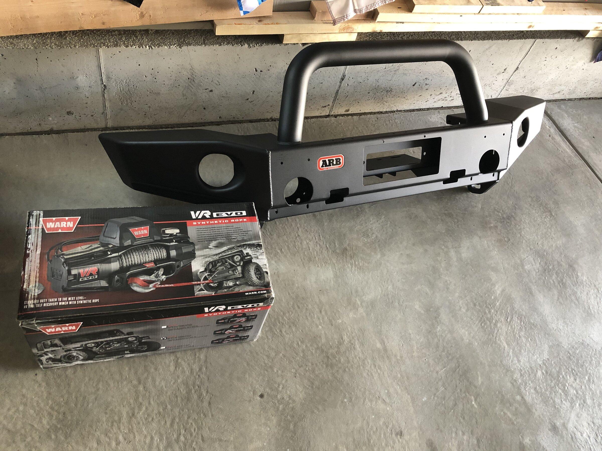

Hello everyone I cannot find a good answer if a Warn evo 10 winch will fit the ARB deluxe bumper. ARBs website does not list it as a option but I’ve seen others such as smittybilts on the bumper. Thanks in advance

The website says the Deluxe bumpers will fit a Warn low mount winch up to 10,000lb. You should be all good.

thanks for the reply! Grabbed a winch this morning looks like my weekend is booked now!

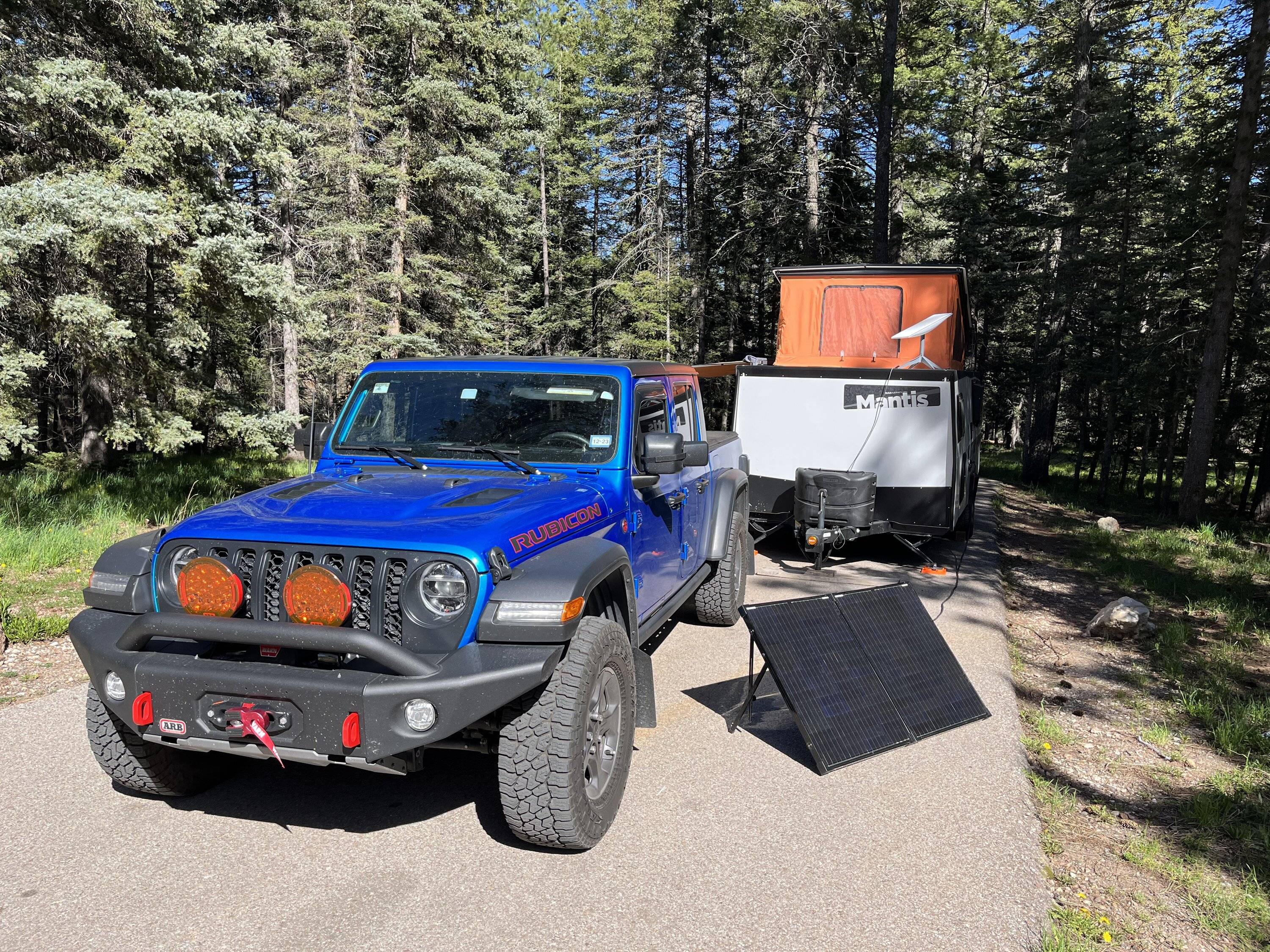

Old thread, but I am facing the same question now. Did the Warn Evo 10 work? That is exactly what I am looking at, and the ARB website and fitment documents don't mention it. It looks like it has the same winch plate bolt pattern as the Zeon 10s (which ARB does validate works), and the EVO is smaller in width and height. I am hoping this worked

Yes , that is what I have installed on my jeep.

Yep fits great no issues.

Interesting that I had a mild panic attack today when the shop called me to tell me that my new Warn Evo 10S was not fitting with my new ARB bondi deluxe bumper. I spent about 30 minutes on the phone with ARB technical support and while they did not confirm that specific winch, they did indicate it "should" work. While on the phone with ARB, my shop texted me and said disregard, the winch fit fine. I'm picking up the gladiator tomorrow morning and will send pictures.
Side note, ARB also gave me a heart attack when they told me that bumper was not compatible with the Mojave. After about 10 minutes of additional research they came back and told me they were incorrect and that it actually did fit the Mojave. So for about 30 minutes I was trying to figure out how I was going to return a 170 lb bumper and 50 lb winch lol.

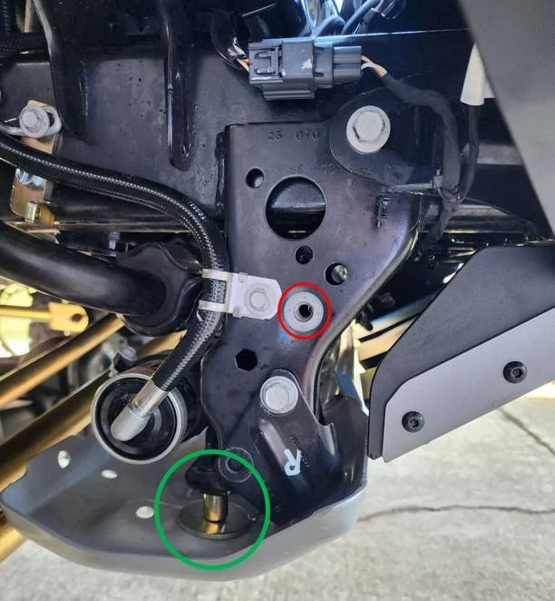

Ok, just got the JT back from the shop. Can confirm that the ARB Bondi Deluxe Full length bumper and included skid does work with the 2023 OEM Mojave skid with no trimming. With that said, you do have to move the OEM skid to a lower pre-existing hole on the frame for it to clear the ARB skid. In the attached picture, the red circle is an original attachment point for the Mojave skid for the top bolt. We moved the top bolt down to the second bolt hole. Also fashioned a spacer/washer to attach a second point to an existing hole on the mounting bracket (green circle). I am sure there are more elegant solutions, but this one appears solid and better than no skid to protect the OEM reservoirs.
If your desire is to retain the existing mounting points from the factory, you would need to trim either the ARB skid or OEM skid.
Will report back if I have any issues.

Oh, and forgot to answer the original question, the Warn Evo10 S worked fine in that bumper
