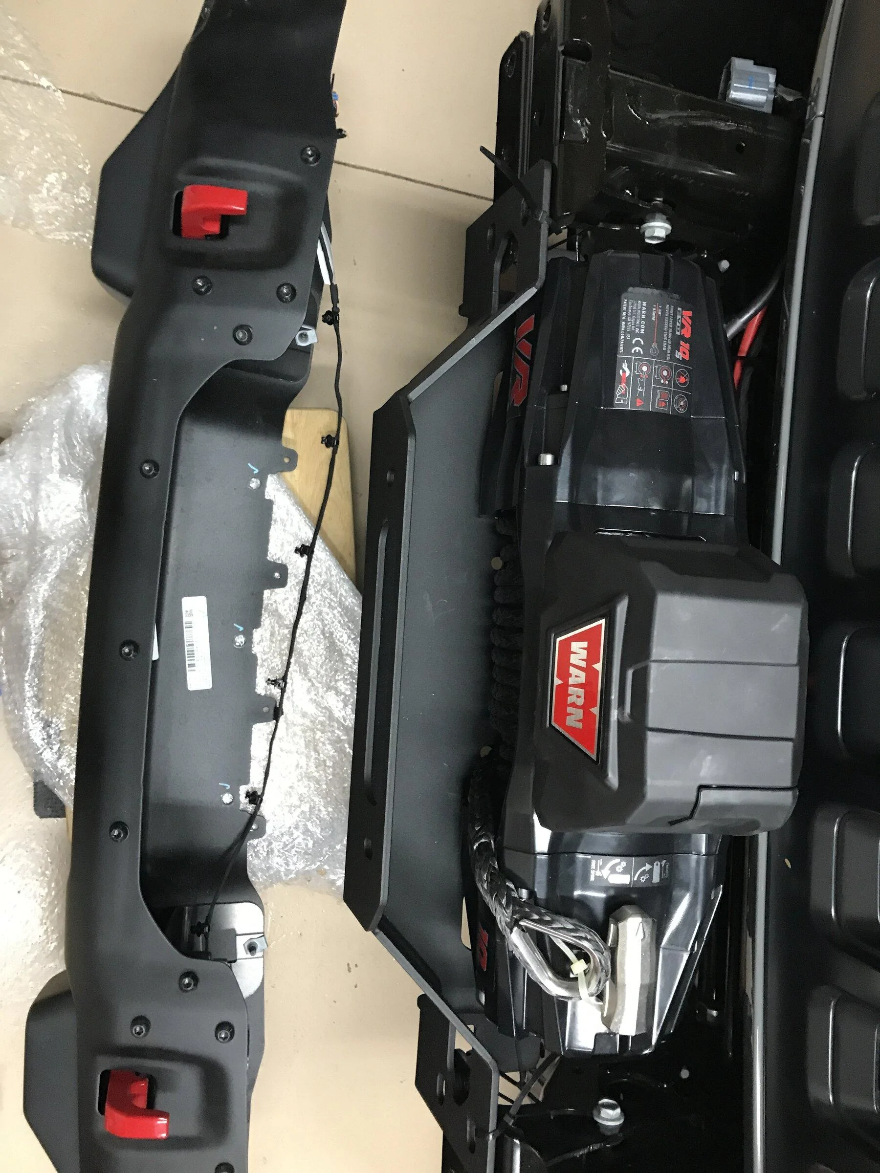

I have a 2021 mojave. I installed the warn winch plate and mopar steel bumper and installed Badlands Apex 12k winch . My dumb question is , there isnt but about a 1/4 inch or so of clearance between the front of the winch plate and inside of the steel bumper . What ate you using to bolt fairlead to bumper and not be hitting winch plate . If any of that made sense .

I think I understand your question. I had to find custom bolts that were long enough to go through all three . Don’t ask how I did it but I was able to slide a few fender washers between the bumper and winch plate. PITA. Hope this helps. Good luck.

Cool . So put the longer bolts through the fairlead through bumper and winch plate ? Has anyone done this, looks like i couldnt get to the nuts to tighten them because the winch is there . Thanks for the suggestions

Yes. Luckily, I hadn't bolted my winch in yet, so I took it back out to tighten the bolts. You might have to do the same to get them torqued properly.

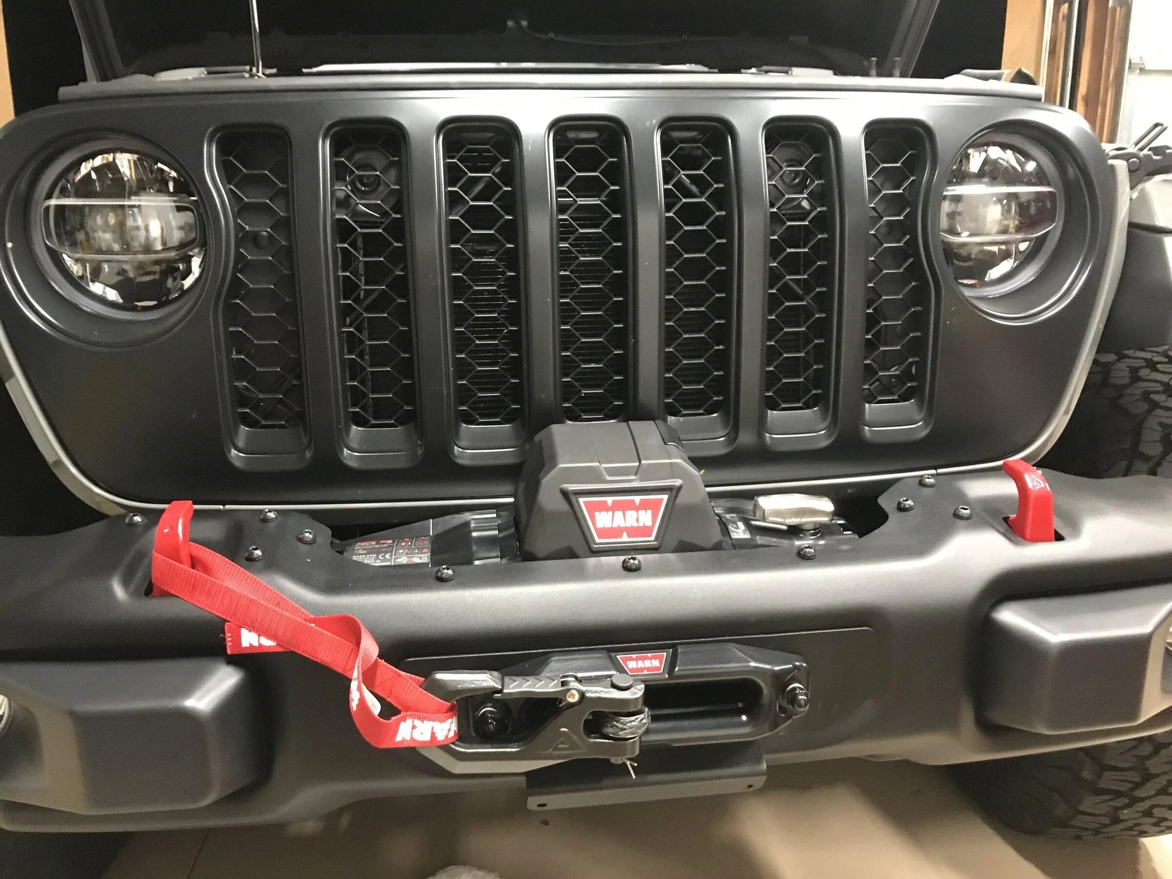

I just remembered. I fed the bolts from the back and used black anodized acorn nuts.

Look like a great install. I had a Warn on my 73 CJ-5 in the 70s and 80s and never had problem.
Ok , that is what I did wrong . I see that now. Thanks for your help
