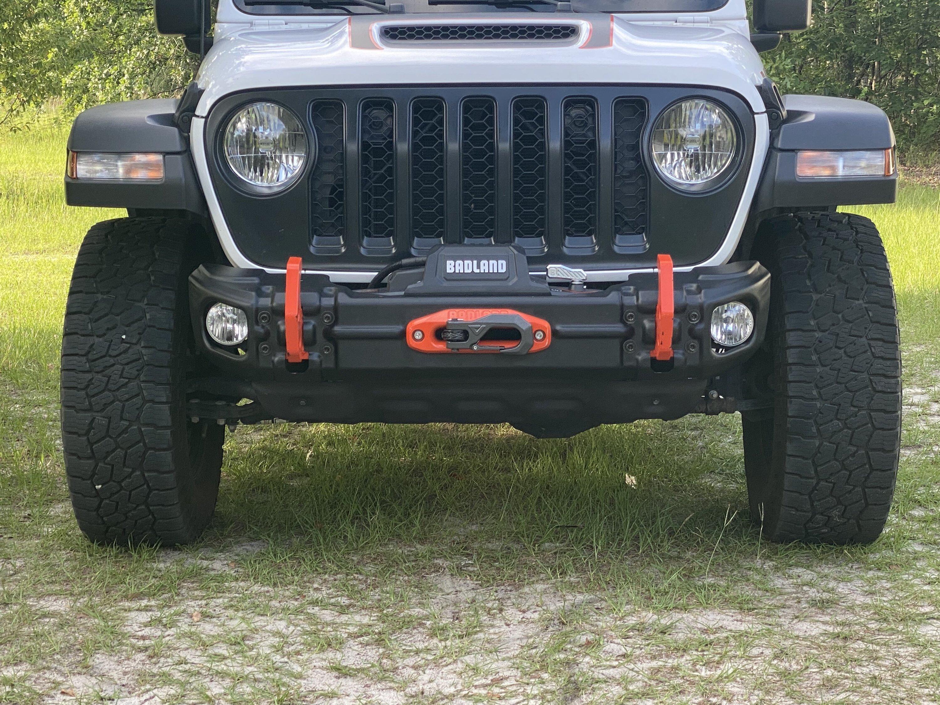

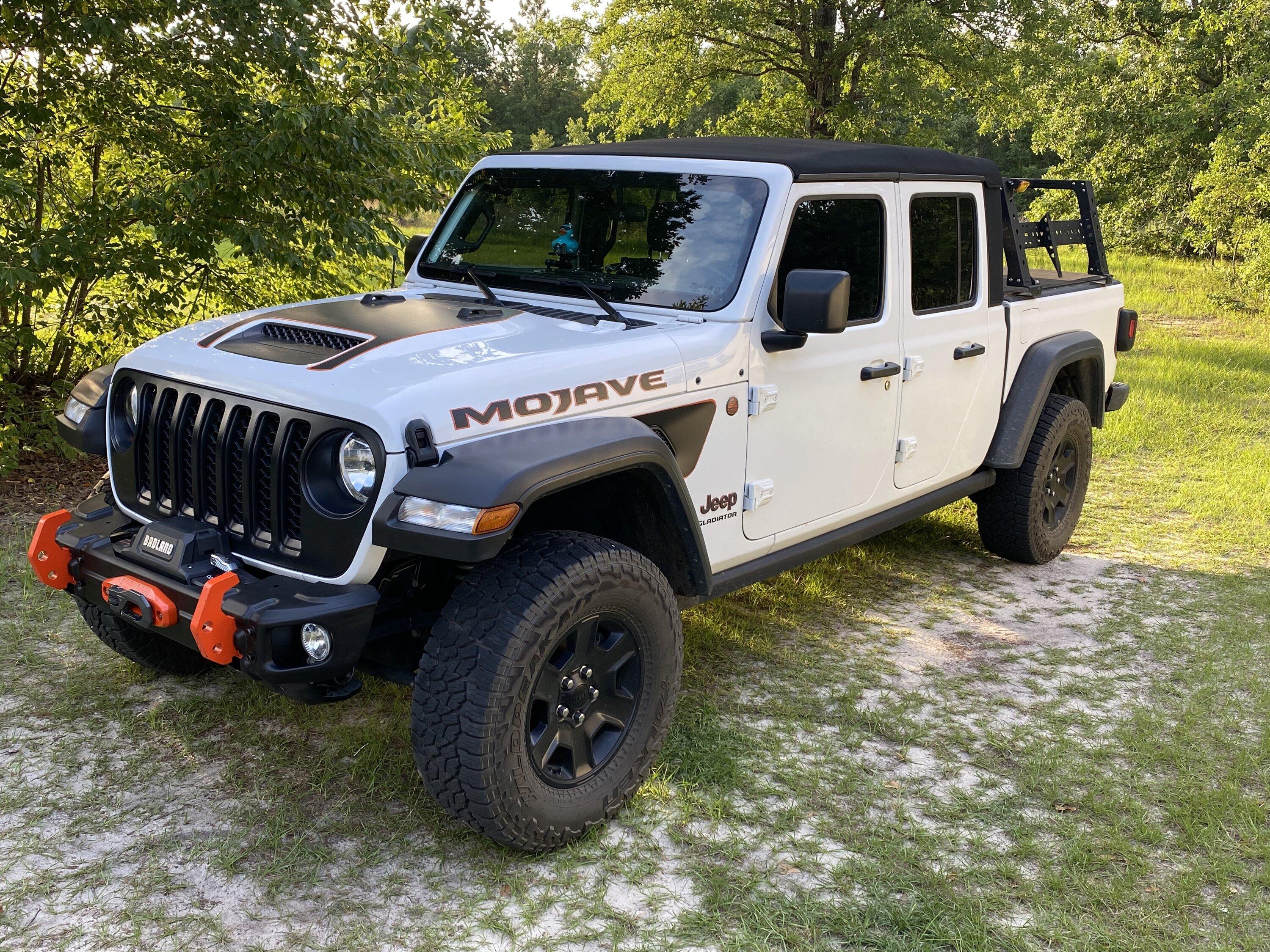

I do not have a Warn, I went with Harbor Freight winch...and the Arcus. Love the Arcus, very happy with the final product/look, but don't try to install it alone, you need help getting everything to line up.
Did you have any issue with the Mojave skid or LED lights when installing the Arcus?
Florida Mojave
Paul
Jan 23, 2021
363
557
Florida
2021 JT Mojave
I did not have any issues with either - I painted the skid flat black before I reinstalled; the fogs are stock, worst part about those was getting the wiring off the stock bumper…Arcus has adapter brackets for the fogs.

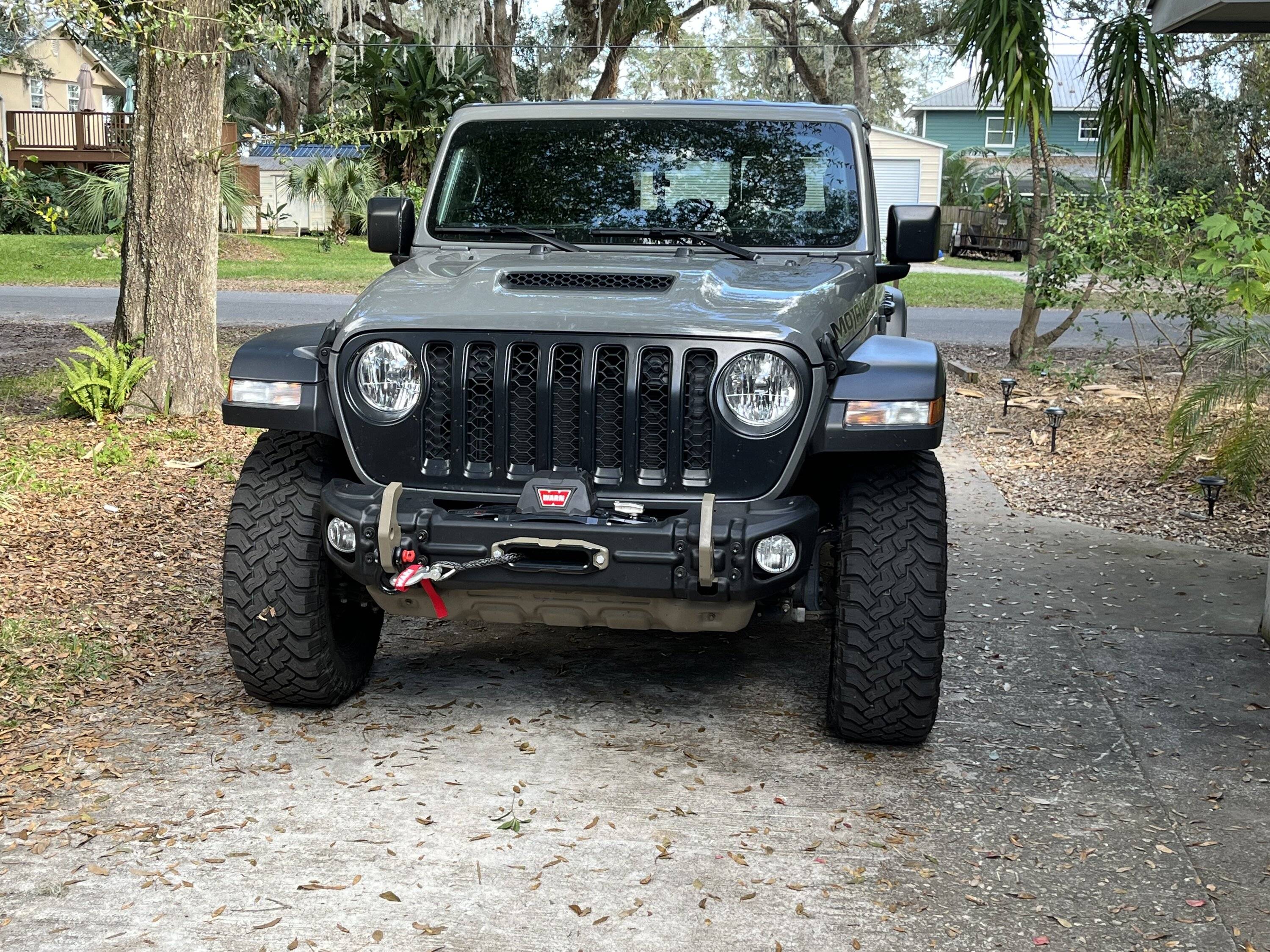

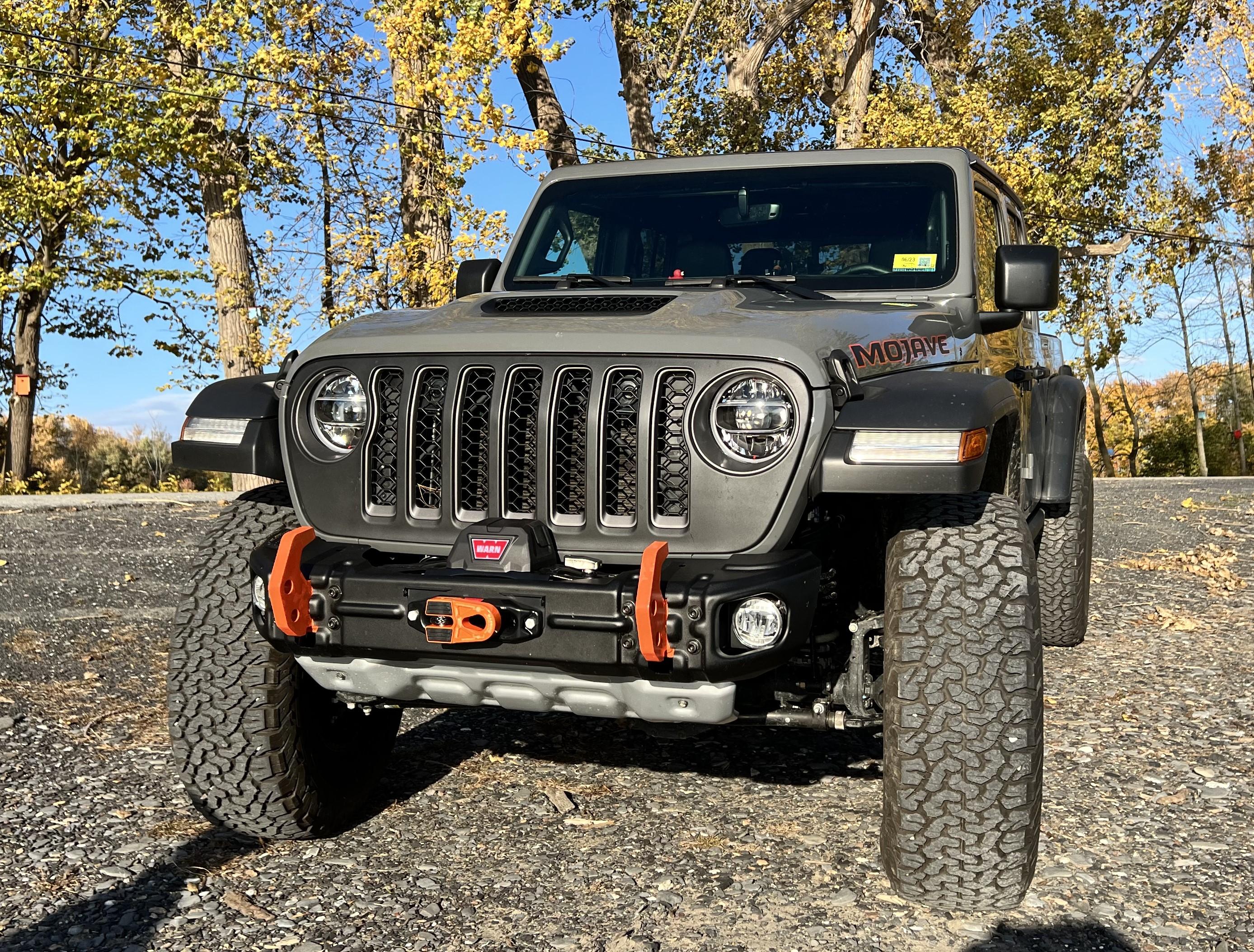

picked up the RR arcus bumper for my stock Mojave a few months ago and really dig it. Easy install and works with no mods to the Mojave front skid. Only added about 24 lbs up front as the stock plastic with hooks weighs around 38 lbs. Then I added a warn evo 10s and lost 3/4“ up front and you can definitely feel it on the Mojave (Braking & ride). I drove with the winch for a week and took it off for now. I need to figure out if I’m going to try teraflex 2.5 dual rate springs or skyjacker 2” dual rates for the Mojave to compensate for the front sag. Not a fan of spacers so it’s new springs that keep the shocks in their range or sell the winch and limit recovery to boards and rope/strap. Mojave handles extra case of beer easily in case I need to get winched out.
Jeep Gladiator 2022 Mojave bumper and winch question D67745C2-095E-4554-813D-481625281498
Jeep Gladiator 2022 Mojave bumper and winch question 5DD49B7F-D7EF-4EE0-8FEE-E80D0F1B505A

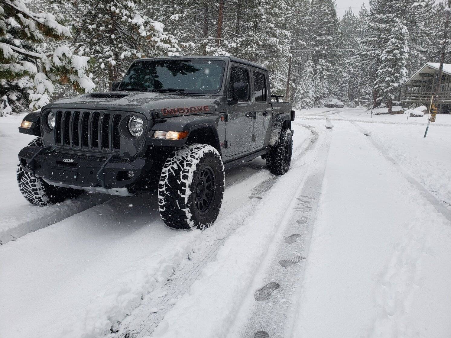

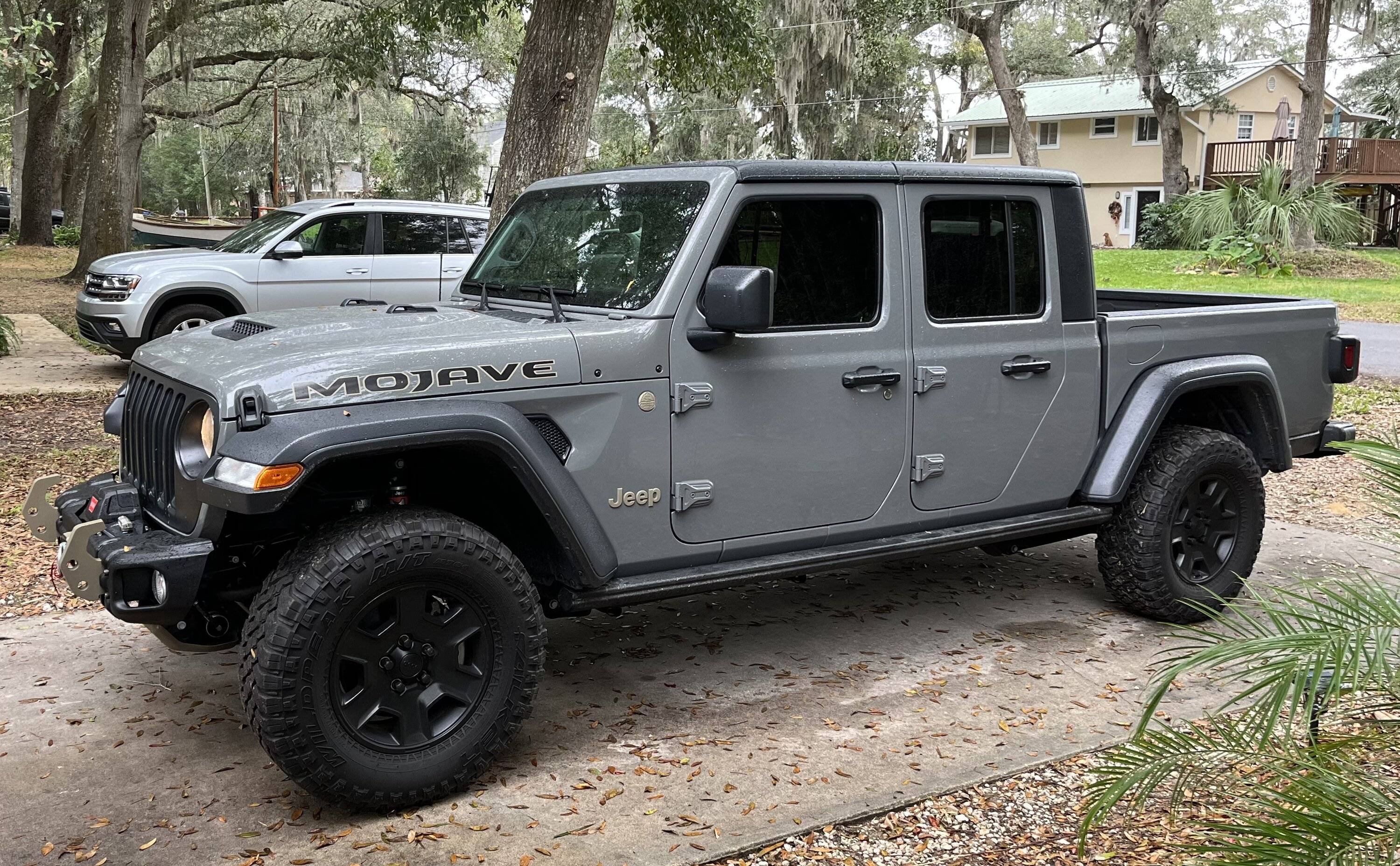

I went with the LOD Black Ops, in part to be able to flat tow. I had issues with the stock skid plate, factory fog lights, and mostly their service working through the issues. I have a Harbor Freight Apex 12 that I am debating whether to install or just bring the 12 pack of beer to get winch support. I like the look of the LOD but
Jeep Gladiator 2022 Mojave bumper and winch question Mojave snow
would probably go rock hard aluminum or even Smittybilt if I were starting over...
