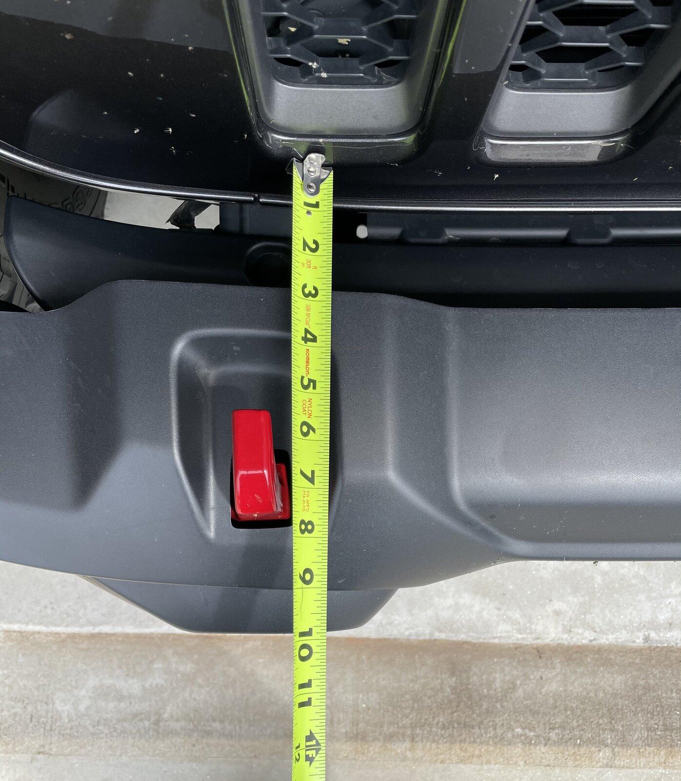

I’m considering this bumper however space in my garage is pretty tight. Would someone mind measuring the distance from the grill to the farthest point forward on the Bondi? The factory plastic bumper appears to be around 10.5” deep (don’t go by my camera angle ?).

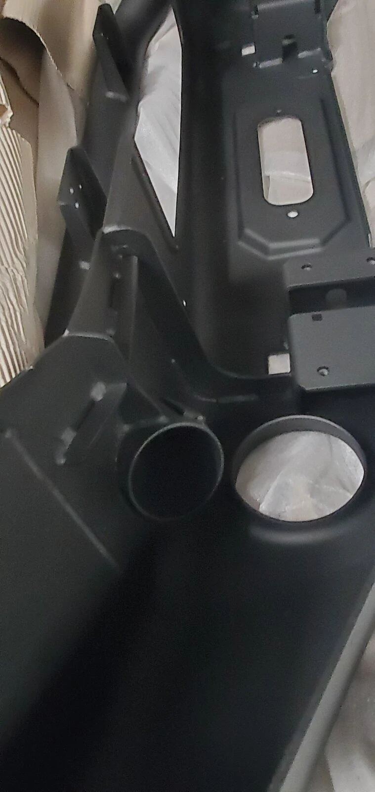

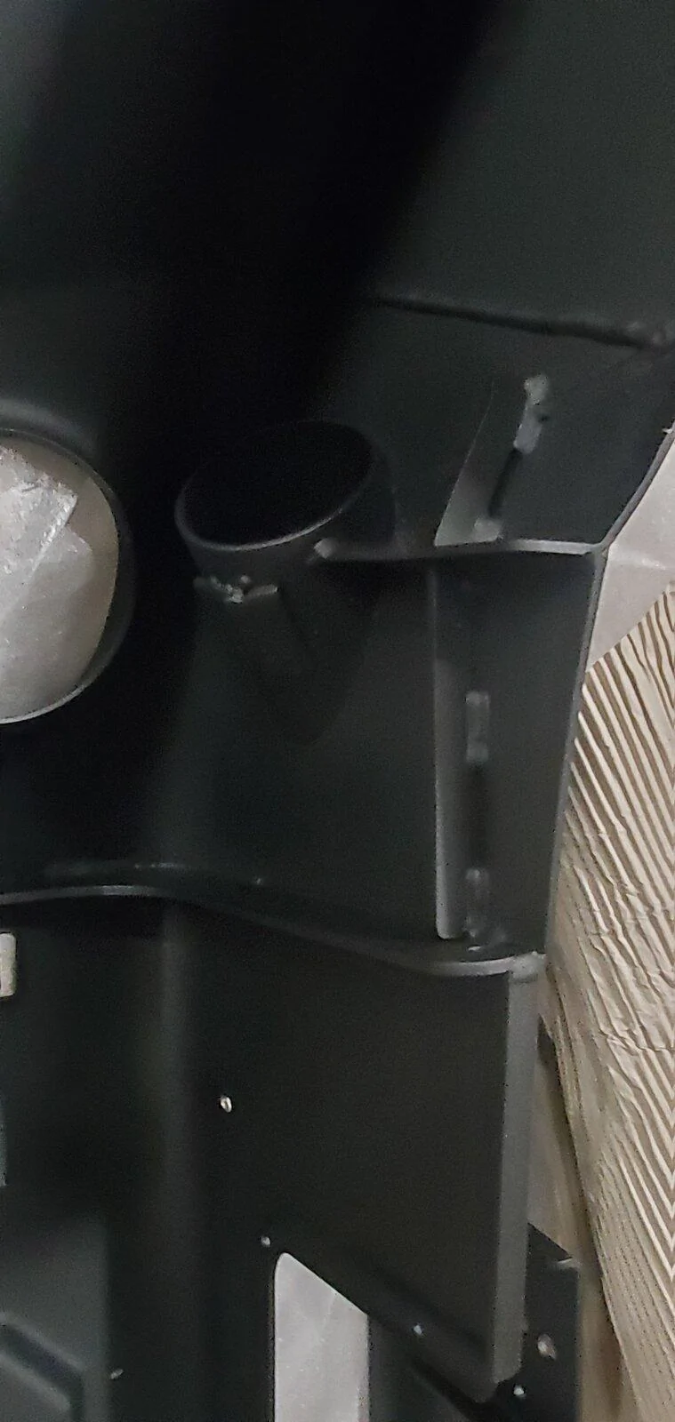

Thanks again for the build info - my Bondi Deluxe finally arrived and I am sending it out for Rhino Lining on the outward surfaces. I don't rock crawl so I'm not worried about hanging up and sticking from a rock. I'm more worried about corrosion from ordinary woodland abrasions and our annual salt bath up here in Minnesota. I have to say this thing is BEEFY - and I love how they pulled the tube through the bumper. Hope to have this on over Labor Day weekend - got my winch (SB 10K X20 gen 2 synthetic) and my DD SS3 Pros in yellow. That's going to take some work I suspect but I hope I got the right brackets. Also having my RH 4x4 angled down sliders rhino lined at the same place. Those will go on after I'm done with the bumper.

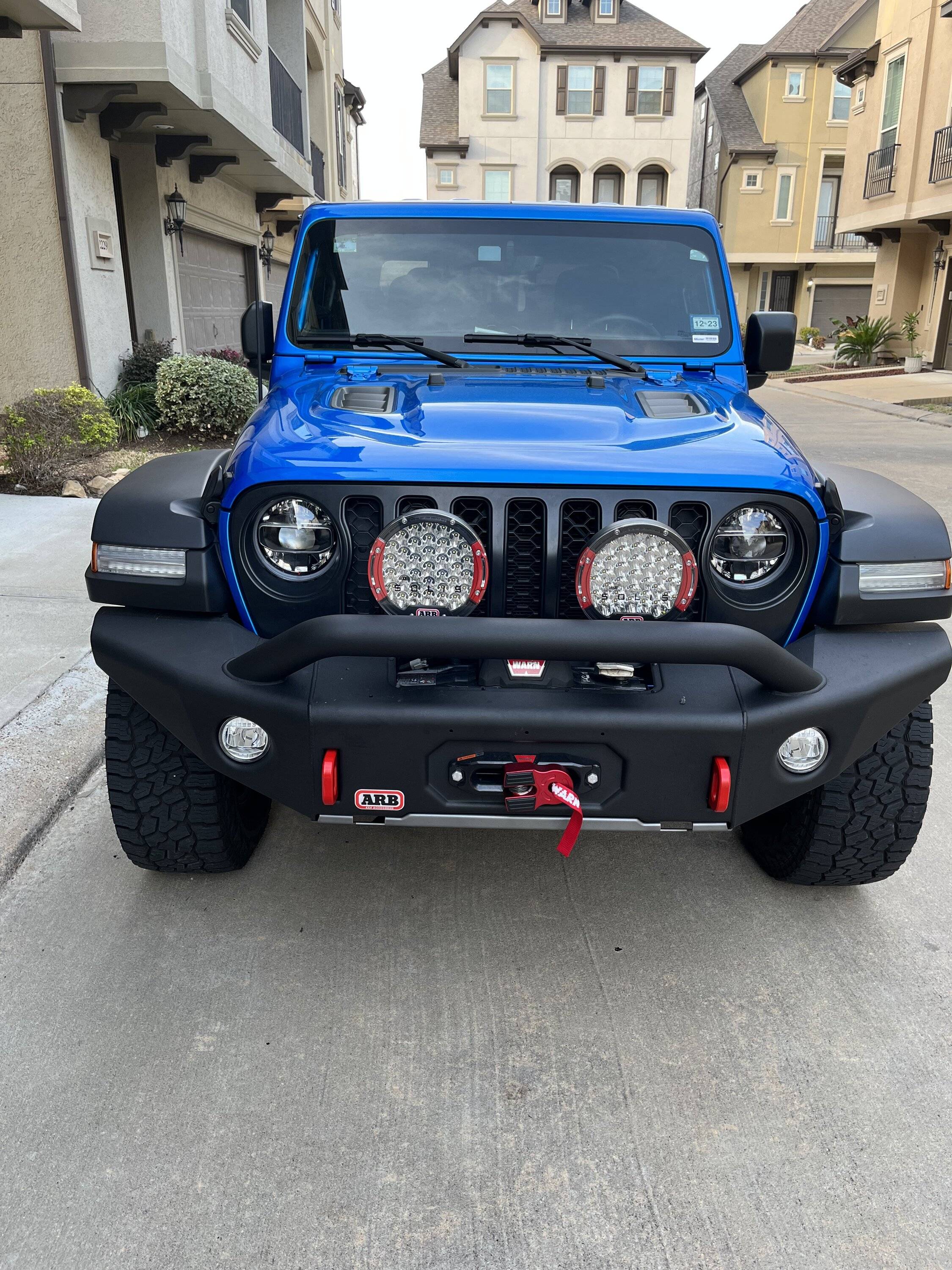

Got it setup with the arb lights.
Jeep Gladiator ARB Bondi Deluxe Bumper Install 0C16E49E-77E4-4707-B21F-4D82CEE6D9E9
