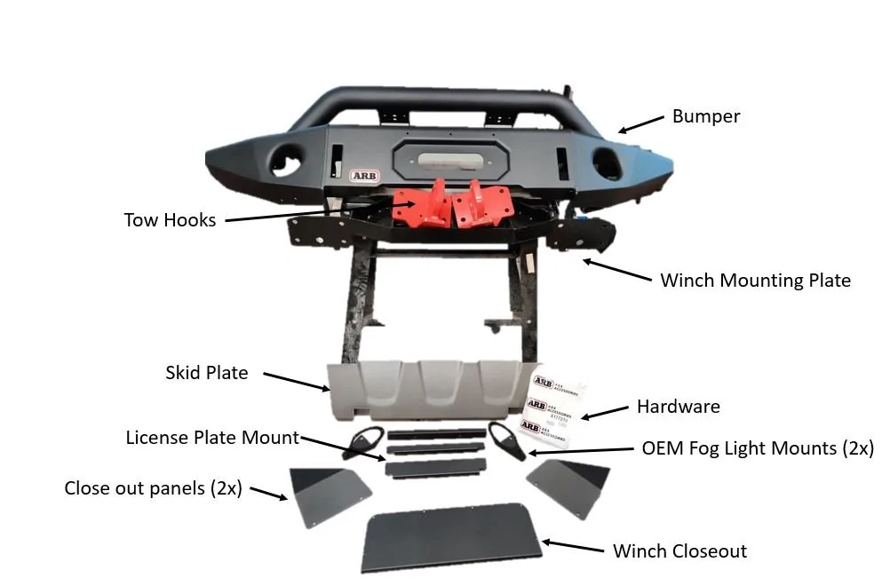

What is included in the box?
Jeep Gladiator ARB Bondi Deluxe Bumper Installation - First Impressions 1

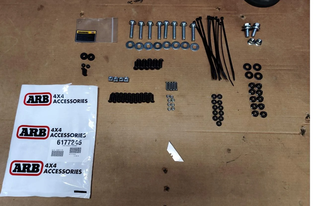

Hardware bag contents:
Jeep Gladiator ARB Bondi Deluxe Bumper Installation - First Impressions 2
I would later learn there were not enough cage nuts included – needed 10 only received 4.

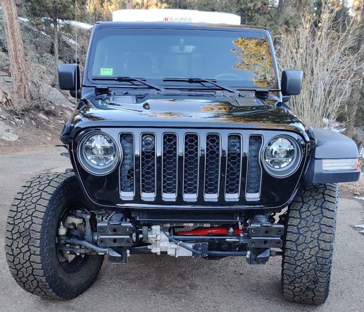

I picked the Jeep up from a collision shop without the bumper or damaged fender flare by working a deal with them on doing upgrades vs. replacing with OEM parts – so my starting point was a bit different than most will encounter.
Jeep Gladiator ARB Bondi Deluxe Bumper Installation - First Impressions Capture.JPG
Note: In addition to the bumper I am chopping and installing the QUAKE DRL kit – so the following pictures intentionally show OEM LED with the bumper and the @QUAK DRL mod (@Mr Black ) – I wanted to see them side by side and personally prefer the chopped look!

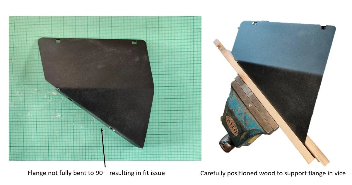

1. The first issue encountered were the hang tabs on the winch mounting tray:
Jeep Gladiator ARB Bondi Deluxe Bumper Installation - First Impressions 4
Using a block of wood and a hammer I gently manipulated the hang tabs back to 90 degrees resulting in the holes lining up on both sides.
*do not tighten the bolt in the image until the bumper is in place it makes lining everything up easier!

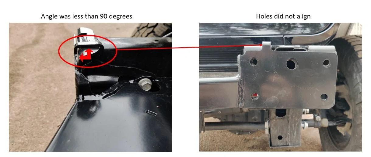

2. The next issue I encountered was the bumper close out panels, bent sheet metal with cage nut holes on two flanges, the RH side lined up perfectly but the LH side holes did not match the bumper holes. I was also missing the complete number of cage nuts required. After careful inspection of the two panels the discrepant component was not bent to the same final angle as the one that fit well. I remedied this by clamping the flange between some wooden blocks in a vice and gently bent the flange maybe ~1degree more – it then lined up perfectly.

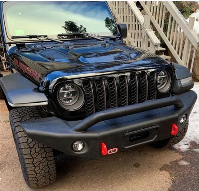

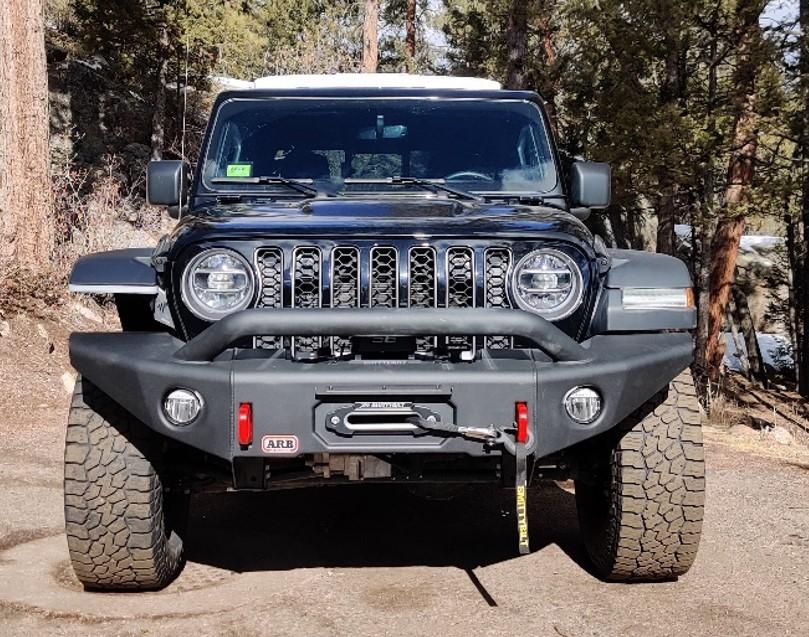

I made an update to the original post with the missing weight of the tow hooks and the final math on the weight. Sorry for the delay I decided to just do a winch at the same time. Writeup on that coming but I went with a Smittybilt XRC Gen3 Comp/Synthetic line winch. *I chose this winch because ARB indicates frame flange notching is required for WARN zeon winches... more on that in the coming winch write up!
Adding some final pictures and thoughts here:

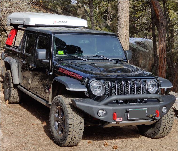

1. ARB Bondi Deluxe with passenger side QUAKE DRL/Fender Chop showing comparison to Driver Side OEM Rubicon LED flare:

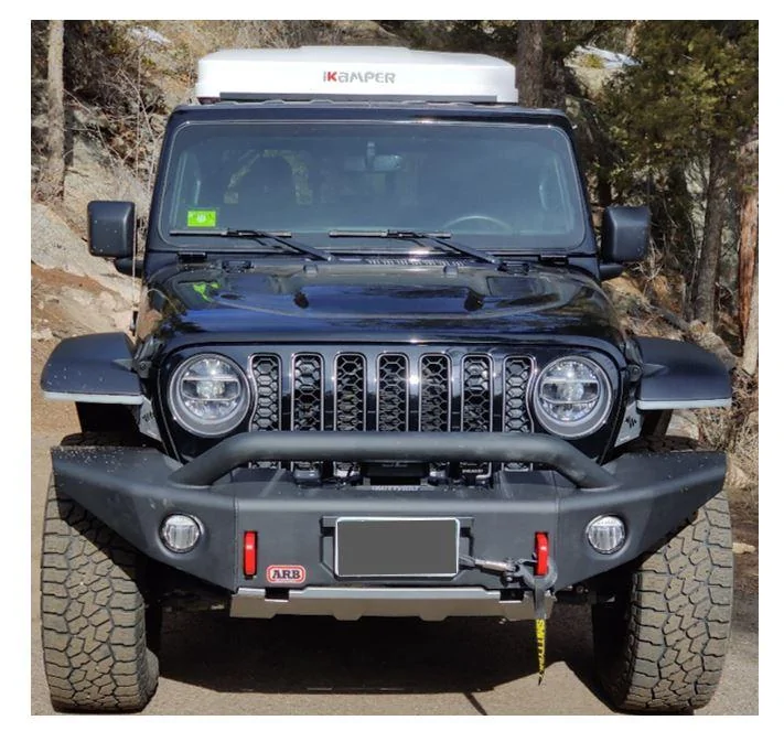

2. Complete front end after QUAKE DRL/Fender Chop both side
Final thoughts:
1. The overall quality and finish of this bumper does not disappoint!
2. I did have some trouble lining up the mounting hardware but help from a friend and patience resulted in everything lining up.

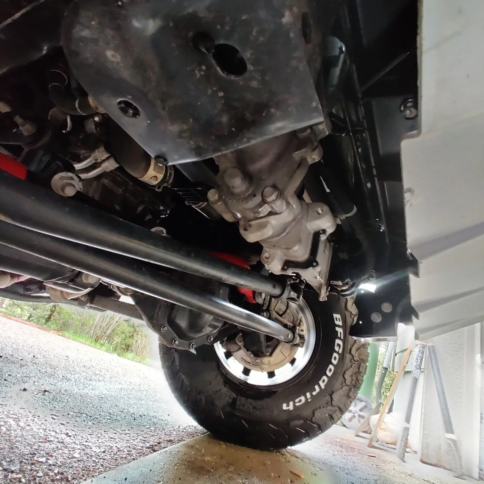

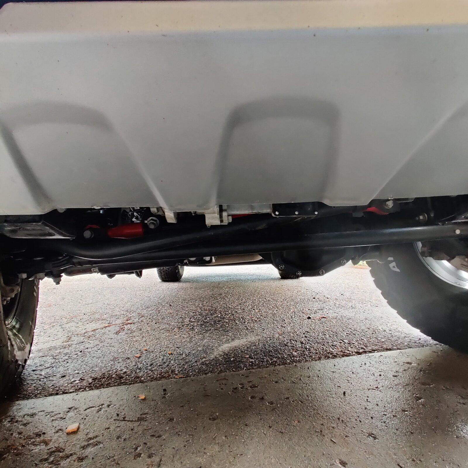

3. The ARB skid plate does not come back as far as the OE skid plate and as such the Rubicon electronic sway bar disconnect motor is uncovered but above the plane of the skid plate so you would have to roll over a large rock for impact to occur.
4. Some hardware was missing from the ARB parts kit (M6 cage nuts) I ordered these from Amazon so no issue there.
5. The Smittybilt XRC Gen 3 9.5k winch fits with no modifications required to jeep or bumper
Overall I am very happy with this bumper and would recommend it to anyone who is considering it.

Thanks for your write up. This is the exact combination bumper-winch combo I've settled on.
I am a little concerned about the skid plate. Do you feel it's sufficient to protect the electronic sway bar disconnect?

I can snap some pictures for you. It is not exactly full coverage but I have not had any issues yet and have taken it on some rough terrain (elephant hill) while I still had 33s that skid has yet to be used. The underbelly ones however have been put to use!
