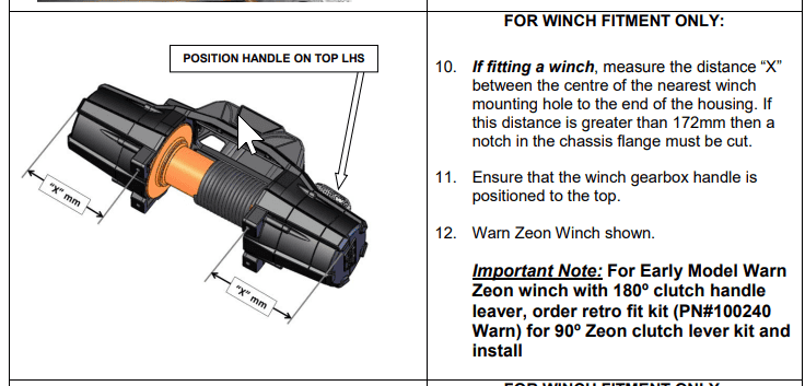

The install PDF has a whole section on winch fitment.
Most notable is this part:
Jeep Gladiator Can I get/need a straight answer arb bondi deluxe front bumper? 1713824938995-b2
Compare the specs of the winches you're interested in installing.
