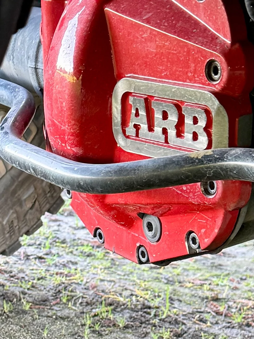

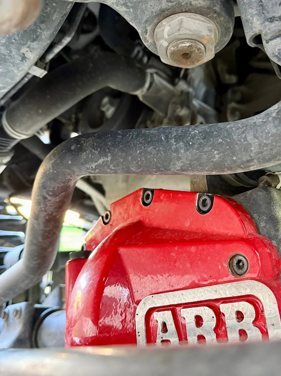

Hi Rodney,
I have a 2021 JTR with a 2 1/2” Clayton Overland+ lift. The front sway bar is a non issue as it is located well away from the ARB cover. The front trackbar (Clayton) has about a 1/2” minimum clearence at full flex. The rear swaybar did hit the ARB cover at full droop on the passenger side of the cover. I ground off a portion of the cover to clearance this area. If I had known about the relocation spacers for the rear sway bar, I would have used them instead of grinding on the cover for clearance.

Hey, Thanks for taking the time to reply. I did the online chat thing with quadratech and they said that I'll definitely have issues if I add the front cover to a stock suspension. They said that at full compression when the suspension bottoms out that it would hit the top of the cover. My truck bottoms out on occasion if Im not careful because the diesel engine is so heavy.
So now I need to figure out a way to get around the sway bar hitting the cover short of doing a 2" lift. Thanks for including the info about the rear swaybar as well. I haven't had any problems yet here at home but would for sure once I go out West to the desert.
