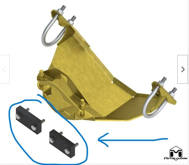

I've heard in the past that some trackbars dont work with ARB diff covers and make contact, any idea if the Clayton kit works? Hoping to add these ARB diff covers during my regear but dont want to have problems.

There should be some offset blocks offered by ARB. If not you can pick up some from Metalcloak. They come with the diff skid plate but you can also purchase separately.

I'm unfamilar with this, what is the offset block? What is it offsetting? Is this for the track bar or the diff cover?

Moves the trackbar away from the axle for track bar clearance.
