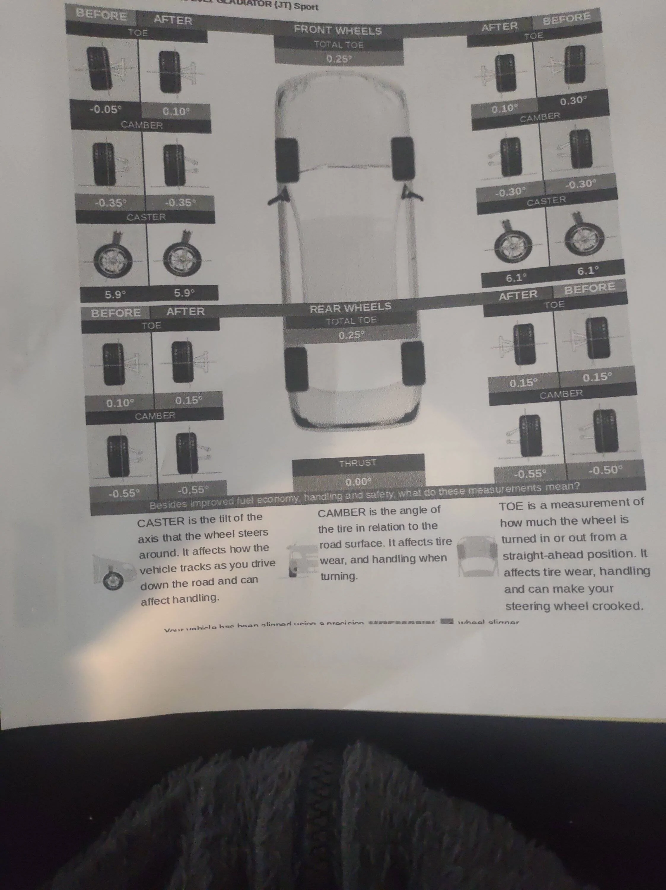

I'm still struggling with the same thing. I just had it aligned. Less that 10 miles on current alignment. Everything has been torqued. Tires balanced again. Next try is the Metalcloak sector shaft brace. Lots of good reviews on their setup.

nope, a brace will not solve it. The jam nuts all need to be torqued to a pretty hgh level. Also, when the kit was installed it should have been hand tightened then placed on solid ground then final torqued. I have noticed aftermarket track bars like to be torqued to 135 ft. lbs. The stock bolts should be ok. Any shimmy is typically a result of the forces not properly being transferred to where they were designed to go, this is typically rooted in something not having enough torque which results in not enough friction holding the joint together.
