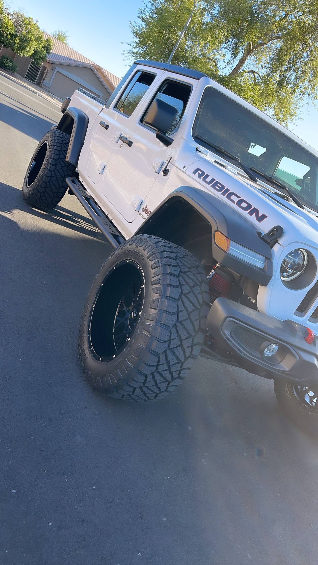

just placed my order for MetalCloaks 3.5” true dual rate kit with their drive shaft, thanks for everyone input!

Just installed the lift, couldnt be happier with metalcloak
Stance looks nice, glad you are happy.
On a side note, I could care less if I get flamed, the people responding in this thread are useless. I’m sorry, I had to say it. Why? Because I’m on a 4.5” lift with 37s and it looks/drives/wheels just fine. Also a diesel, no need for regearing, no need for chromoly axle shafts, no need for axle trusses, no need for driveshafts, none of that crap. Did the lift by myself on the garage floor with basic hand tools, no spring compressors, nothing. Never even took it in for alignment. Cost for everything was just under $2300. People seem to think that because it didn’t work out for one person that it won’t work out for everyone. Sheesh ?
/rant
