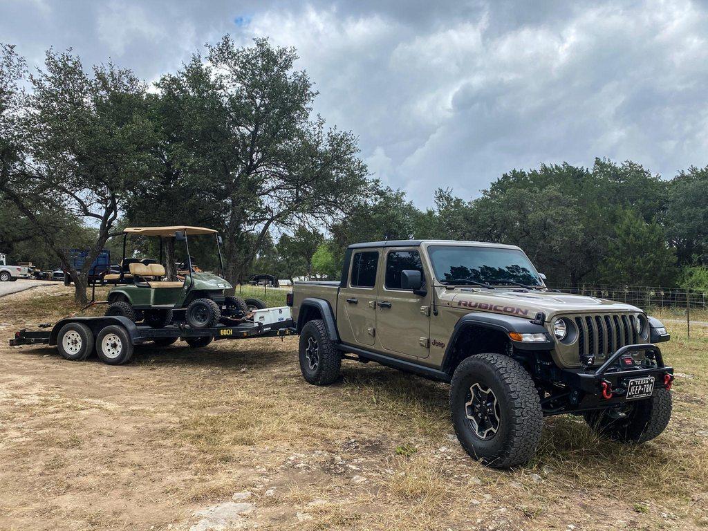

Mine...37x12.5x17, stock wheels. Stock wheels are fine.
Wheel spacers mean zip when it comes to a lift. They come into play when turning and its not needed. With 35s you don't need a lift unless you want one...so any size lift works. After that its budget and application.
Jeep Gladiator Lift or no lift? New wheels or are stock ones OK? C8A384F0-D238-4583-A68D-FF4AAEBF2651
