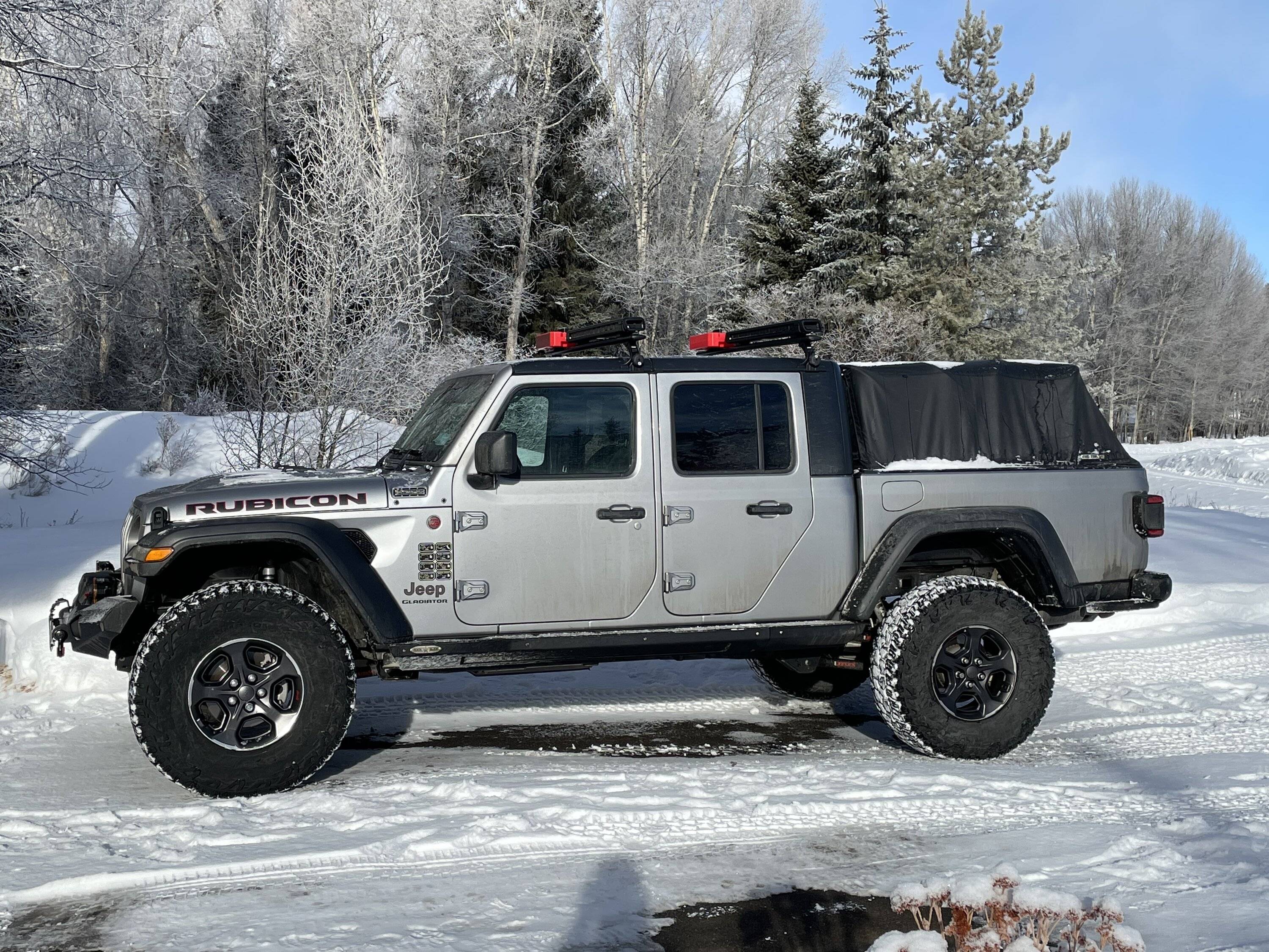

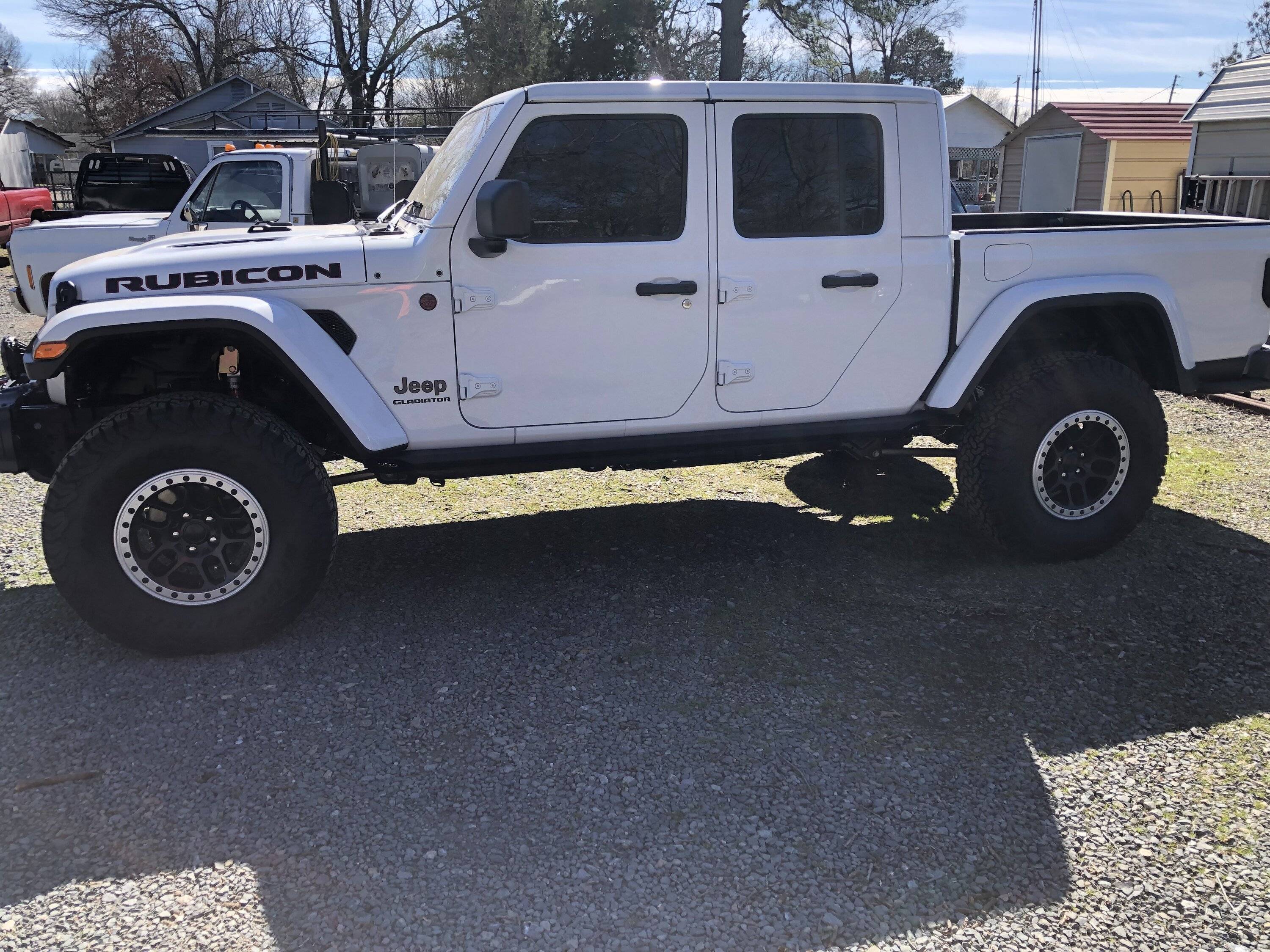

This was the day the lift was installed actually in the shop's parking lot:
She sits nice!! May just go with a 3” or 3.5” lift after seeing your pics
[/QUOTE]
This is mine on a 3” lift in front and maybe 4-4.5” in the rear. Different springs. These are 37x12.5” Mickey Thomsons. Tons of room for 38’s with no changes. Every one who’s said it already is right. No need for a lift that big, and you can’t use your stock shocks. Why would you want 22” wheels? If you plan to use this off road, you need more tire sidewall. 22’s are for parking lots in my opinion.

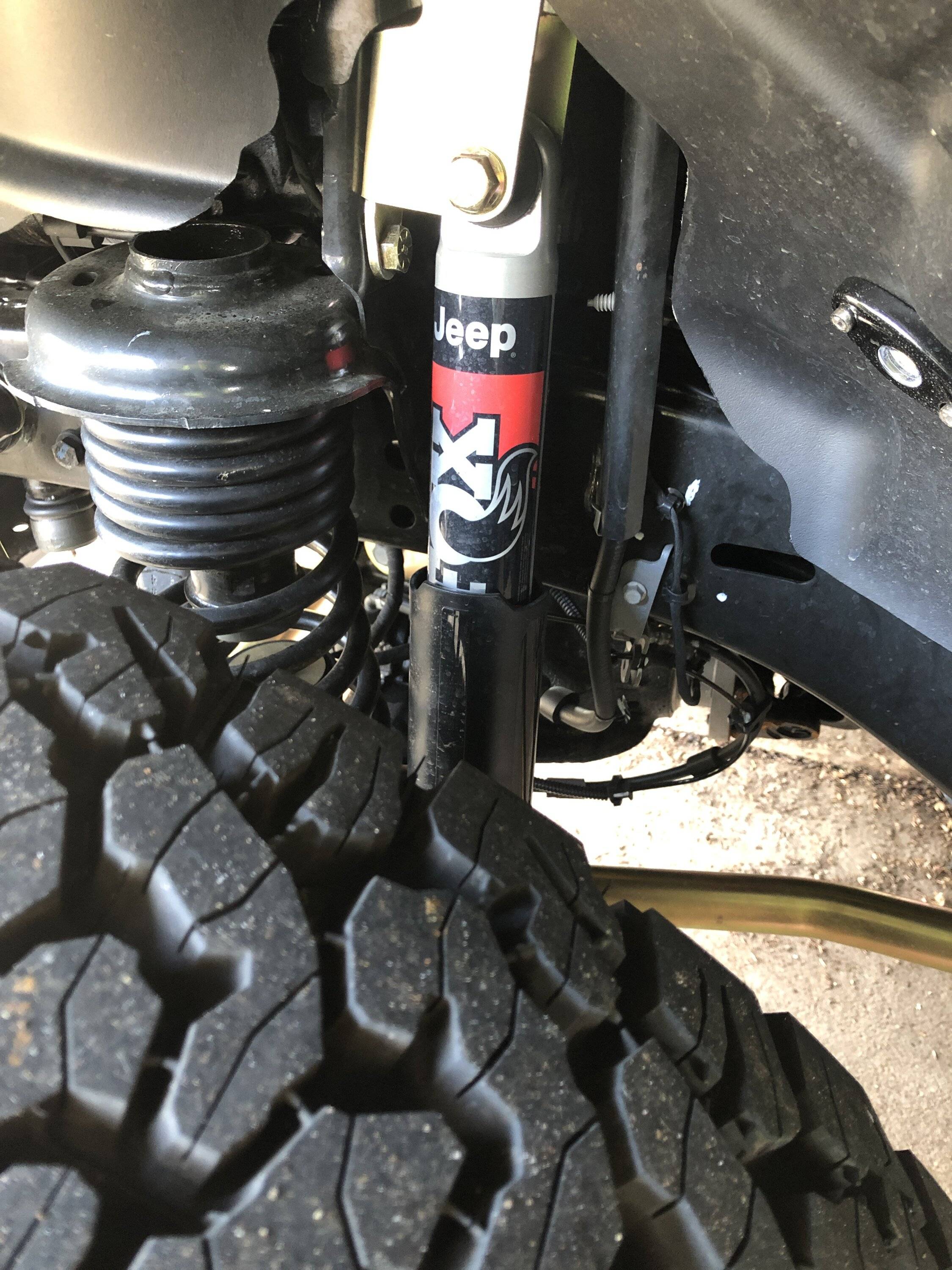

Also would you happen to know if this kit applies to the EcoD? I Know they are heavier so I want to make sure I get the right kit
Mine is an EcoD. Select engine when ordering.
Jeep Gladiator 4 or 4.5 lift kit W/stock fox shocks? F7A29EE1-A843-4863-9922-7A9405E1A17F

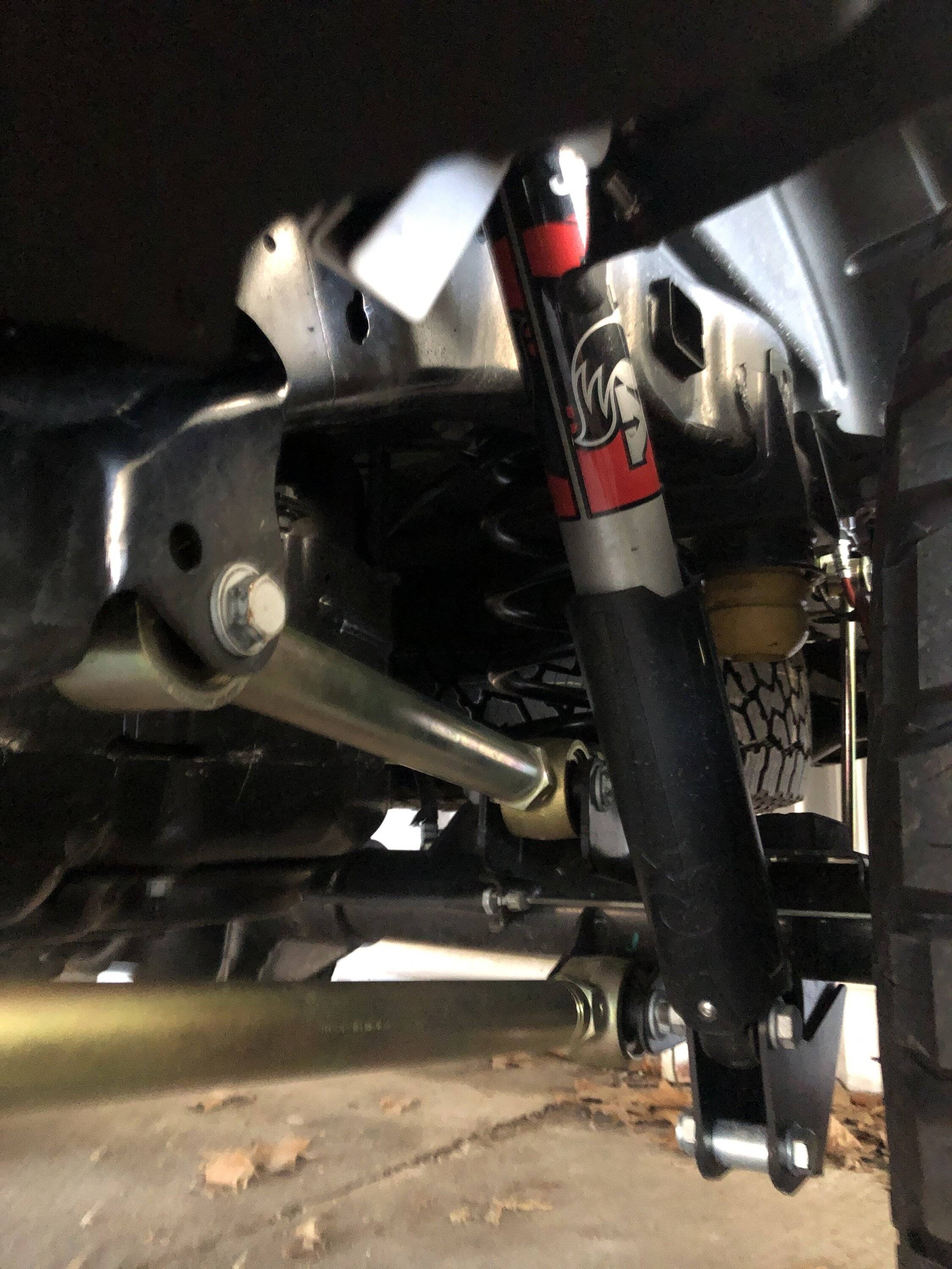

Jteakus
Teakus
Feb 19, 2022
1,865
3,423
Oil City, LA
Yes
Jeep Gladiator 4 or 4.5 lift kit W/stock fox shocks? image
